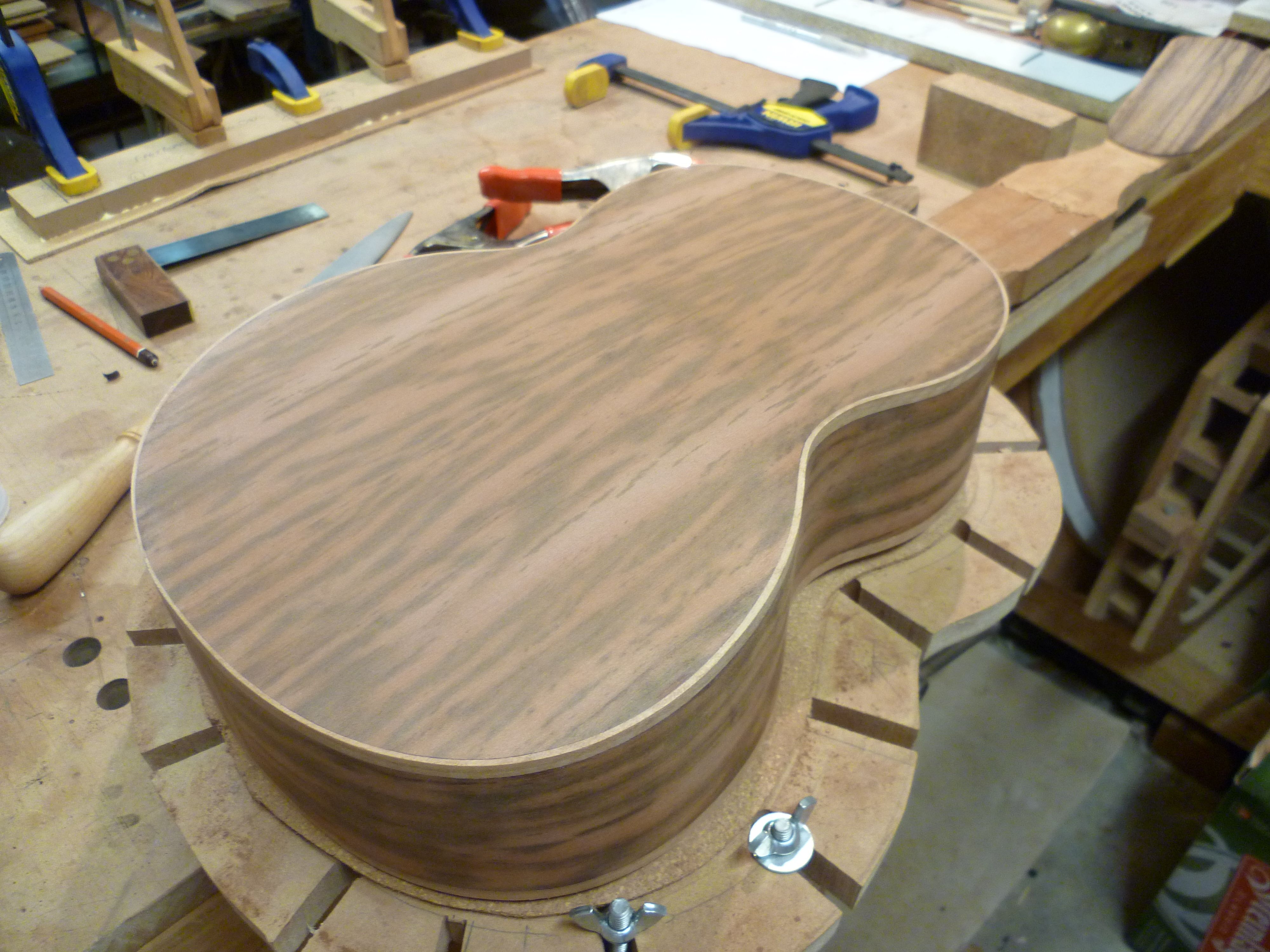

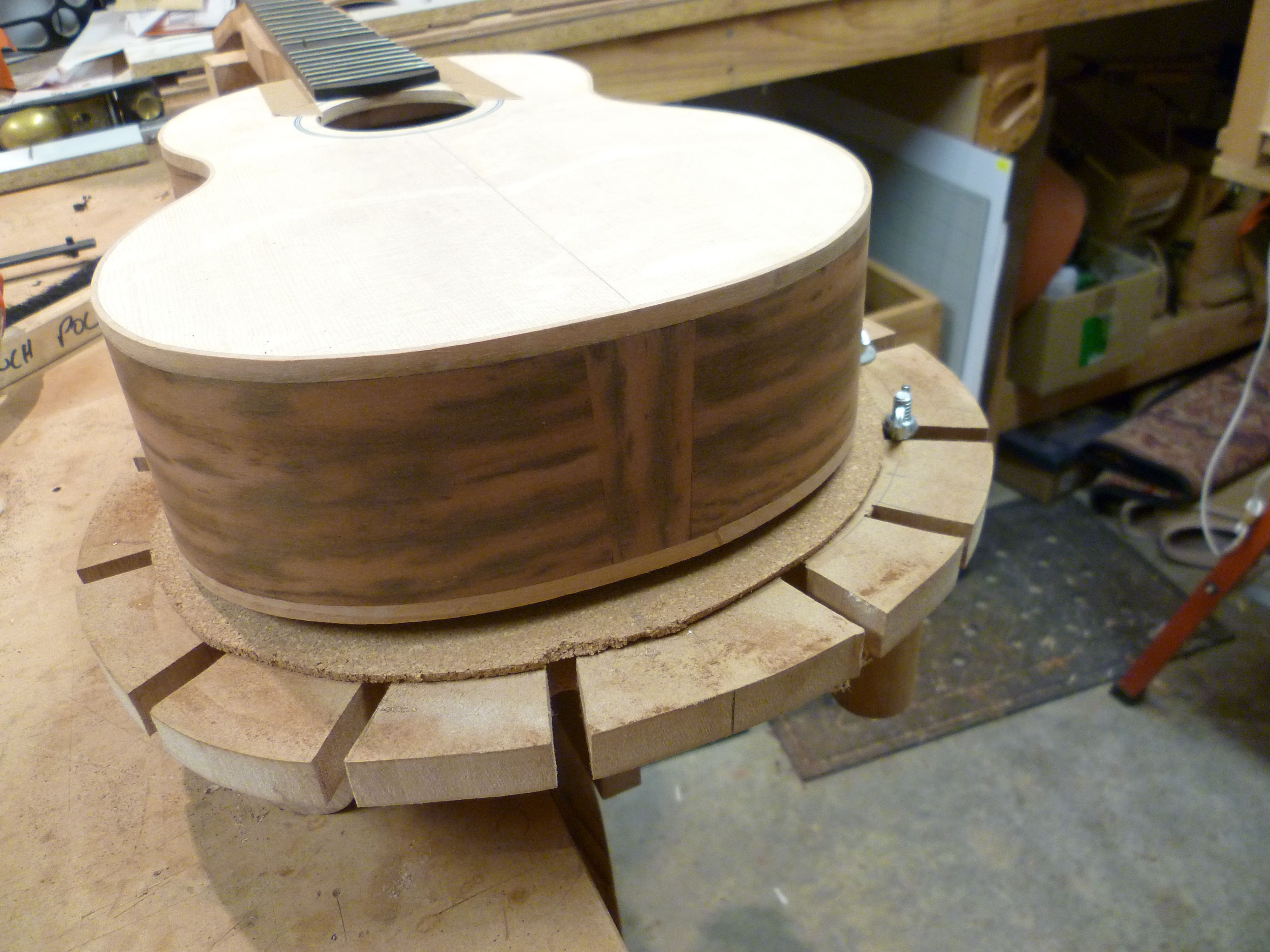

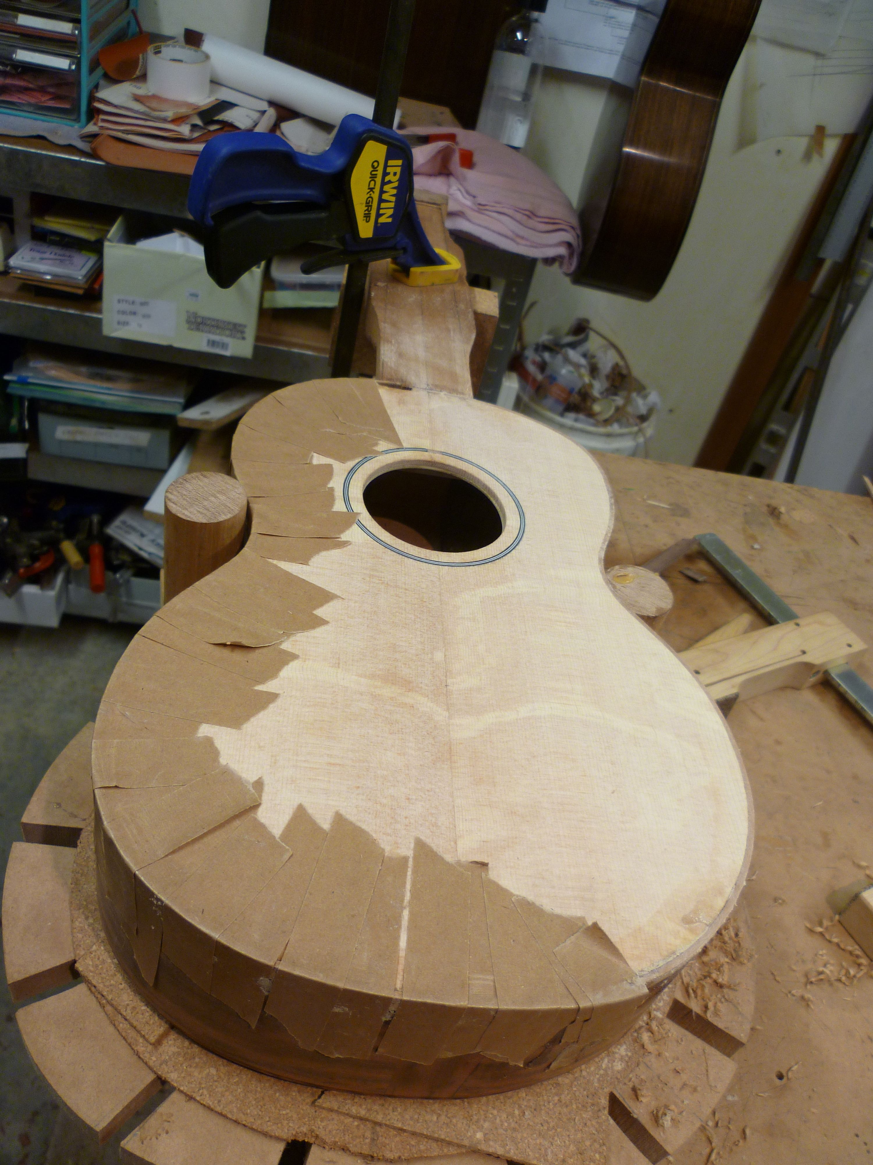

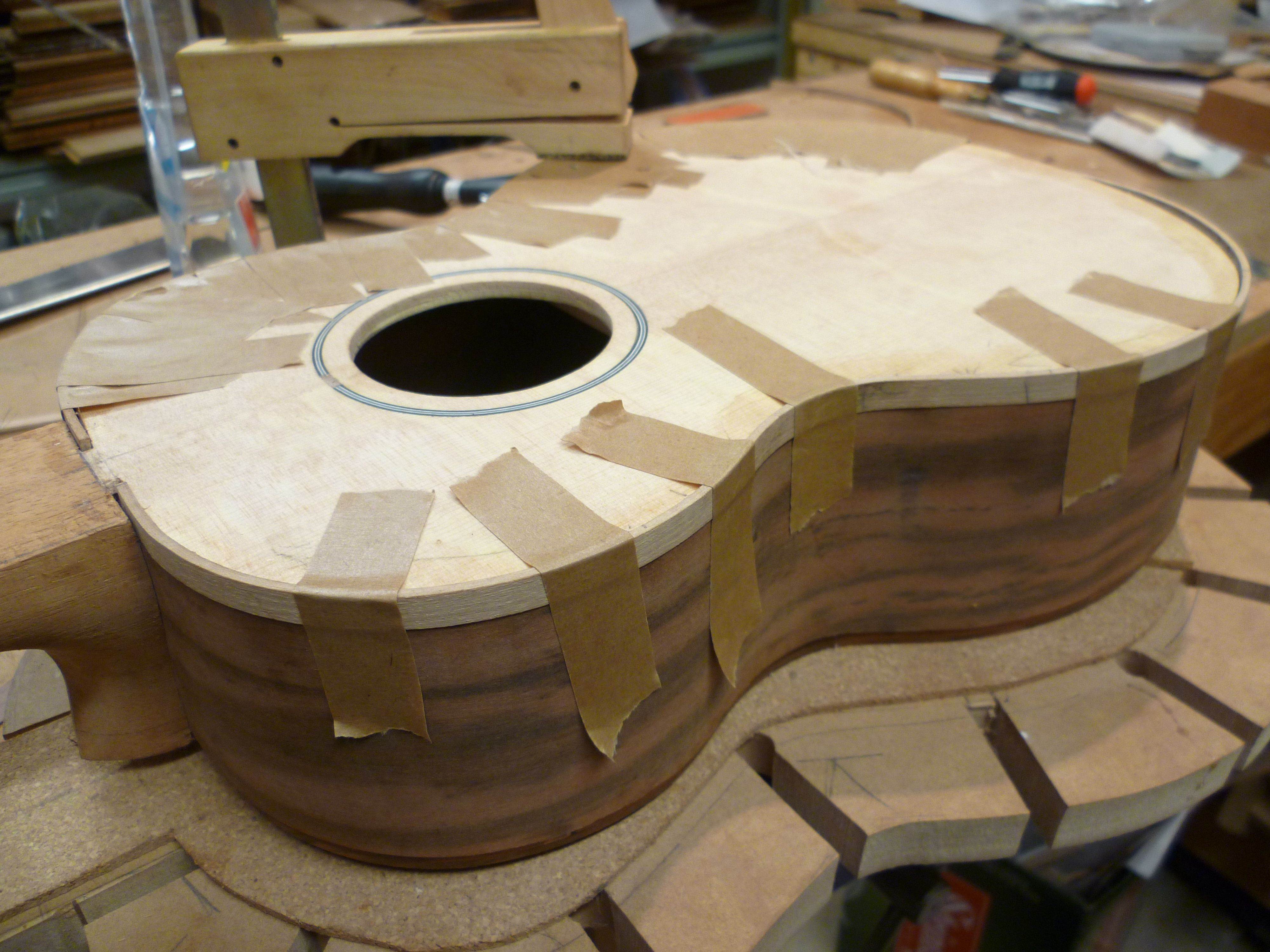

Post by kiwigeo » Fri Jan 27, 2012 8:45 pm

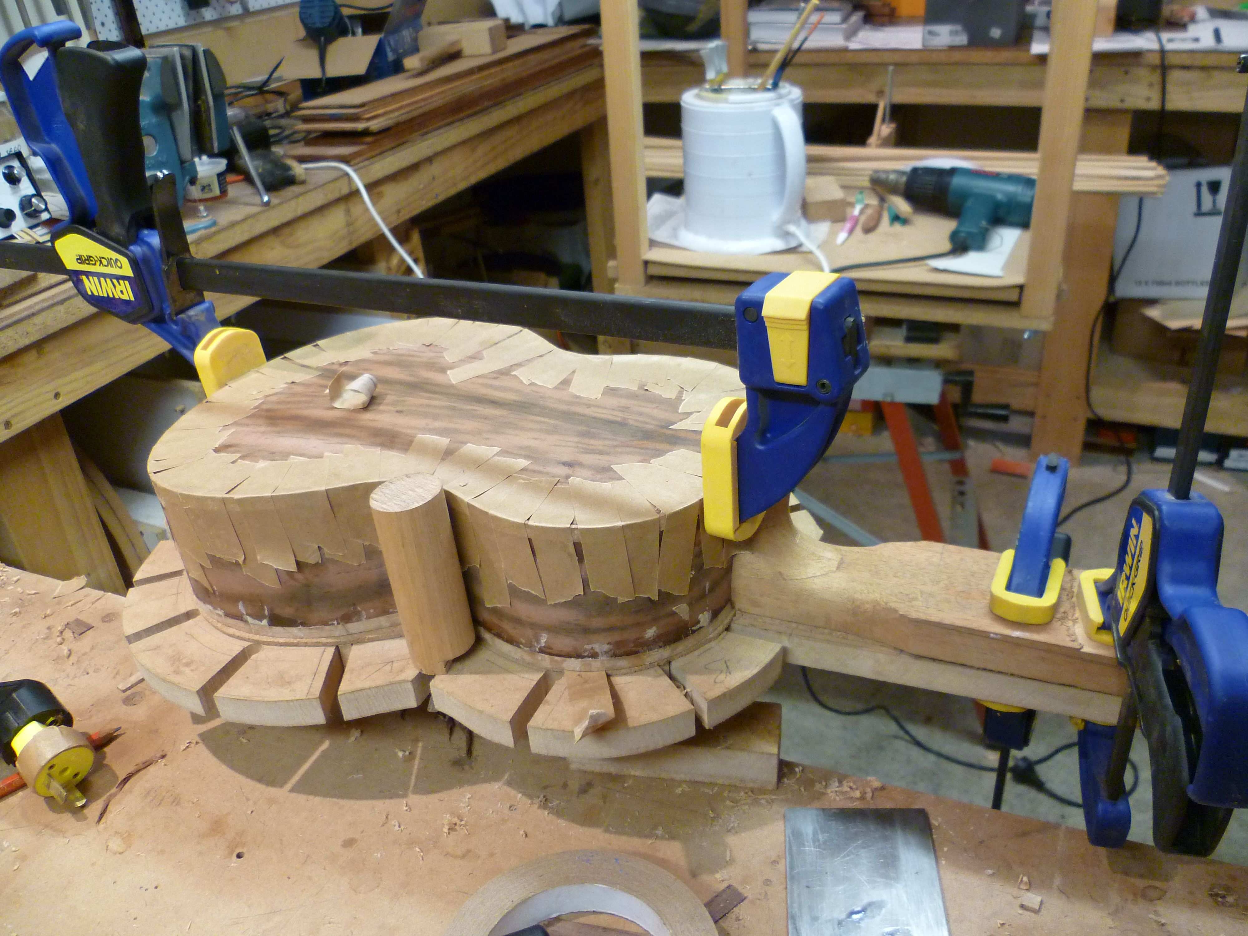

Managed to get the topside bindings done today......I'm old fashioned and stubborn so bindings were bent up on an iron which took ages. Hand bending binding and sides on a classical isn't a huge task but on a uke the curve radii are alot tighter. I usually use macrame rope to snug up bindings on my classicals but on the uke I opted for LMI binding tape. My secret weapon is the photographers sealing iron I bought for fitting the top on my lute. This tool is a must have IMHO.....great for heating up and retaping sections of binding that aren't quite snug in the routed channel. The binding I finally decided on...well I don't know exactly what the hell it is but I got it from Tim and it seems to go well with both the sitka top and the tiger myrtle back and sides. In hindsight I should have inserted some bwb purflings behind the binding on the top and back....when installing bare bindings the fit in the channel has to be perfect or gaps become obvious. Purfs give you a bit of leeway of binding fit isn't perfect.

It's coming along nicely, I'm looking forward to seeing it finished, tiger myrtle is one of the most striking timbers imho.
I also done the binding's on a tenor uke today and some purfling would have been very helpful, I've got some gaps you could lose your arm in, nothing a couple of sticks of wax won't hide ( I hope ).
Matt

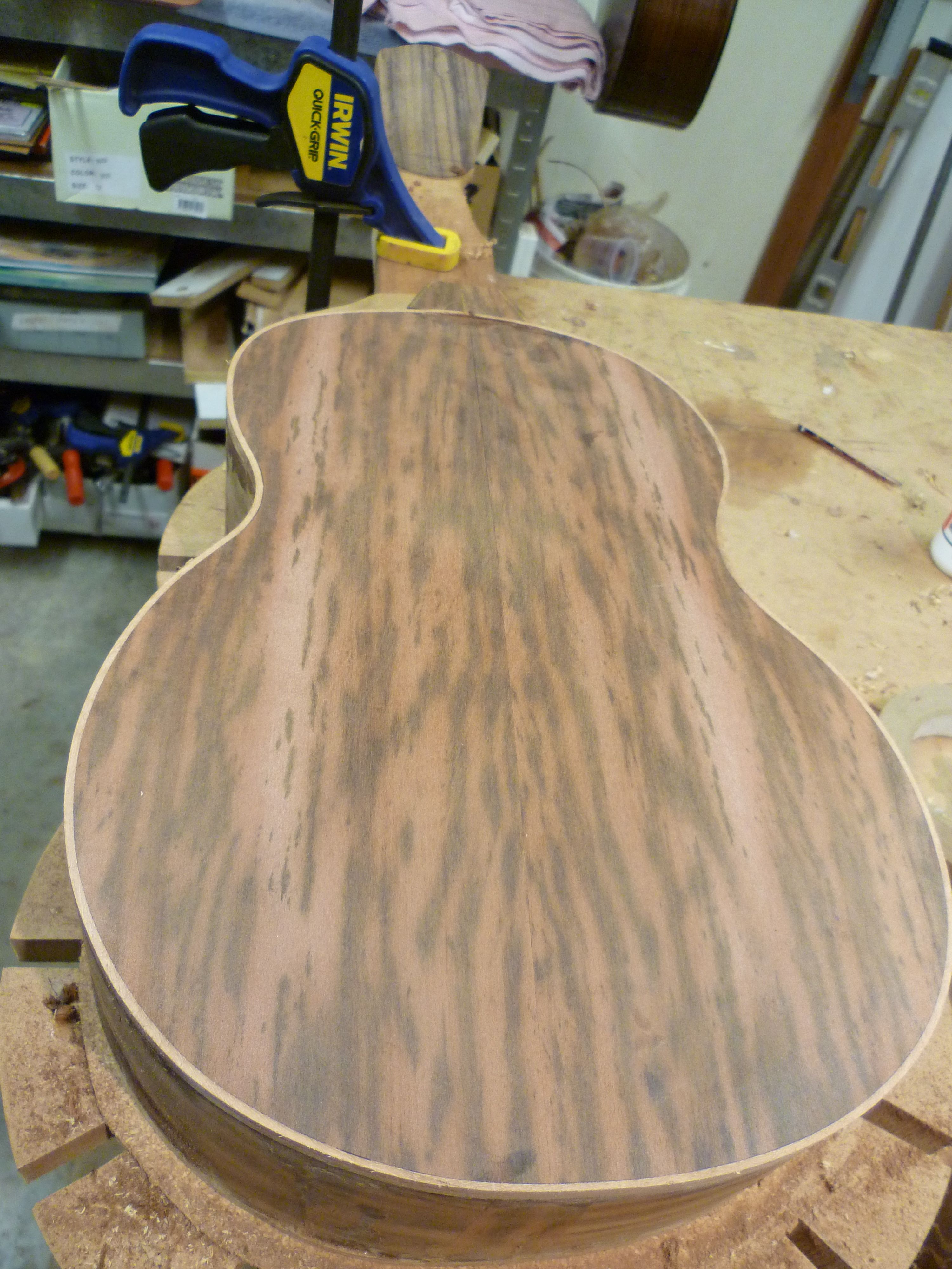

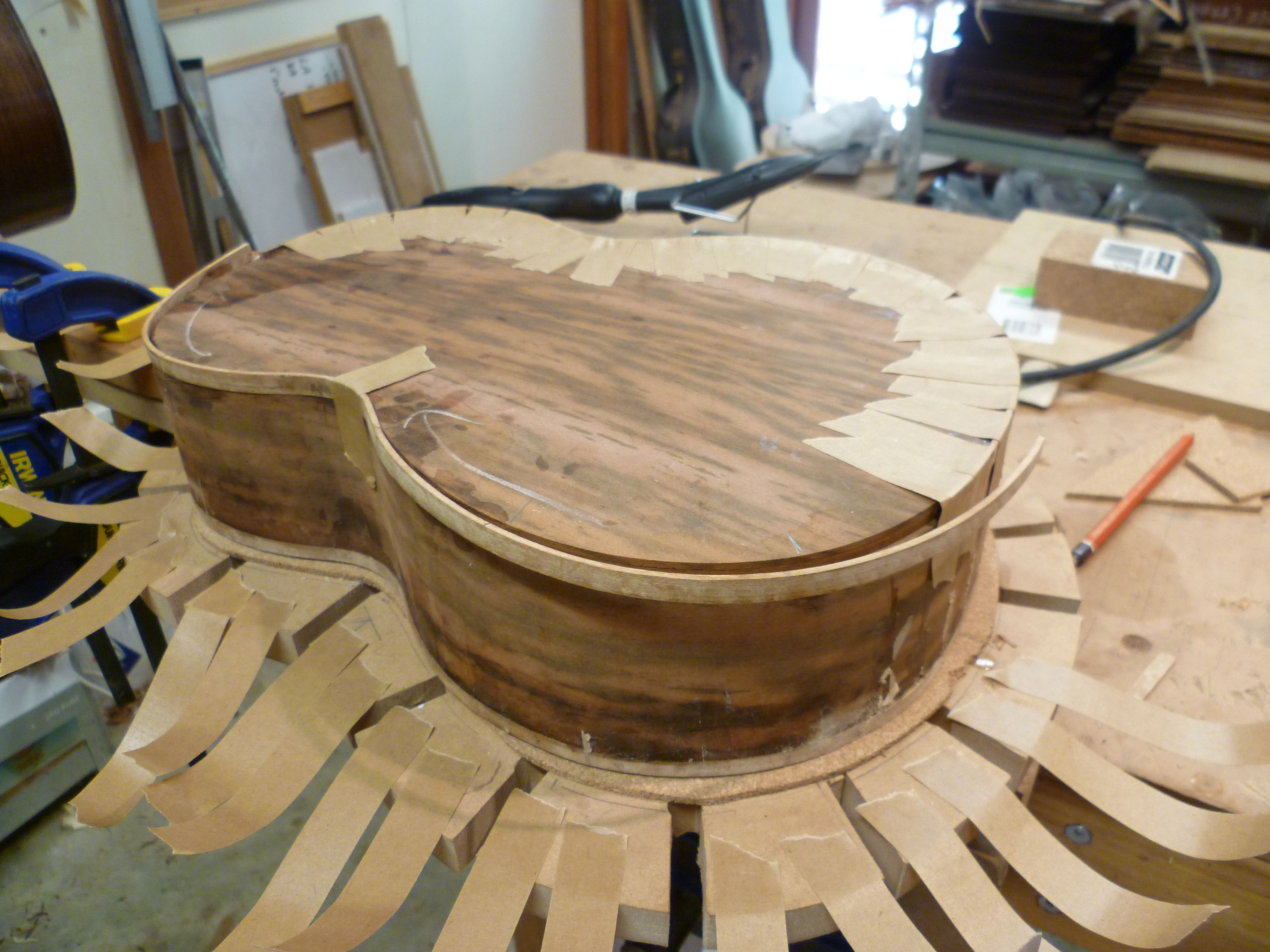

Post by kiwigeo » Sat Jan 28, 2012 8:26 pm
Last of the bindings glued in......was that a sh*t of a job! Tomorrow my favourite job...scraping back bindings.

Not much work done on the uke today......busy doing other things like thrashing it on my bike and playing the dutiful husband.
All I got done was pulling off the binding tape on the back bindings and doing a quick scrape job on same. The bindings seem to go ok with the Tiger Myrtle.

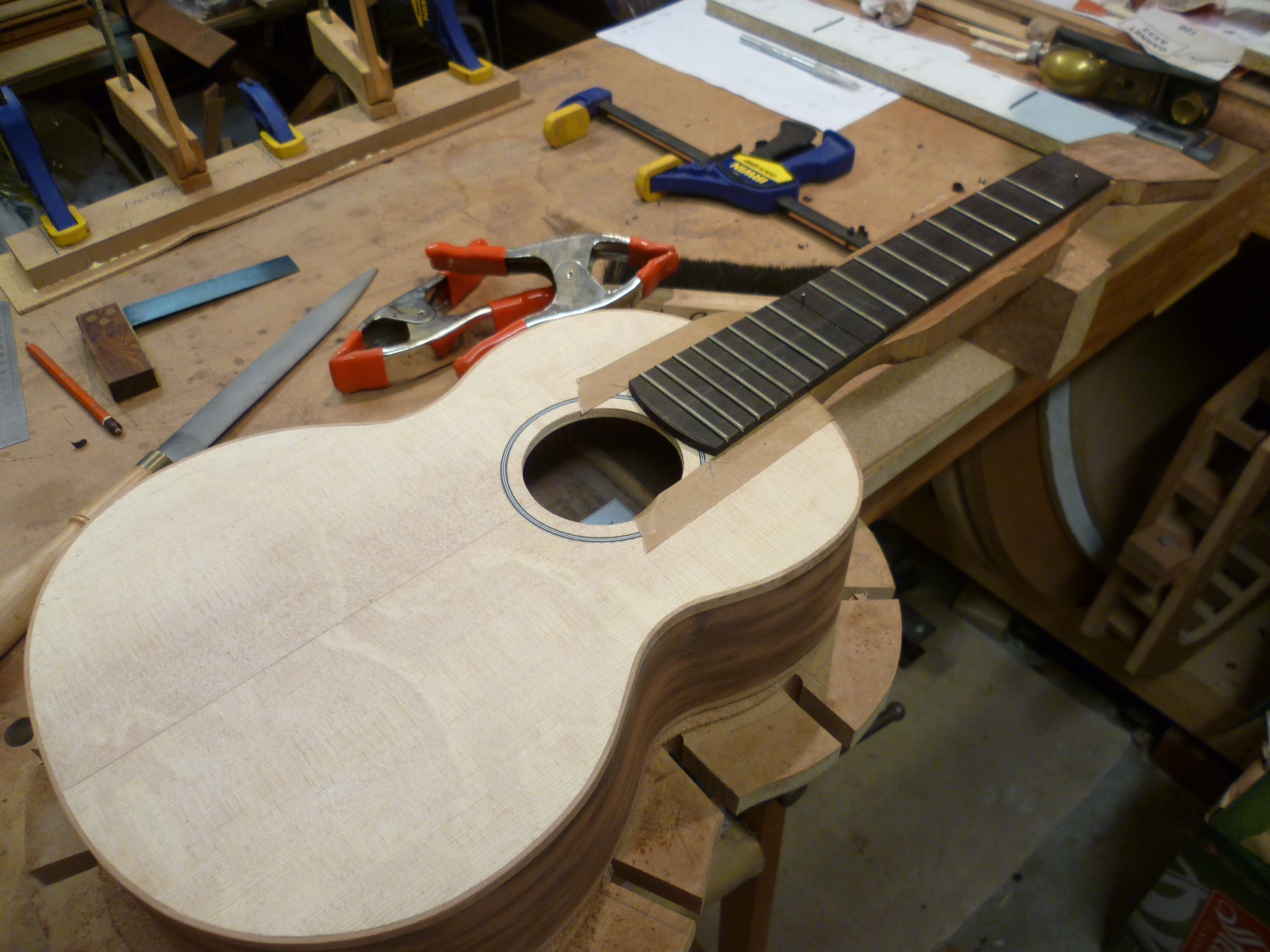

Post by kiwigeo » Mon Jan 30, 2012 8:52 pm
Fretboard jigged up and fretted and ready for gluing on.

Post by auscab » Mon Jan 30, 2012 10:14 pm
Do you hammer frets in Martin or have you upgraded to a press ?
Or do you think a press is not necessary ?
I keep seeing a type of pipe clamp on E bay that I would think would convert to a decent press for frets, with a bit of a tinker.
Re: Steph's Tiger Tenor Uke
Post by kiwigeo » Mon Jan 30, 2012 10:17 pm
auscab wrote:Do you hammer frets in Martin or have you upgraded to a press ?
I'm a hammerer.....I find it helps release tension. I do have a set of Stewmac Jaws cauls for my drill press but havent yet used them.

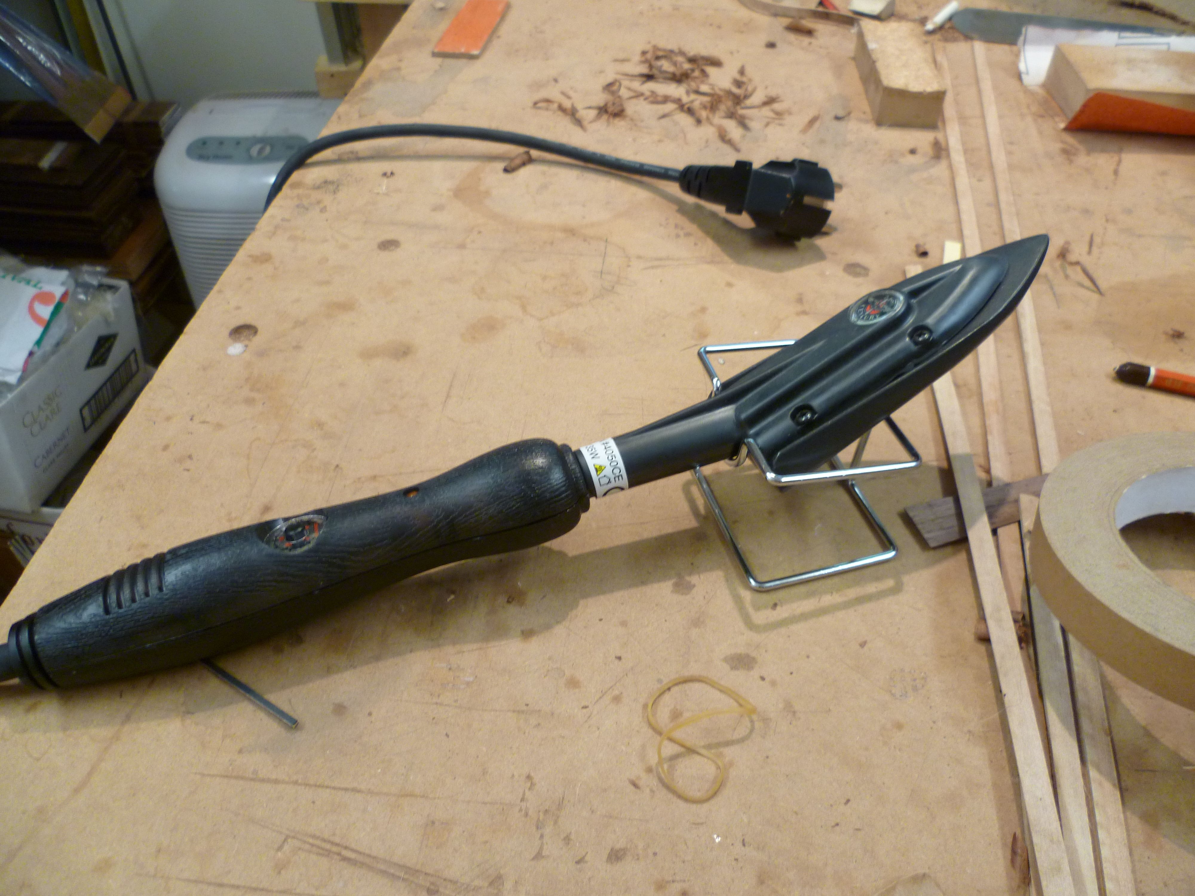

So that file... DOH! But err, it doesn't happen to be the diamond coated fret file does it? If so, I may be interested if you don't need the two... :mrgreen:
Also had meant to ask where you got that electric photographers sealing iron from? Quite a handy tool I'm thinking.
