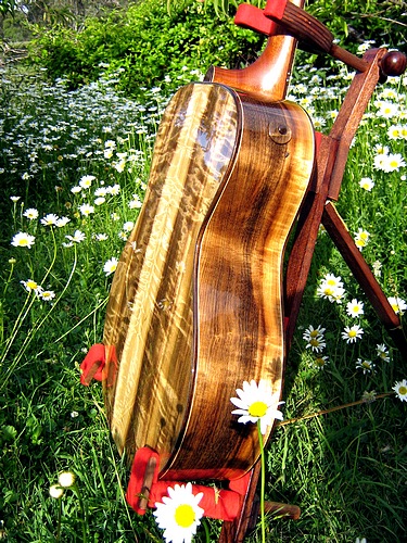

I made a matching plug for a soundport I included on this 12 string . Consequently I can easily play with or without the port. I think "size does matter" in this case. You don't want it too big !
I made the soundhole a bit smaller to allow for the soundport opening
There is a marked difference . I've asked many listeners which they prefer and in almost every case they have prefered the sound with the stopper removed. Most claim it to sound louder but I have no scientific proof . It could be that the extra higher frequencies emitted with the port working may make the guitar seem louder to the human ear.
When playing it , I much prefer to have the port open . It gives me a good report much like a monitor. . The stopper tends to live in the case ,,, unused .
I mainly included a port on this guitar as it was built with thick sides and massive liners. The type of guitar that radiates sound mostly from the soundboard . Tends to throw the sound out front away from the player .
On the other hand, I didn't include a soundport on a (much lighter ) mahogany guitar I recently finished as it is the type that radiates sound from most of it's body ( a real chest thumper !
) Great to play !
I don't believe a port is required or suited to those type of instruments.
Here's a pic of the 12 where you can see the port stopper.

WOW, Craig, that guitar is beautiful. Another one that makes me more reticent to put up photos when I finish my first OM. You guys are just too good.
The plug is a nice touch. Did you cut it out before bending? the grain looks perfectly matched?
As mentioned, others hear my guitars perfectly, but my soundport query is to see if I will hear it better...I just may try the port/plug route to see for myself.
Thanks for posting Craig....

Thanks Nick, No ,the soundport cut-out isn't big enough to make that stopper ( it's larger than the actual soundport hole as you can see.) I hunted through all the off cuts till I found a piece to match the grain perfectly. I also bent it to suit the upper bout . Went to all that trouble and now the plug tends to live in the casennickusa wrote:WOW, Craig, that guitar is beautiful.
Exactly the point I was trying to make Allen when mentioning I didn't include a port on a much lighter Mahogany guitar.Allen wrote:
Interesting your observations Craig. In the ones I've built the sides and back I would call responsive, so perhaps that's the difference.
I'd have to conclude that I'm probably not exactly a soundport fanatic, although they can add to the player's enjoyment when playing a heavily built guitar .
