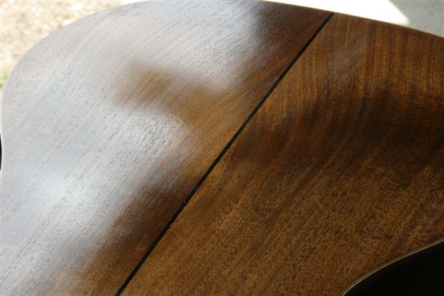

Here is some pics of bodying.
First is the open grain, after a few brush coats I think, I did this a year back.
Second is the straights and circles then back to straight sticky build with no oil,
see the finger print.
Third is a good flick of oil. linseed
Four is still doing circles pushing down spreading it sideways.
- IMG_6303.JPG (51.92 KiB) Viewed 18219 times
- IMG_6304.JPG (36.8 KiB) Viewed 18219 times
- IMG_6305.JPG (42.11 KiB) Viewed 18219 times
- IMG_6306.JPG (39.7 KiB) Viewed 18219 times

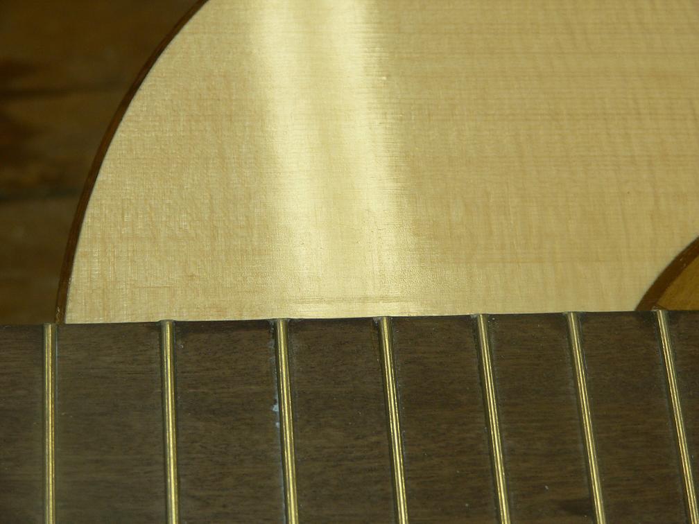

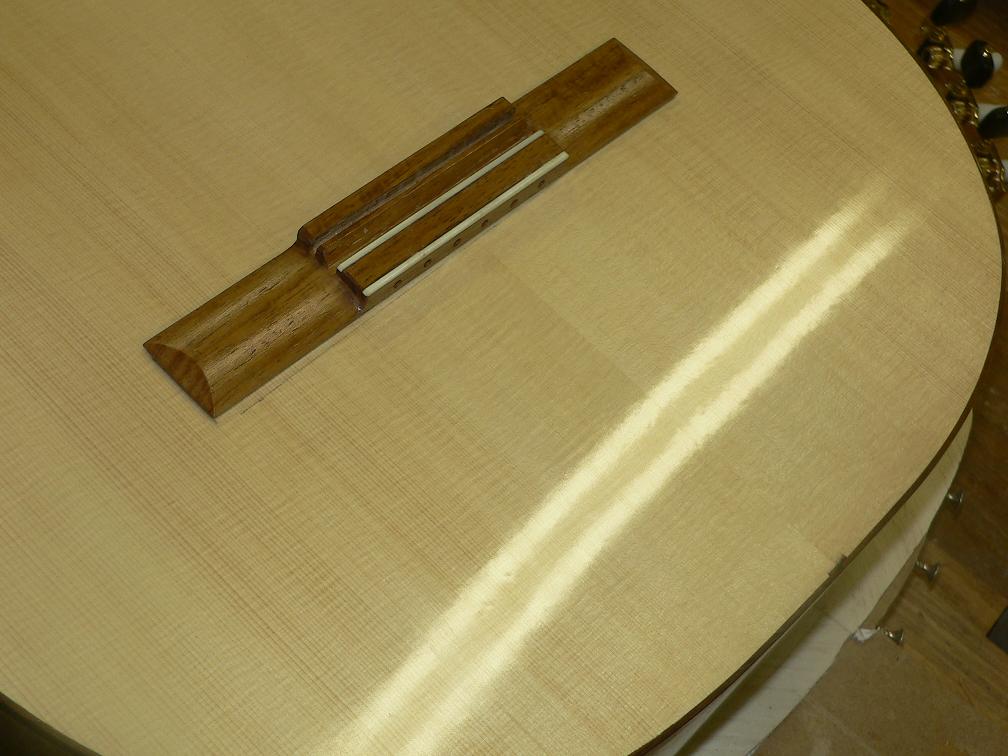

Alastair
Alastair
Re: French Polishing--when is enough bodying?
Alastair your finish looks good and you will get better the more you try, I can see that the flouro globes are more focused in the lower bout than the upper.
The hard thing about touching up a finish on a guitar is the bridge, but what the heck , just keep trying on the back and sides for a while. When it's getting better have a go at the top.
