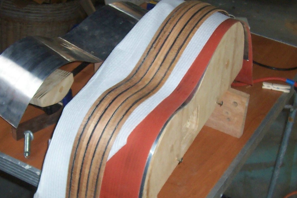

Half an hour to bend bindings for two guitars including setup insted of a full morning slaving over a hot iron
No breaks,delaminations etc just perfect

That's blackwood binding with BWB attached from Tim Spittle. I don't know what glue he used, but it was fine.
I bent dry, pulled down the waist after about 1 minute then the lower and upper bouts

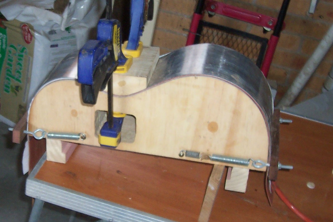

It's an LMI blanket with a 1200w dimmer switch on the power supply for temp regulation

I wouldn't be without my blanket now. It makes bending even the most troublesome (or expensive and often both!) timbers a breeze. It pays for itself just in the lack of angst!
I do all my sides and bindings etc with the blanket. I too have the Ibex electric iron, but mostly I only use that to bend my unusual inlays or rosette purflings and the like these days. It can still help as a touch up aid though - some timbers still spring back more than others when fresh from the blanket/mold setup.
I usually use Titebond when gluing up my custom purflings and binding. I have had no issue with them delaminating when bent with the blanket. It has been mentioned before and others use different glues without issue as well.
Good luck with the Ziricote Nick! It is right up there, if not at the top itself in the visual appeal department for me. I'm doing my third ukulele out of it at the moment though and it bends fine with a blanket - that's on much tighter radiuses than you are likely to have. Worthwhile investment they are.

I glue my purflings on to the bindings with HHG and never have an issue with them delaminating using the blanket and solid form. Bend dry though.
