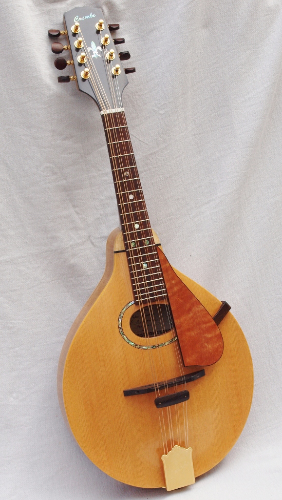

I would be interested in what the guitar makers think of King Billy as a top wood in guitars. I have only come across 2 SS guitars with King Billy tops and did not like either of them. Has anyone had success with King Billy in guitars?

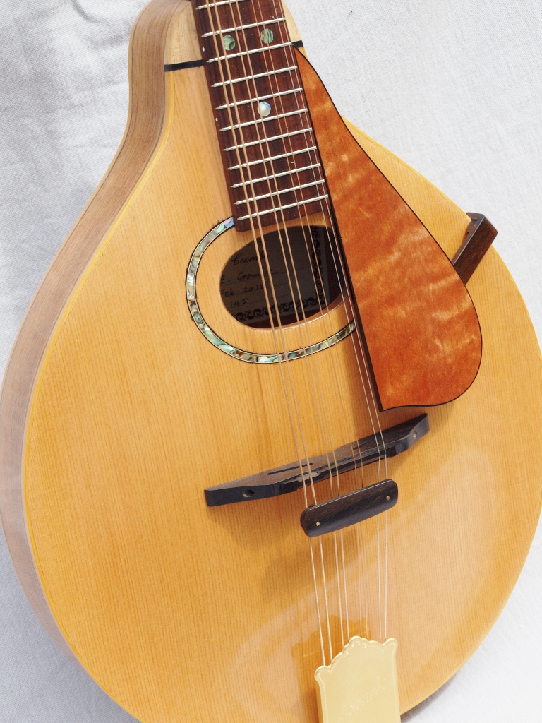

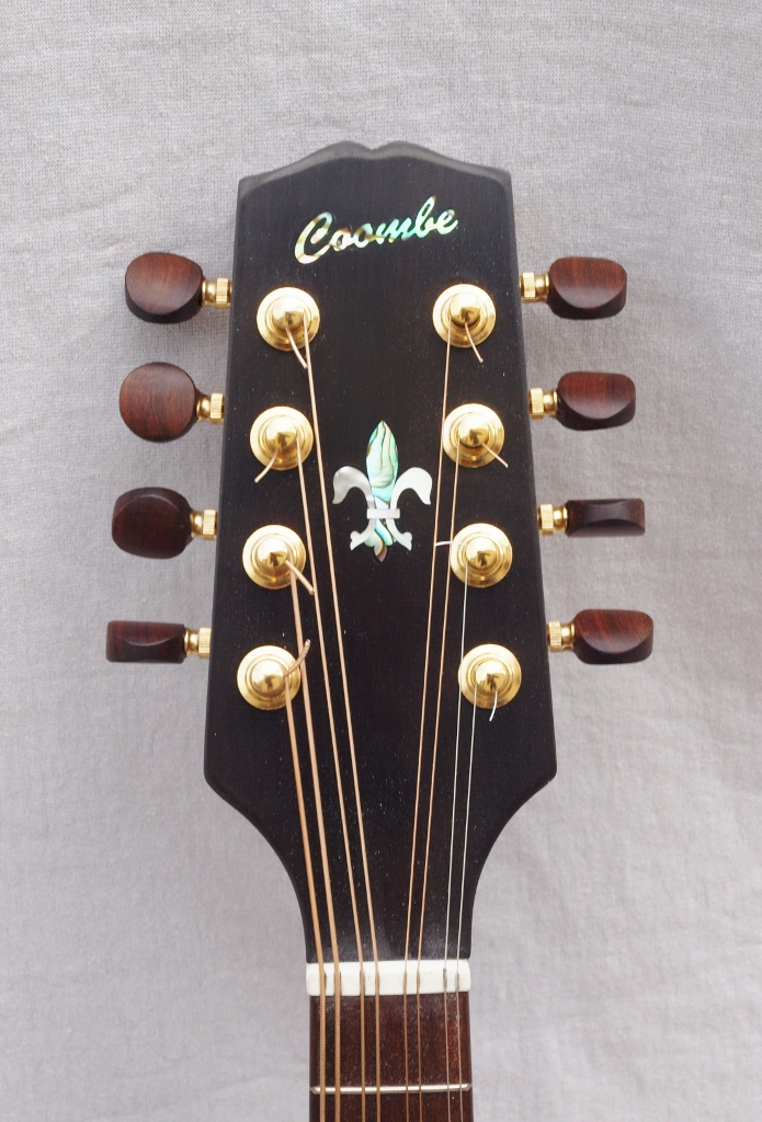

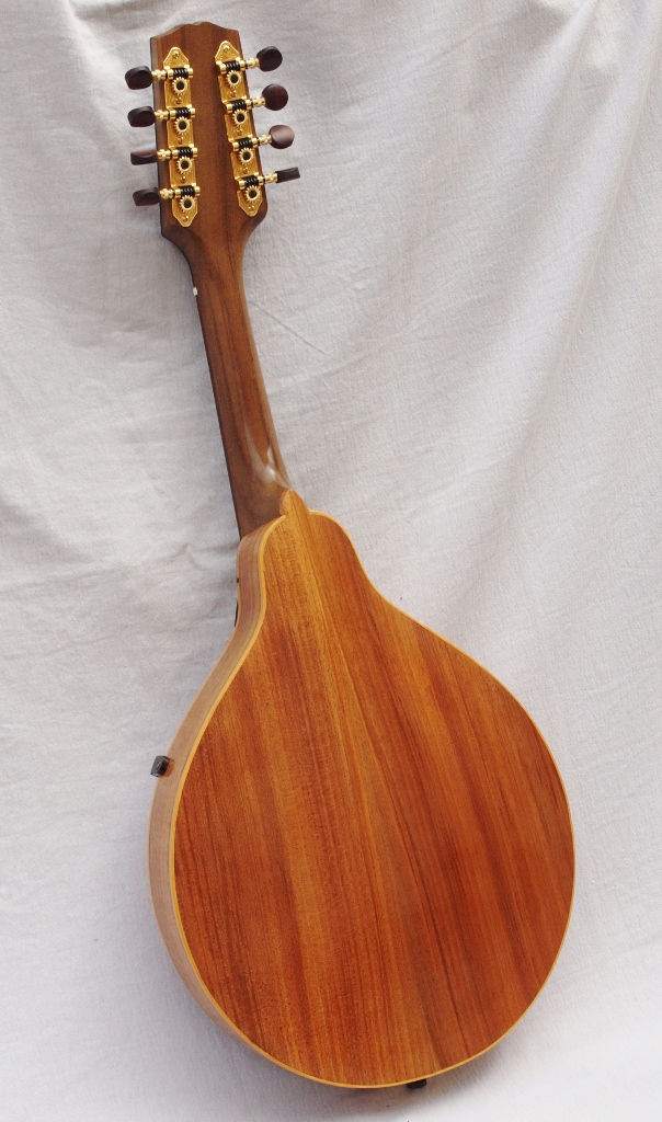

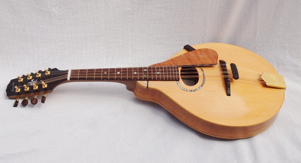

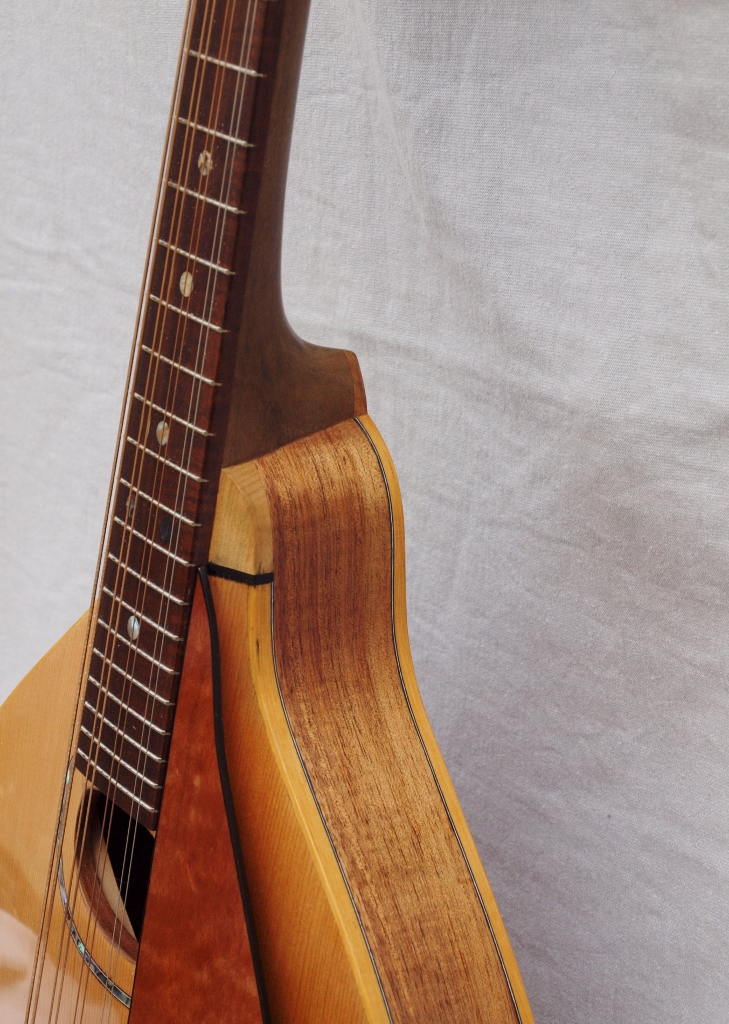

I have used a lot of King Billy Pine in my mandolins. It works really well in mandolins and violins, particularly with Blackwood backs. I have tried it with Myrtle, Qld Maple and Jarrah, as well as Blackwood. All sound nice, but I do prefer the sound I get with Blackwood. Myrtle makes beautiful sounding instruments, but they are quiet with poor headroom. I have found that the sound varies quite a bit so that some will overlap with the Spruce topped mandolins, but occasionally one comes out sounding stunning, and blows away all my Spruce mandolins. I have long suspected this may be because of the very high variability in weight and stiffness of King Billy and Blackwood. The stunning sounding instruments all seem to have moderately light weight Blackwood backs and stiffer King Billy tops. Unfortunately much of the fiddleback Blackwood is a bit on the heavy side, but customers all want figured Blackwood, so is difficult to maintain the looks as well as the sound. Added to this is King Billy is now very hard to get, so you can't be too fussy about the quality.
Anyway, here are some pictures of my latest. This is something I have been wanting to try for a long time i.e. pick the best quality King Billy and use a plain piece of Blackwood that is light and stiff for the back. I managed to score a beautiful clean and perfectly 1/4 sawn piece of King Billy at the Canberra WWW show a few years ago and used that. It works. This is an amazing sounding mandolin that has blown away some of my best sounding Spruce mandolins. It really shows what can be done with Aussie native timbers. Not only that but I really like the colours of the wood combination. Woods are King Billy top and linings, Blackwood back and sides, Qld Walnut neck, Ivorywood bindings, Lancewood tuning knobs and fingerboard, Myrtle fingerboard, Qld Maple head and tailblock. About the only wood that is not an Aussie native is the Ebony headstock overlay. I was going to make a sound clip, but I am crippled with a torn muscle at the moment (done on the tennis court, must be getting too old for that), and just to get to the workshop is a massive effort. There are some soundclips of a similar mandolin on my web site. Got to http://petercoombe.com/goldfinch.html

Exquisite work as always Peter. The tennis injury sounds serious..take it easy for a bit mate.

Hi Peter,
Certainly a beautifully made instrument !!! I don't know anything about king billy so can't add on that front.
but perhaps you have nailed its optimum dimension and shape in these instruments and have been able to get the very best out of it.
I know in my own findings with NZ natives, some work better on smaller instruments some better on bigger, then throw in the bracing and in combination with the back and sides. It's a great puzzle.
look forward to hearing what those in the know add.

Mmm now that looks pretty damned good.

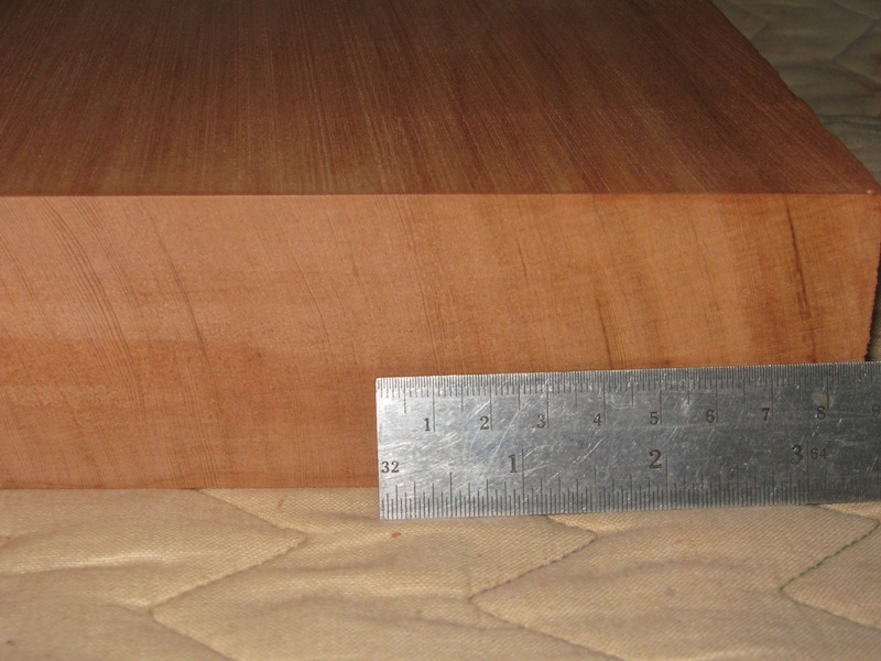

I've just returned from a trip to Tassie, at Strahan i purchased some nicely quartered King Billy from Tasmanian Specialty Timbers,
two meters long , 238mm wide 60mm thick. A bit of history came with the purchase, the timber was extracted by Bern Bradshaw in the 1950's, it is said that the tree that this billet came from was killed in the 1896 bush fire and sat on the Raglan range overlooking the Franklin river for may years until these timber getters cut tracks up these impossibly steep slopes and painstakingly bring these timbers down. I haven't got the stuff in my hot little hands yet, being delivered by courier, some pics will follow when it arrives.
