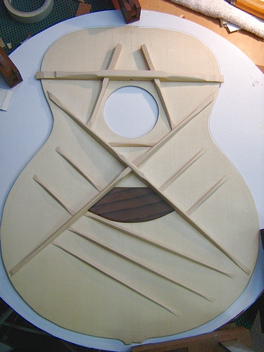

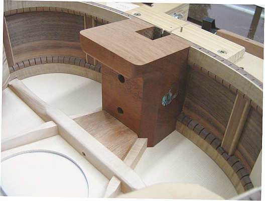

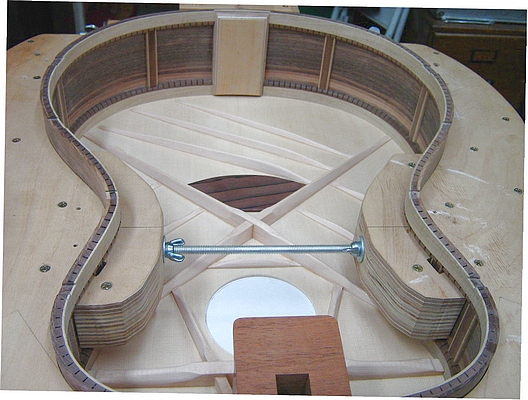

Post by Craig » Thu Mar 29, 2012 8:53 am
I made my bracing 10% taller than what I would on a 6 string . Virtually no weight increase . I used an Englemann soundboard as I thought it's properties would suit a 12 . You would normally leave Englemann a little thicker ( as I did ) but it depends on the qualities of the piece you are using. A slightly bigger bridge patch ( Rosewood in this case) .The completed soundboard wasn't much heavier than a 6 stringer.
I guess if I had intended to string the thing up with fairly heavy strings and tuned to concert I may have beefed things up a little more , but I didn't want to overbuild and have the thing sound crap like so many other 12's .
You'll note the three lower face braces , the first of which , I placed fairly close to the bridge patch area.
The area above the soundhole I've made quite solid . The A frame bracing is ideal here and I didn't skimp on it's dimensions ( 5/16 " X 1/2 " ) with the upper transverse being 1/2 " X 3/4 "
Another important consideration with 12 stringers which seems often ignored , is their playability. I've played way too many that have necks much too narrow . 1 15/16 " at the nut minimum
