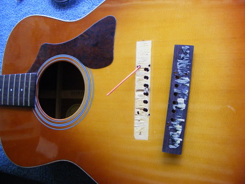

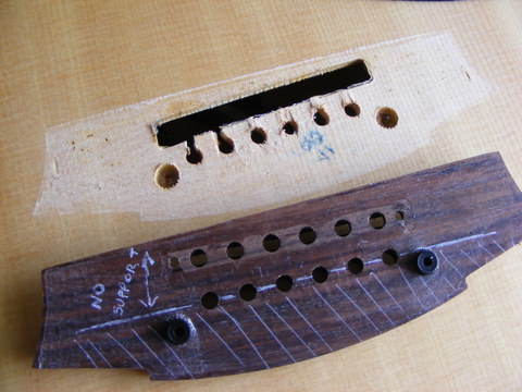

Here's a couple of beauties. When the bridge was completely removed [only the pins were holding it on] it revealed the double pin holes underneath, a well respected brand.
And....the shaded area on the bridge shows the extent of the bridge plate coverage, it ended at the pin holes. Another well known brand.

Well the one with the big rectangular hole is a Maton I presume, but what is the other?
Re: opinions please
Post by charangohabsburg » Fri Mar 23, 2012 11:46 pm
One just has to love those well-respected-brand horror picture shows... :roll:
Posts: 1077
Re: opinions please
Post by Taffy Evans » Sat Mar 24, 2012 8:52 am
Hi Jeff, top one is a Guild, bottom a Col Clarke.
