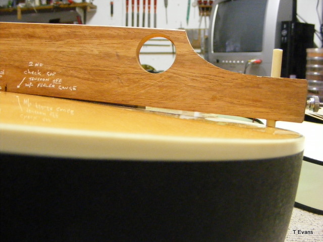

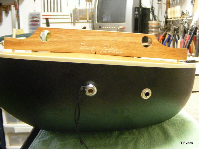

As a matter of interest I have shown the report below and the photo's that accompanied it:
Hi W , I have looked at your 12 string Ovation Standard Balladeer Mod 2751AX [could find no S/#] and fear that I am unable to effect an economical repair. I am sorry to say that there are very few guitars that fall into this bracket with me but this is one of them.
However I shall highlight the problem areas in case you should wish to take this guitar back to the supplier’s attention. If as you say this guitar has not been subjected to extremes of heat or humidity then I may suspect a oversight in manufacture.
*The most obvious anomaly is the high radius of the top. All is good on the inside with all braces appearing to be as they were from the factory.
*The difference between the radius height under tension of the strings and the radius with no tension is 1.12mm.

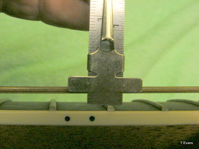

*The string height at the first fret is also excessive, this and the high top radius contribute to the 4.25mm action at the 12 fret
*The neck is not bowed up so is not contributing to the excessive action height
*However, the neck is set on the same plane as the top. Normally a neck has a calculated angle back [or down] to give the right fingerboard projection to the bridge. As it is [on this guitar] the strings follow a path to the saddle, but the neck follows another.
*Resetting the neck angle may be part of the answer, but is expensive work, strengthening the top so that it does not “pull up” like it does under tension is the other part of the answer, and is equally as expensive.
Adding all the above together I feel this is a job for the suppliers service department.
Regards Taff

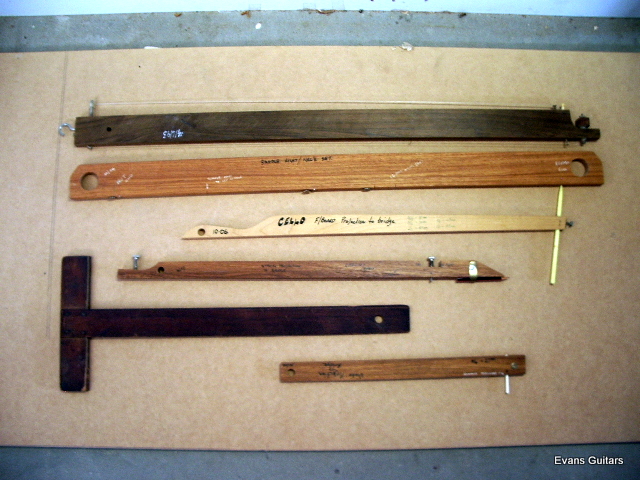

nice to see another wooden straightedge in use Taffy.

Hi Matthew, its worked well for a few years now, but I would not use it for fret work. The photo shows some others I've made and been using for years, the "T" square goes back to late 1950's. All are still straight and do the their jobs.

I would like to know what each one does ? and how you use it please.
specially the one with the string line up top.
If I can take a guess at it first, I would say you would use it to measure the twist in a neck ??
