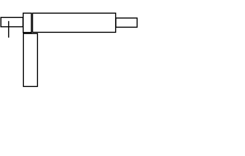

Never having built a violin, I'm not in the slightest way informed on how they would want a gramil designed. And to be honest it wasn't a consideration. Call it a bias to guitar family instruments.
I've had to glue on a couple of finger boards on ones lately and they seem very tiny and delicate. Personally I would think that this tool may be a bit too large and have more mass than what would be optimum for that task. Cello's and arch top guitars on the other hand would be more in line with it's scale.
Dom, you posted while I was writing this. Not clear to me. How about a picture.

Hope this helps. The verticle bar is the gremlin and the horizontal bar is your existing tool. The top bit of the gremlin has a hole cut through which the knife bar fits. Despite my crappy picture the side of the gremlin that runs against the top is smooth and does not step all the way up the knife bar. And one screw into the body of the tool should be enough to fix it solidly.
let me know if have succeeded to make it more clear or not.
