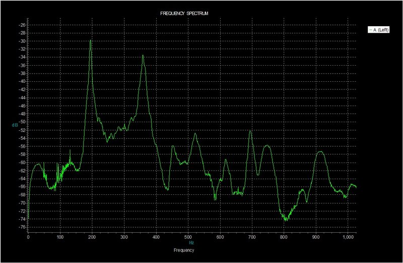

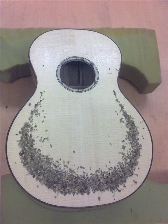

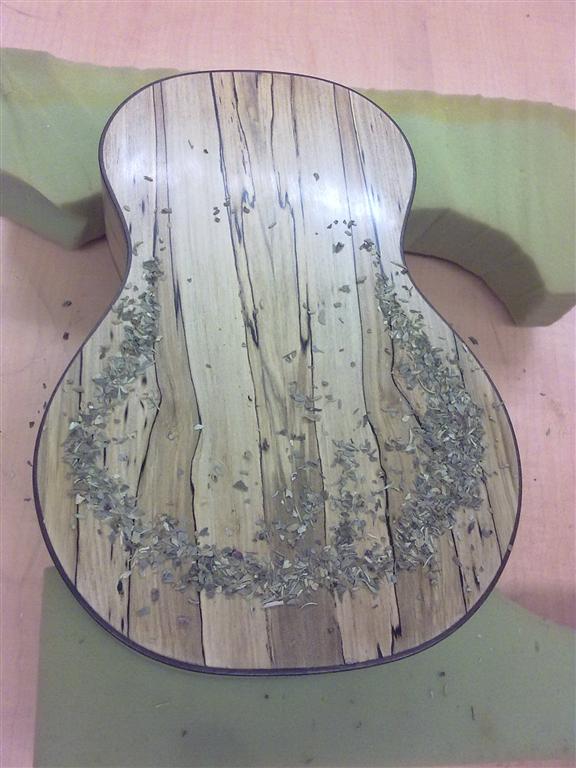

Ok, ok. I got home early so here you go.
Built & bound, but no bridge yet.
T(1,1)1 @ 195Hz
T(1,1)2 @ 361Hz
T(1,1)3 @ 455Hz
T(2,1) @ 521 Hz
361 Hz.jpg (57.16 KiB) Viewed 29616 times
455 Hz (sort of).jpg (66.48 KiB) Viewed 29616 times
120620122469 (Medium).jpg (36.64 KiB) Viewed 29616 times
Hopefully I can repeat it all when the bridge on & see what change occurs.
I'm keen to add side mass (if I can) and see if I can get the monopole mode closer to the edge.
The added weight may, of course, make the instrument way too heavy for general acceptance - but this is fun!
