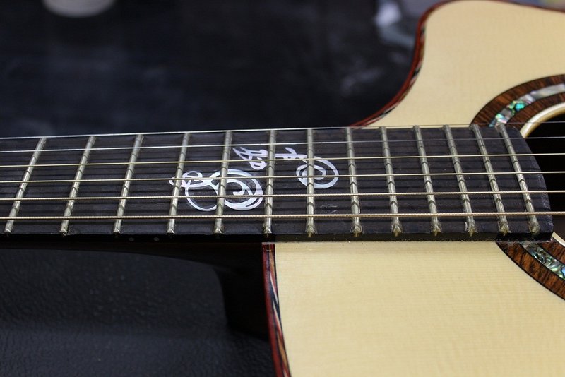

More

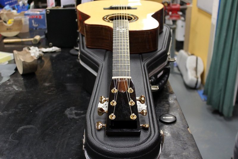

Nice headstock shape, symmetry nah dont worry about that

Bridge pins look crooked...holes not straight? Saddle looks a bit slanted as well.
No fret markers?
Headstock looks like its been painted black.....doesnt really go with the nicely silked spruce top and the fancy purfs

Nice fret spacing.

Don't know the tuning but the temperament is 'unusual' and would not suit your usual standard six-string tuning but ..
Pins and break angle look out but that can be in the pic process?

Whats wrong with the instrument fitted 3 x A4 pages of my report, I posted the you got to be kidding pictures

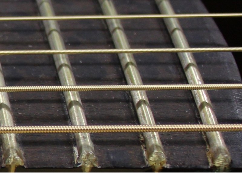

Nice fretwork

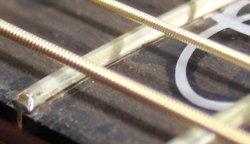

One last photo and then Ill call it quits, I took about 70 photos of all the things wrong, if it was a chinese guitar Id say yeh you know its not bad for a $300 guitar, but you can times that by 40 for the price the owner supposedly paid for this one

Well, at least the strings are shiny, maybe that would malke you miss the exceptionally accurate inlay work. Jeez, even I dress the frets after levelling....

When I saw the first two pictures I thought "just acceptable for a 500$ guitar". But for 4k I would expect that the bridge did not bleed out into the spruce top, and I would prefer no inlay over one with cloudy ebony edges. The not dressed fret ends over the top's bass side don't matter, you never will touch them with your fingers while playing. And the tilted headstock... oh well, call it a feature.

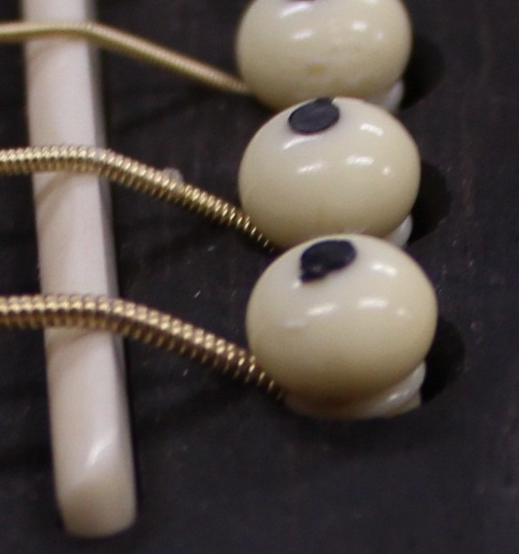

Heres a close up of the bridge pin holes
Im not trying to take the piss out of the builder but youve got to have pride in your work, youve got to have some hand skills
bridge pins.jpg (65.81 KiB) Viewed 22097 times
Re: Im not going to say a thing, but WTF
Post by charangohabsburg » Fri Jun 15, 2012 10:44 pm
Yes, forgot to mention the nice big bridge pin holes. And the very nice bridge pins themselves.

The bridge pins. The black dots on top have a small extension on one side.....shouldn't all the "extensions" be pointing in the same direction. Are these "extensions" lined up with the slots on the pin shafts???
Looks to me like the pins are sticking out because someone hasn't aligned the slots with the strings

kiwigeo wrote:The bridge pins. The black dots on top have a small extension on one side.....shouldn't all the "extensions" be pointing in the same direction. Are these "extensions" lined up with the slots on the pin shafts???
:lol: :lol: :lol:
P.S.
I further think that these pins are not pushed all the way down. Very bad, indeed!
:lol: :lol: :lol:
P.S.
Thats because the slots arent properly aligned with the strings
Post by charangohabsburg » Fri Jun 15, 2012 11:31 pm
No, I think the uppermost part of these pins should be flush with the bridge surface. :twisted: Just make those holes a bit bigger! :mrgreen:
