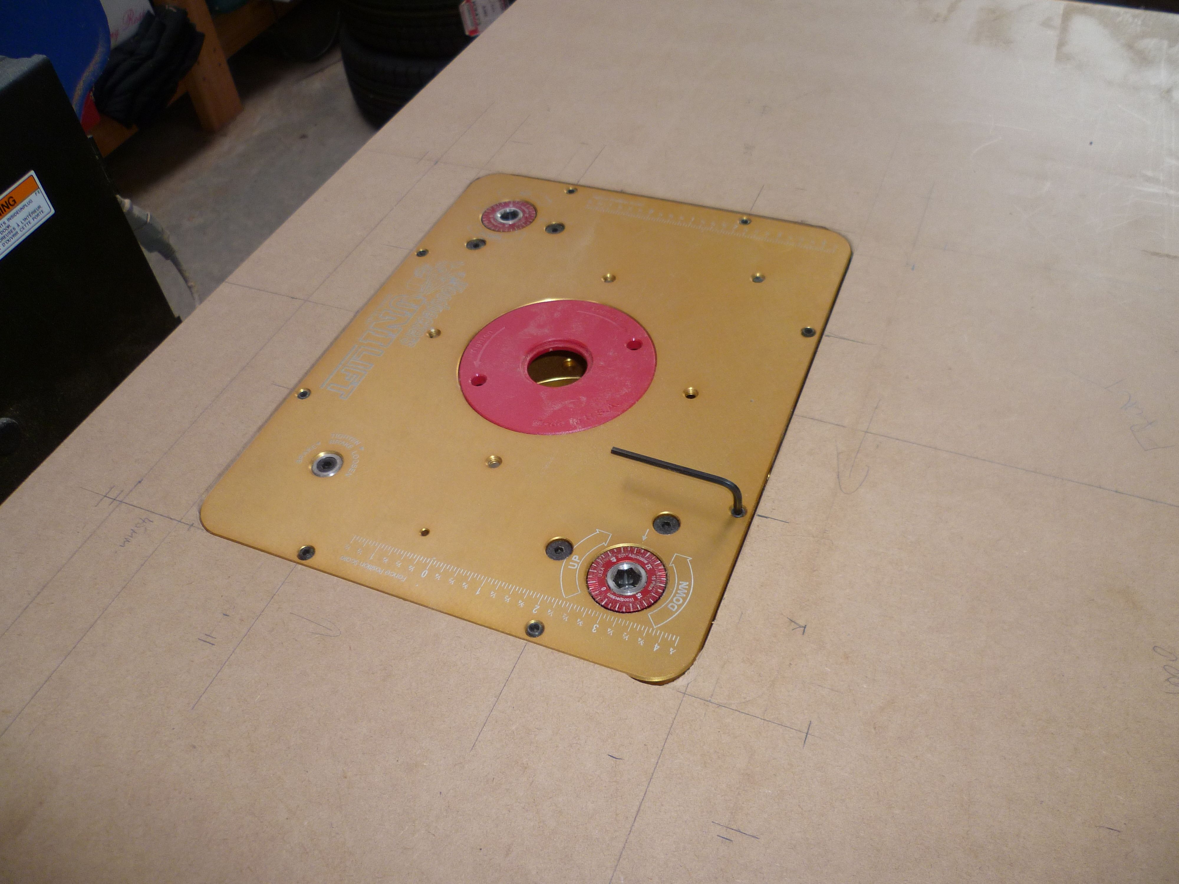

Wow that's a nice lifter. What do you think of the Hitachi M12VE router, Iv'e been thinking of buying one as they have a lower speed for large cutters?

EricDownunder wrote:Wow that's a nice lifter. What do you think of the Hitachi M12VE router, Iv'e been thinking of buying one as they have a lower speed for large cutters?
I like them. Big beefy router and quality of build is good. I like 'em so much Ive got two of them. Keep a look out on the woodwork forums and ebay as you often see them going cheap.
The Bosch GOF 1300 routers often appear on the second hand market...Ive got one of them too.

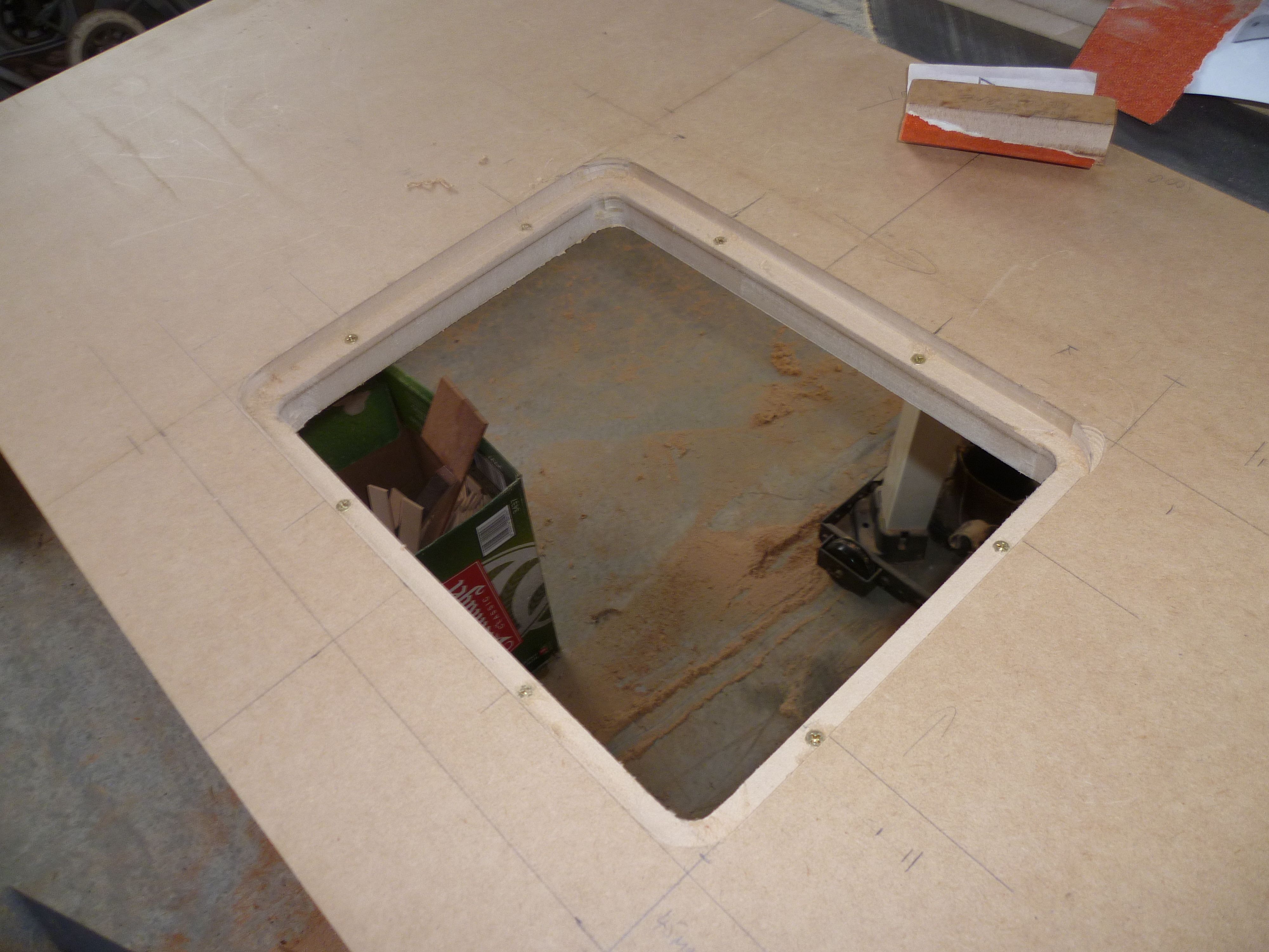

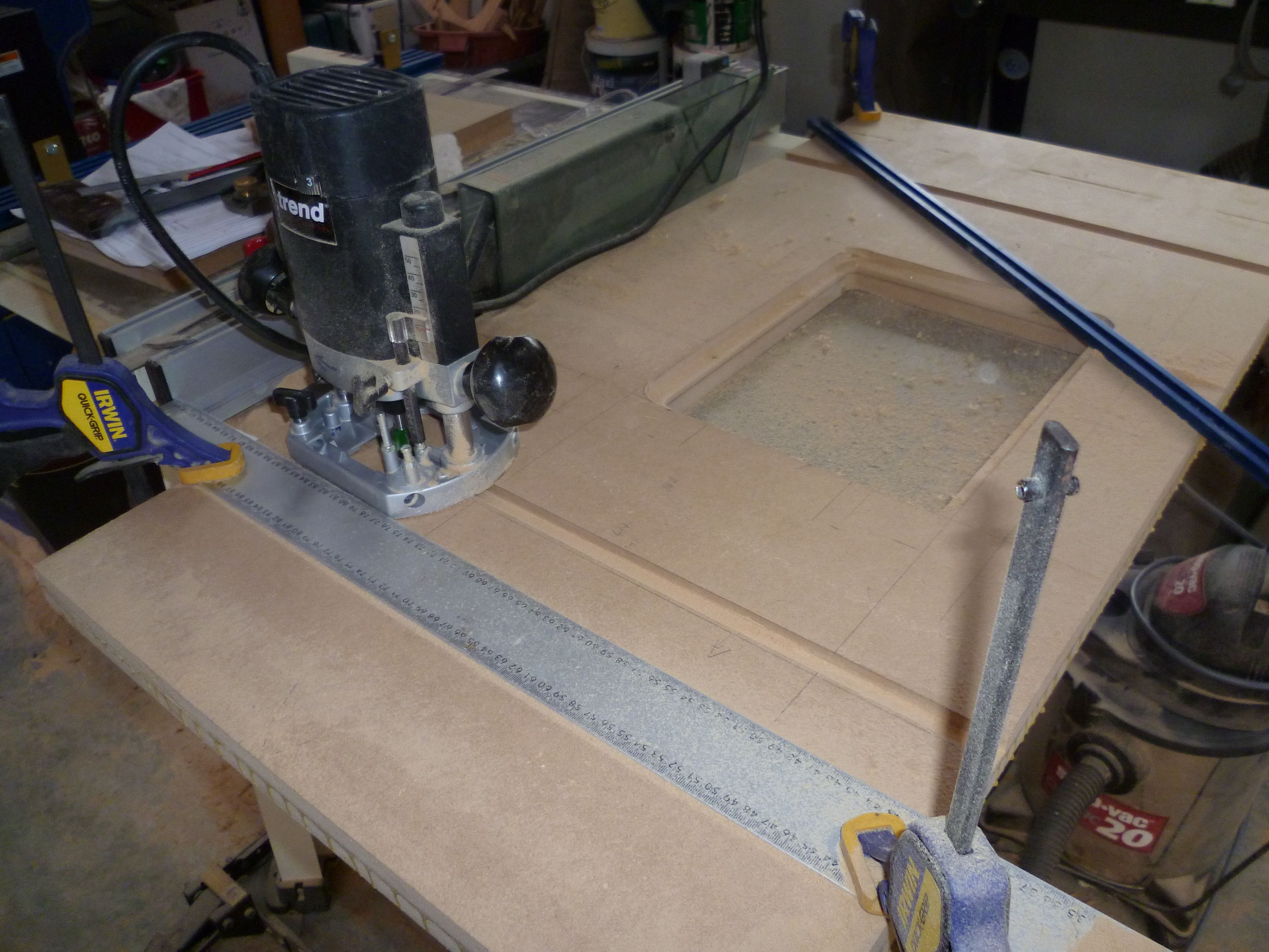

Post by kiwigeo » Sat Jun 16, 2012 5:17 pm
Nursing another bldi cold here but managed to get out to the shed and work on the router table. Top is basically finished and just needs some trim around the outside and a finish of some sort. Today was spent going nuts as I attempt my first serious cabinet making project. I dont have a dado blade for the saw so am cutting them with a router....would be really easy with a router table :?

Post by Tod Gilding » Sat Jun 16, 2012 8:04 pm
Very Nice Work Marty, I'm Impressed , Would you like to make me one, if I suck up enough :D
Re: Adhesive advice
Post by charangohabsburg » Sat Jun 16, 2012 9:22 pm
Looks great! :D
Re: Adhesive advice
Post by kiwigeo » Sat Jun 16, 2012 10:58 pm
Tod Gilding wrote:Very Nice Work Marty, I'm Impressed , Would you like to make me one, if I suck up enough :D
Yeah I'll make you one but the freight might be a killer. The top alone weighs at least 30Kg.

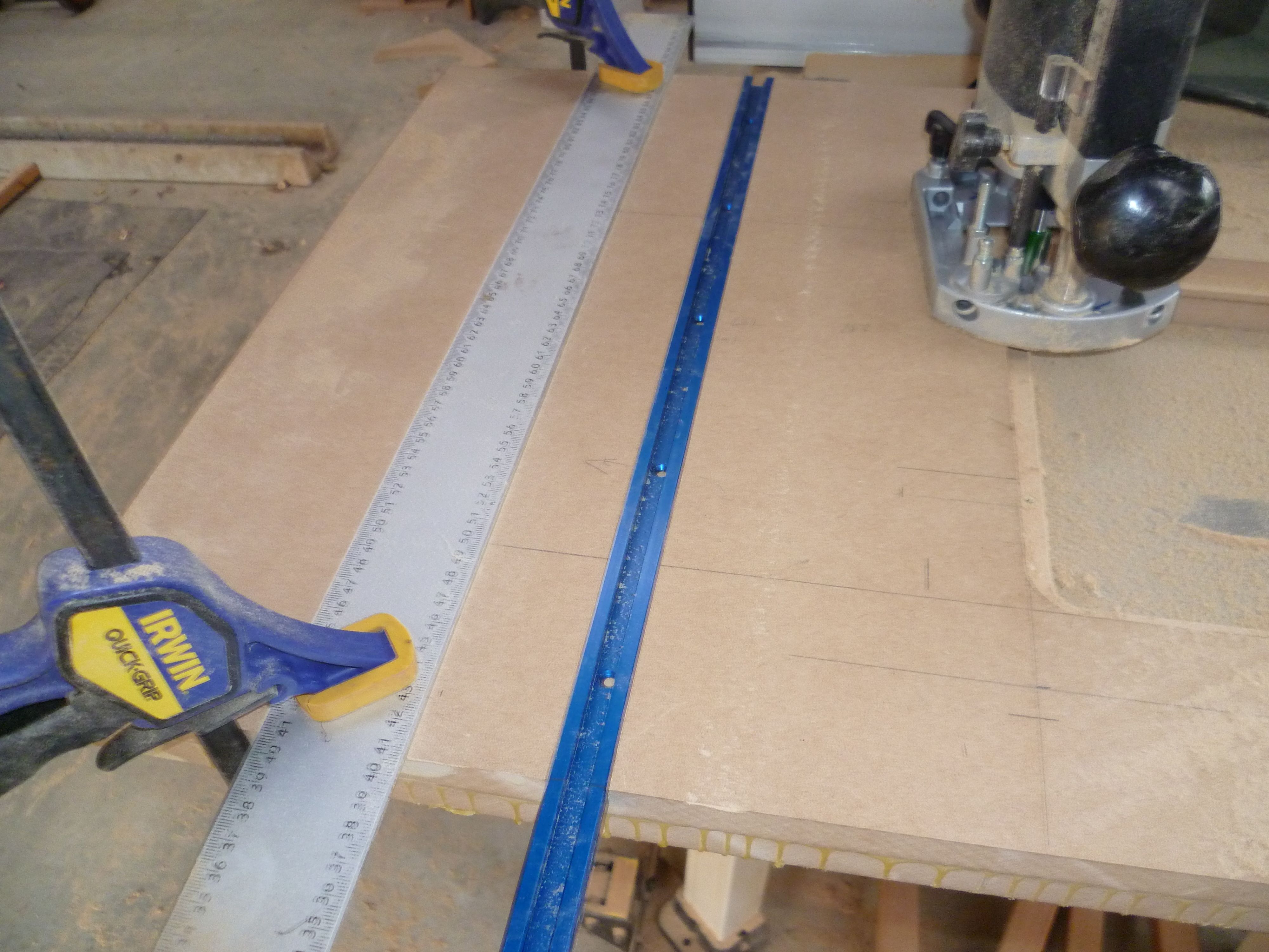

Re: Adhesive advice
Post by auscab » Sat Jun 16, 2012 11:25 pm
Looking good Martin
Is the blue channel part of your fence set up ?
Re: Adhesive advice
Post by kiwigeo » Sat Jun 16, 2012 11:51 pm
auscab wrote:Looking good Martin
Yeah its Kreg Mini T track. I have a Rockler fence that goes with same but Ill probably make up a fancier fence with provision for dust extraction at the cutter.

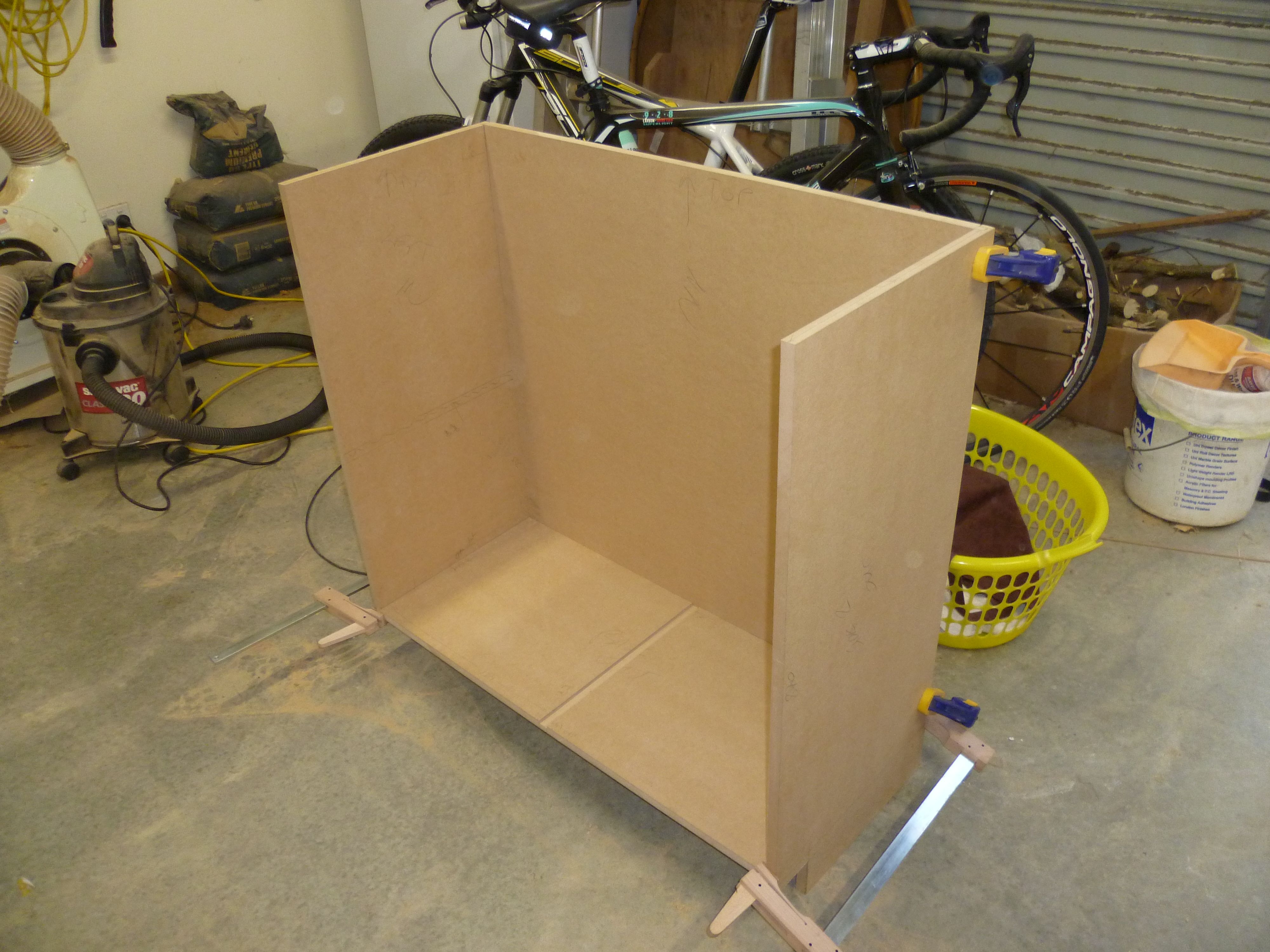

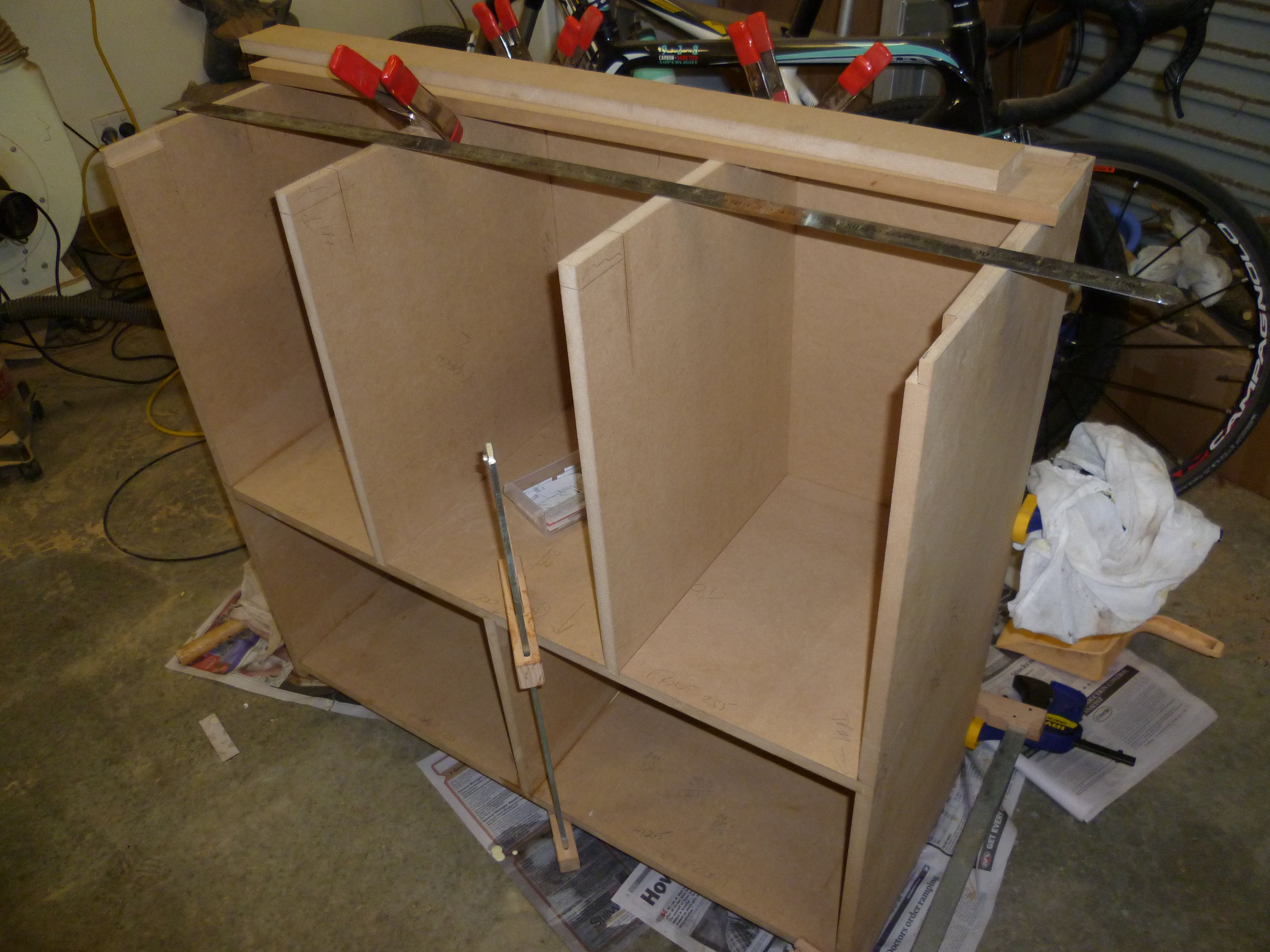

Re: Adhesive advice
Post by kiwigeo » Mon Jun 18, 2012 6:54 pm
Got the carcass glued up today.

1+ on the Formica top. Paint the rest, but a durable, slick top surface will serve you better, last longer and just make your life easier in the long run.
The base cabinet looks great so far. Thoughts on what color you're going to make it? Green maybe?
