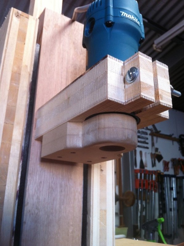

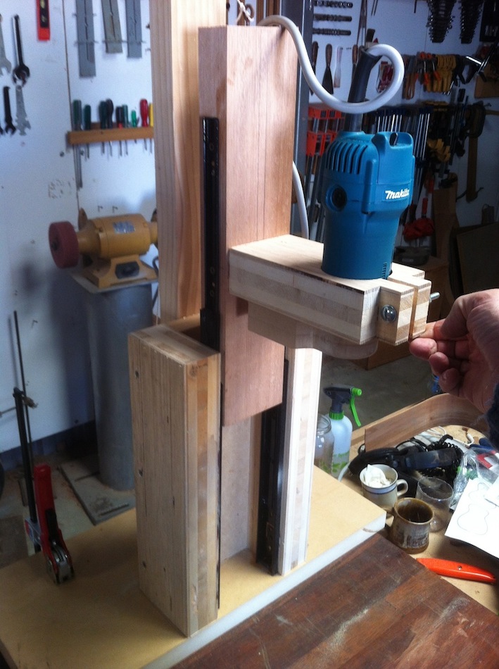

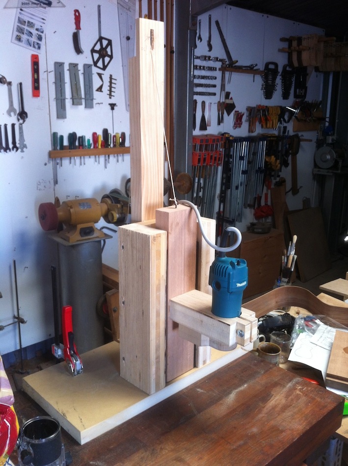

Stephen , with your inverted router, can you move the arm over the top out of the way? Or is there enough room to fit a jig and a guitar body ?
I built one of these for my inverted router and held the body freehand , side up against the fence. I used a down cut spiral bit and it went well. I just had to hold it level as I moved the body around which was not hard , any other accidental movement just meant the cutter moved away from the work so there was no problem of cutting away to much wood.
It’s much the same as the Kinkade set up, from his book. but with a taller fence.

Hi PM....I use the same set up as the link on Martins post....its very nicely made and is easy to use with a trimmer rather than a router...
Rob...nice set up Kinkade style...I used a similar set up for a while too...it works well and if PMan can tke the OHead arm off should be able to do that too...

John, I drilled two slots in the fence of that jig so it could be adjusted for the horizontal depth of cut.
I did think at the time of building it "funny how it looks like a neck"
In the picture above it you can’t see the slots because I have two leather washers covering them.
Two coach screws {the heads housed in the flat piece of Walnut held down with three screws} pass through the slots and the two Elm handles twisted clockwise clamp the fence down. This whole set up is on a piece of veneered chipboard that locates to the top of my router table with four cleats .

Sorry Rob, I thought that you had a new neck attachment system!...

Steve, if you don't want to mess with getting the arm off your beast of a pin router, your trim router will work. This is what I knocked up for mine.

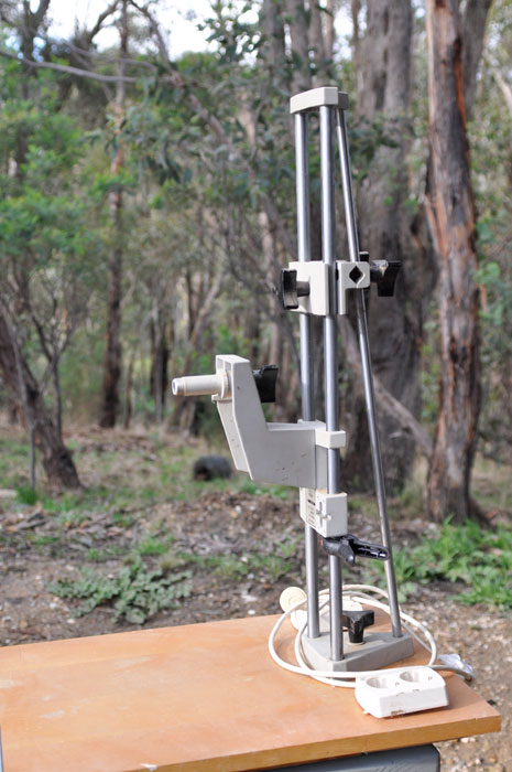

Just in case anyone may be thinking of making one like Lillian's, (which is a beaut'), I think you could get one together pretty cheaply and very easily using an old photographic enlarger.
Since digital, there's a million discarded photographic darkroom enlargers out there, I picked up 2 from charity shops for a total of $12.
You have a mounting plate for the enlarger head that moves up and down in a channel or on parallel rods. Usually adjusted up and down by a friction wheel of some kind. Just slacken off the friction and suspend the headplate (on which your trimmer is mounted) between springs that you could adjust to ensure the right amount of down pressure for a guide running on the top surface. Make sense? -I haven't made mine yet, (but it's gotta work!) Enlargers are nice precision built things.
-Jools
-Jools

As I said, I haven't actually got around to building mine yet,
but hopefully the pic should tell a thousand words.
Note that I've removed the friction wheel (it would be just above the plastic clamp) that makes the 'head' (the stikky out bit in front) rise and fall,- in prep for suspending it on adjustable springs.
So, mount trimmer and rig up guides, pretty well that's it ain't it?
That clamp arrangement towards the top could be used as the top spring mount, -adjustable because it moves up and down
-Jools
