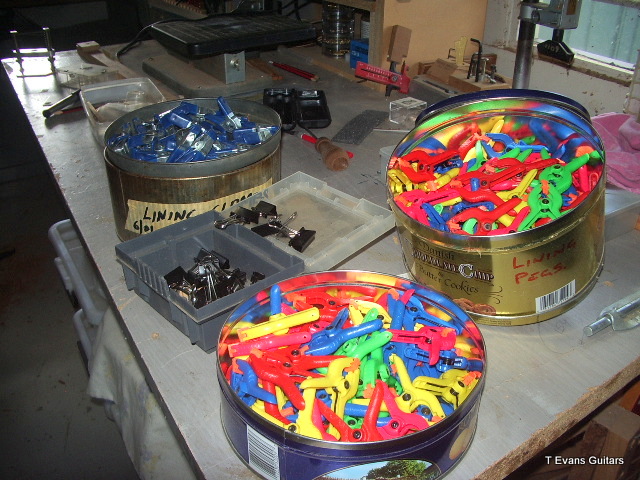

I had a bit of time yesterday so did an inventory of the clamps I have. I have three workshops and clamps to hand in each of them. So after the count I ended up with 157 assorted clamps and 30 hand spring clamps.
Among that lot are: 15 cam clamps, 53 spool clamp of varying sizes, 15 of those clamps that work like a caulking gun [indifferent sizes] and 3 boxes of little spring clamps as in the pic. That's what happens after years of repairing and building.
Needless to say no matter what job crops up there's a suitable clamp for it. Oh, I forgot to mention the strap clamps.

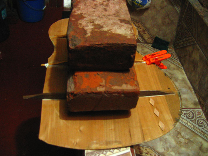

You're right. Here we go:DennisK wrote:And a few bricks for gravity clamping
This was an improvised repair I had to do three years ago in a little town at the Peruvian coast. I remember it as a "no-tool" repair.
These were two out of four types of clamps I used then. The other two were cotton string and masking tape. Actually you can even see that in the picture above I also applied the cotton string clamp...

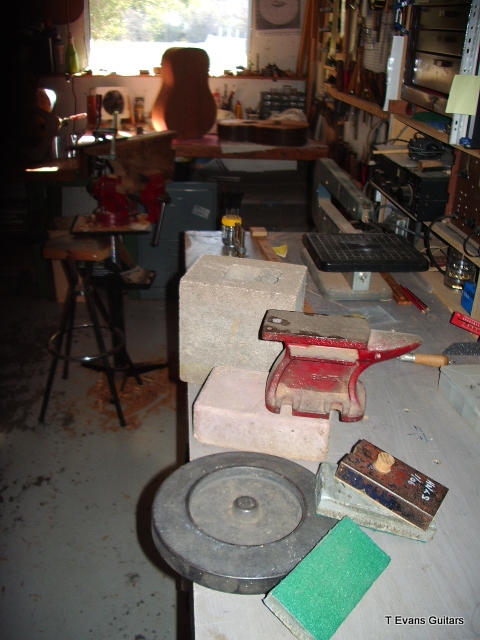

I suppose the heavier the reading the better the clamping pressure.
Talking of gravity clamping I forgot these that were under the bench. the deluxe models have felt glued the one side.
