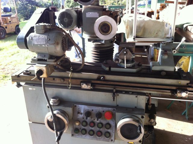

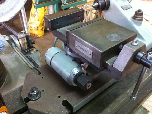

Hi Everyone, No excuse but these photos are part of the hold-up on the rosette cutters. My new Universal Tool and Cutter Grinder. Being able to hand grind a blade for myself is one thing but getting a result on a batch of blades is completely different. The geometry in the little blades is quite complex to grind accurately and repetitively.
To some this may look like overkill but I assure you it's not.This has more angle adjustments than you can poke a stick at and is a steep learning curve.It is big enough for surface grinding , cylindrical grinding and sharpening anything in the shed.With the hydraulic power pack it weighs in around 1400 kgs of lovely Russian cast iron. The manual is interesting.

Wow, that's a cool piece of machinery! :D
I hope you expect a great number of orders or this improved rosette cutter will get a bit expensive. :shock:
Localele wrote:lovely Russian cast iron. The manual is interesting.
Does this mean you are learning Russian right now?

That sounds cool. Not because of the price of the rosette cutter but imagining that you take your chisel to this machine instead of the two or three sharpening stones or maybe a Tormek is just, hmm, yes: cool. 8)

Interesting piece of hardware.
Kind of looks like a metal lathe but I can't really make heads or tails out of it.

Your not the only one Craig. It has so many adjusters it is confusing. Got to love it when the table adjustment for angles is marked down to 10 Minute intervals rather than degrees.

One thing I love about the old eastern block machinery is that they don't skimp on metal, a little rough on execution in places but they work and work well & will still be doing that in 200 years time! Nice buy Micheal. :cl

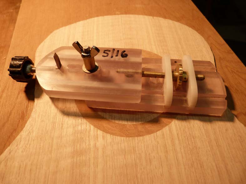

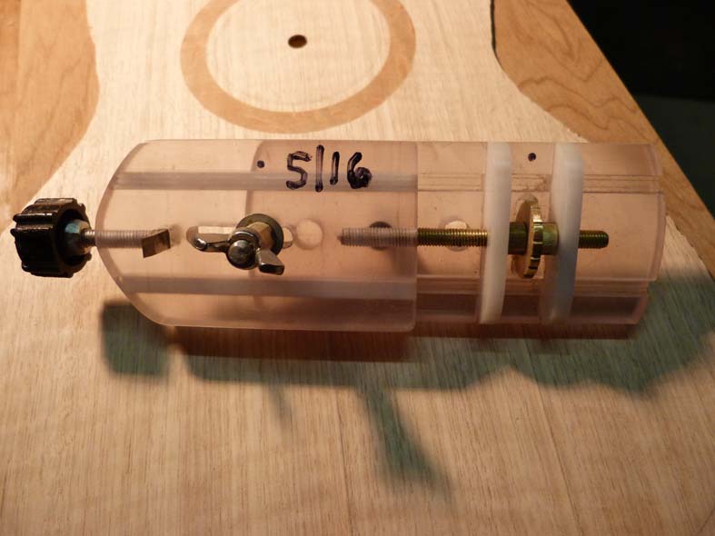

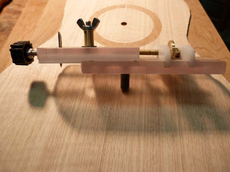

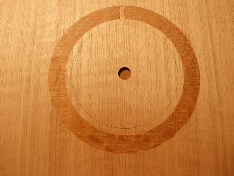

After reading this thread I got all inspired and decided to make a rosette cutter. Sorry, couldn't wait for that beautiful piece of brass machinery to hit the market.
Up till now I used a Dremel with a crude perspex base plate that I attach to the Stew Mac router base. I was never happy with it - adjustments were painful and time consuming.
So, here are some pics of what I built and what it does. I used some Lexan (polycarbonate) pieces I had. They slide using 2 perspex "rails" I inserted into one side with tracks cut in the other. Blades made from an old power saw blade. I made a scraper blade also. The brass comes from an old hinge and provides micro adjustment. The routed rosette slot is very clean - no tearout. Adjustment is easy and the process was pretty quick. The only problem I had was that the rosette itself seems to be smaller than the routed slot. It took 2 attempts to get the right size.

The screw for adjusting the radius is just what is missing on the cheaper commercial ones like the lmii one I have. Very nice.

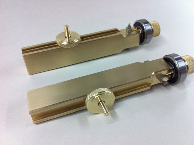

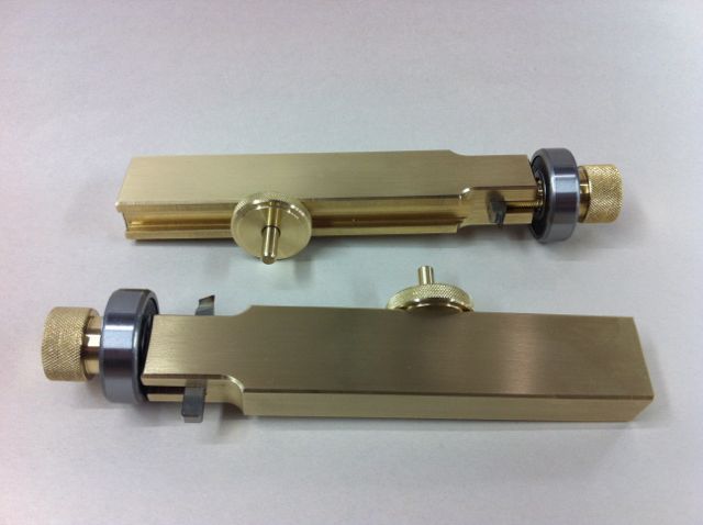

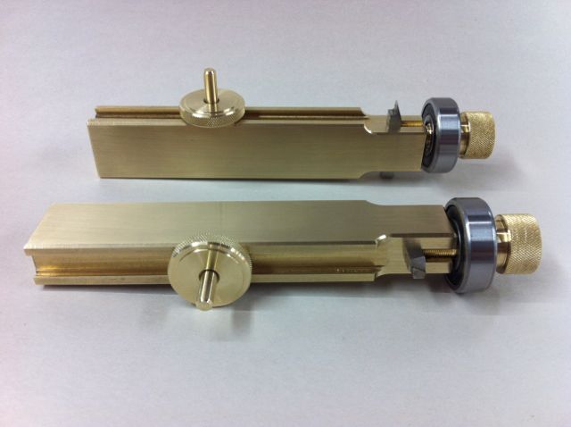

A few photos to explain the delay in the new tool. A total redesign but a much better tool as a result. I have to do the blades yet but will start them tomorrow.It will come with a knife blade , a 5mm wide inlay blade and a 30.thou. inlay blade ( for BWB lines).
At this stage the final cost is not worked out but I thought you guys might still like an update.
