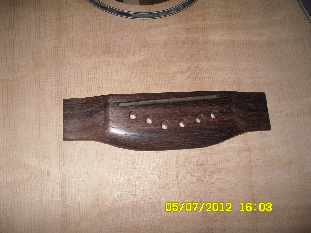

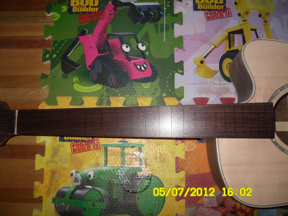

Hi everyone,
Thank you all for responding, all of the replies have been great & I guess it shows there's no single way to achieve a nice shine to you're bridge/fretboard.
I ended up taking Kim's advice, with the use of elbow grease and sandpaper (400 - 2000) and then a final buffing here is what I ended up with.
The EIR is just a natural finish, no polish or wax, the photo's are'nt that great but the finish is nice & very shiney, just what I was after.

Re: bridge & fretboard finishing
Hi again,
The date on the photos are wrong & should show 05/08/2012, camera malfunction.
Thanks again guys.
Thanks again guys.
Great to here things worked out for you Wayne, looks real nice.

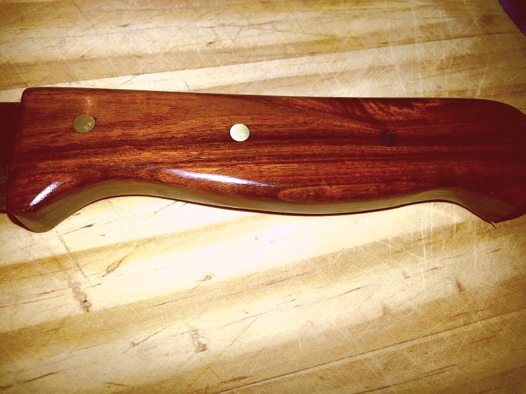

If you have not tried micro-mesh you should give it a shot, quite impressive results when used without any finish on 'hard' woods, and as mentioned, when used in conjunction with a quick wipe of Truoil the look can be quite classy.
Here's an image I just took with my phone of a malga knife handle (because I couldn't be stuffed looking around for anything else I have Truoil on). I made the blade of this knife years ago out of a worn out 15" power hacksaw blade using a linisher. The cutting edge is 9 3/4", perfect for filleting guppies. Its very good steel and takes a great edge, but it had sat around forever without a handle as just another useless unfinished project. So about a year and a half ago I used a bit of scrap Mulga to make this handle so it could sit around as another useless finished project..the guppies died a long time ago.
Back to the finish. The photo is not great but you get the idea. The Mulga was first sanded with Micro-mesh through the grits to 12000 and then followed by 2 coats of truoil, each being rubbed in and friction polished with my thumbs and once it felt dry, a rag was used to ensure no excess finish remained. Total time...10 maybe 15 min tops. It seems to handle getting knocked about in a big pointy thing draw with the cork screws, meat mallet and clever etc and it feels great in your hand as Truoil always does.
Glad it worked out for you Wayne and the results came up nicely, that top looks as though it's got a nice bit of bearclaw running through it
I'm more interested in where you got your Bob the Builder work mat from though
