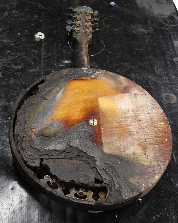

My process because from what Ive been told its close to 100 yrs old anyway, is to carve off the dead wood, then splice some fresh sections back on, and then shape it up. This way I can retain as much of the original instrument as possible
Will post an afterwards photo when completed, Its currently been stripped and placed into a high humidity box to try and get some moisture back into the wood, as its pretty dry at the moment. :lol:

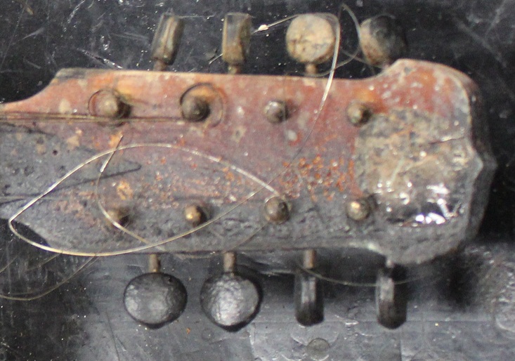

I joined a forum called madolin cafe, to try and see if anyone can recognise what model or manufacturer this might be, if anyone recognises the headshape, I would appreciate feedback

I know on the Slingerland(which this isn't judging by the headstock shape but that's not to say they didn't use different shapes through the years), that the back was a maple ply affair with the 'hump' being formed & held in shape by the fact that it was laminated rather than a carved shape & the outer layer was a birdseye veneer as was the final layer of the body ring. Yours ofcourse will be flamed.

There's a character that's posted a pic of a banjolin near the bottom of this page that has a shape close to yours, it appears to be made by a John Grey & sons, the burnt label on yours looks like it could be one of these?http://www.banjolin.co.uk/banjolin/grey.htm But then again? :wink:

Thanks guys, I posted as mentioned above on a mandolin forum and it appears to be a non descript banjo-mandolin that would have run with a local stores logo on it.
Makes sense.

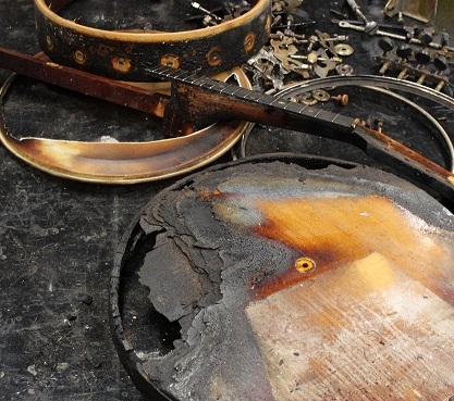

Either way, restoration has started. Lots and lots of bad wood been cut out so far, definetly a little bit of woodwork will be needed. :lol:
Re: Im a sucker for punishment
Post by Nick » Tue Aug 21, 2012 10:42 am
simso wrote: Lots and lots of bad wood been cut out so far, definetly a little bit of woodwork will be needed. :lol:
I'd like to nominate this sentence as understatement of the year if I may? :lol:
Looks almost like you'd be better off starting again :shock: . Hope you keep that shutter working Steve, I'd like to see how this Phoenix is resurected.

Stripped
Post by simso » Tue Aug 21, 2012 7:03 pm
As soon as you touch something, it looks good then dis-integrates

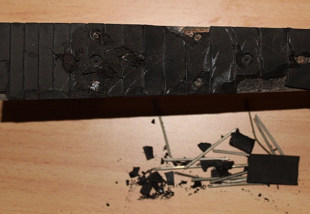

Post by charangohabsburg » Fri Aug 24, 2012 1:20 am
That looks like the only original parts be left will be the metal parts and a flimsy sliver of wood beneath the small part of +/- intact looking varnish. :cry:
And yet, there will be something original left, which is the main point of the operation as I understand. I wish you luck and patience. Without any doubt both, the owner and your customer will be moved by the result you will present.
