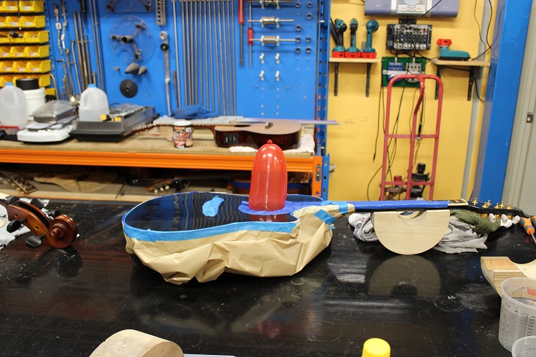

If your painting the top, avoid things like sponges in your sound hole, get a small party balloon and inflate it in there, works an aboslute treat.
Re: Top finishing question
That's what I do whenever I spray a finish - even works for 'f' holes.get a small party balloon and inflate it in there

Speak of the devil, one of my guys had to paint a top today, but he was rubbing the balloon a bit too much me thinks.
- balloon.JPG (186.4 KiB) Viewed 22355 times

simso wrote:Speak of the devil, one of my guys had to paint a top today, but he was rubbing the balloon a bit too much me thinks.
I use the ballon method after seeing Bob Benedetto shoving them in his F holes (
