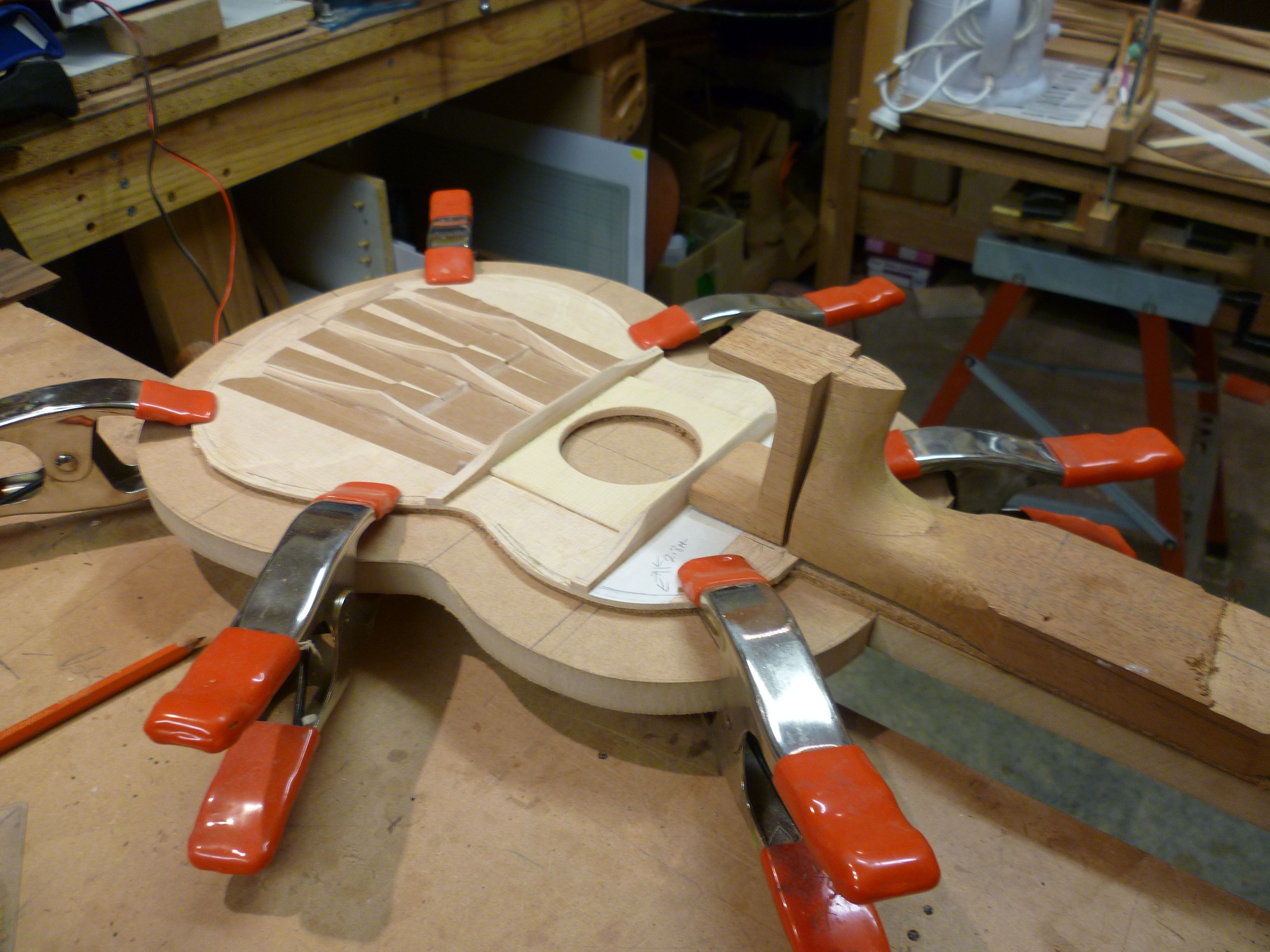

As far as I'm concerned, the only way to do this is the Spanish heel. Especially for a novice. Things that beginners really struggle with are addressed in my reasons for using this method.
Woods of choice are mahogany or Spanish Cedar if you can find it.
Several reasons to use the Spanish Heel on a ukulele.
1. Alignment issues are a thing of the past. No flossing neck cheeks to get yaw right. The fret board will always line up with the centre of the top.
2. A good tight fit of sides to neck is dead easy. No gaps, and no flossing to get the pitch right.
3. You can have nicely sloped shoulders on the upper bout instead of that hideous flat top that is too common on dovetail and bolt on neck to bodies. The flat top makes those joining methods easier, but you will never convince me that it's a good look.
If you've never done a Spanish heel, it can be something to get your head around. I cut the slots on my table saw, but you could use a well set up band saw or even cut them by hand.
You need to use a building board, but that doesn't have to be anything special. You will also be needing to build just about all your components before you even start to assemble anything. But once your components are made, the instrument will be closed up within a day easily, and you'll be looking at putting on strings quick smart depending on how you are going to finish it.
There are lots of building pictures in my website showing some of this if you care to look. Don't know if I've documented a complete neck build as it's not all that interesting to photograph and post for the client.
