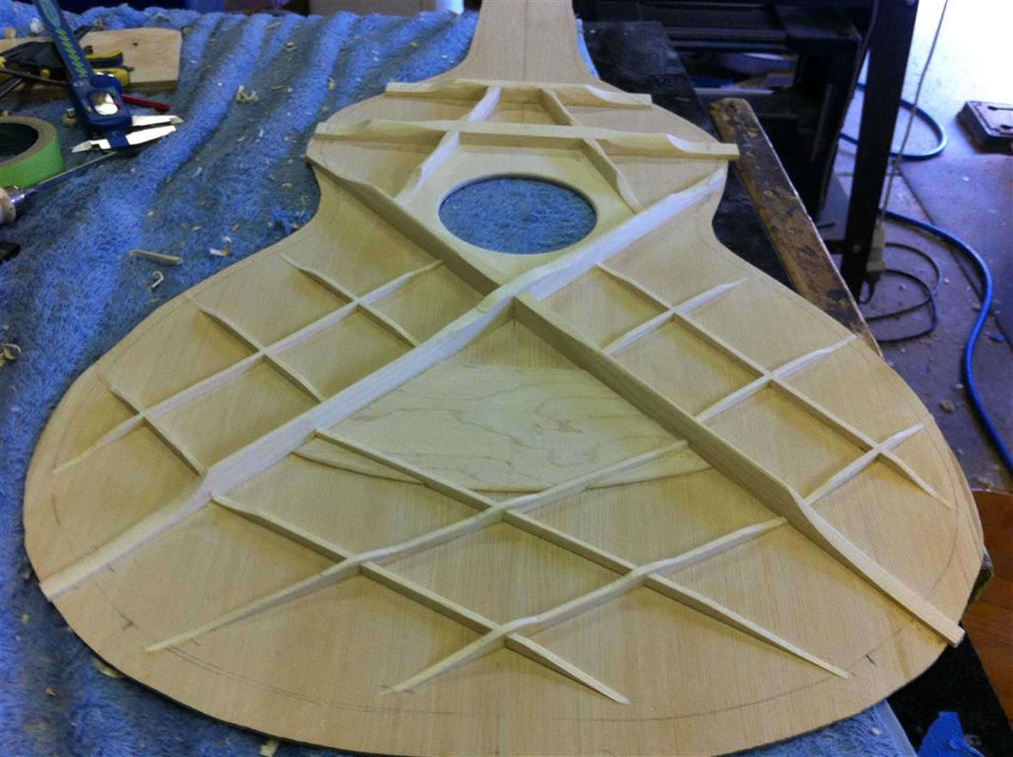

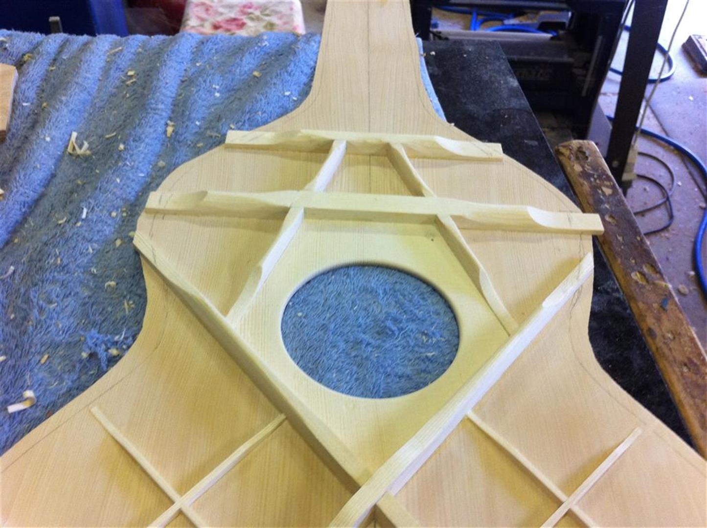

I would also pay attention to that area where the fingerboard meets the soundhole. I've been beefing that up with some carbon fibre on the bracing in that area. If you look at the pics below I am now glueing CF to the arms of the A-brace. The pic below was one of my earlier Weissys but I think the A-brace adds SO much more support for an instrument that will have a really high action.

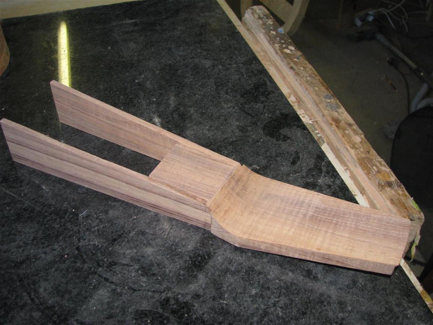

The other thing I changed was how the neck strengtheners attach to the headstock. I rebate the headstock so the neck strengtheners glue to the headstock, not just butt against it. I've attached a pic below.

As you can see from below my bracing is nothing like the Stewmac plans but it may give you a few ideas.

In the pics, I don't see the carbon fiber....am I missing something???Bob Connor wrote:I would also pay attention to that area where the fingerboard meets the soundhole. I've been beefing that up with some carbon fibre on the bracing in that area. If you look at the pics below I am now glueing CF to the arms of the A-brace. The pic below was one of my earlier Weissys but I think the A-brace adds SO much more support for an instrument that will have a really high action.
What are "neck strengtheners"? I've seen people mention them in some forum threads, but my plans don't have that --- they just have kerfed linings all the way around. Are they just some veneer glued to the neck area somewhere?Bob Connor wrote:The other thing I changed was how the neck strengtheners attach to the headstock. I rebate the headstock so the neck strengtheners glue to the headstock, not just butt against it. I've attached a pic below.

Unfortunately I don't have any pics of the carbon fibre but I have recently started adding 1/2" x 1/8" carbon fibre strips to the legs of the A brace which is situated under the end of the fingerboard. I use epoxy to attach it.
I have seen a couple of Hawaiian lap steels where the sides have warped inward after they have been built so I would suggest including those neck strengtheners.
