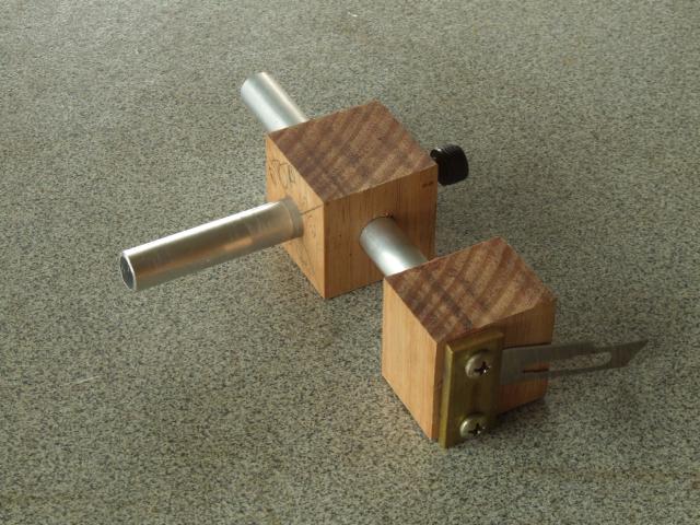

Not that I was in the market for one of these, but the micro screw adjust, to me, was the differentiator that would allow you to charge what you'll need to charge to cover your costs on this. It seems to me that what you have now is a lot more glamorous, but little more effective, than one of these:
Circle cutter.jpg (69.23 KiB) Viewed 35203 times

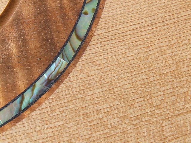

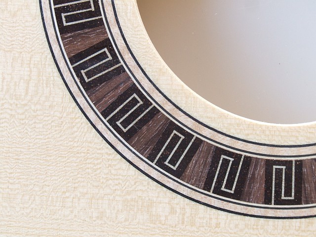

We all work in different ways and so have different priorities in our tools. The micro adjust was important to me so I built this:
Circle router.jpg (97.95 KiB) Viewed 35203 times
It's a bit OTT, but the sliders run in linear bearings and the screw adjust is zero backlash. A tenth of a turn gives me 0.1mm radius adjust and a tenth of a turn back takes it back, exactly back, every time.
Makes this sort of stuff a lot easier to do.

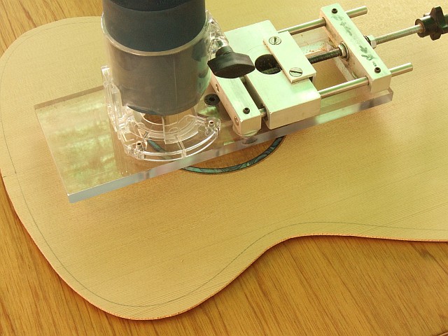

And for some insight on how I use it there are some photo's as part of Building Honey's Uke. For me the perspex template is the way to go. Easy to make, and as you can see in the images, very easy to use for the layout.
That rosette was done with nothing more than the rosette cutter with the supplied blades, and a scalpel to slice cross grain on the stopped channels.
