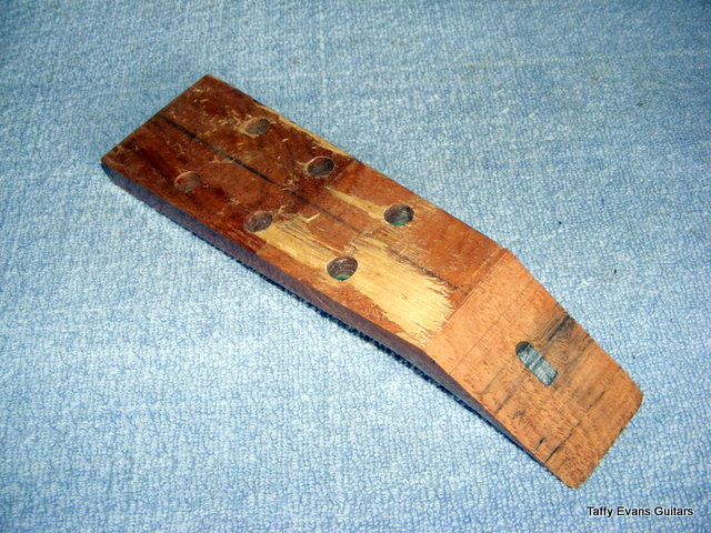

On the square neck reso's that I have built over the years I have not used adjustable rods, but I have used carbon fiber or steel bar reinforcement, as mentioned above.
Some time back I had to replace the headstock on one of my square necks as the customer dropped the guitar. I'm glad this one had the carbon rod installed. I did not know until I had cut off the old peghead that I had cut through the rod as well.
