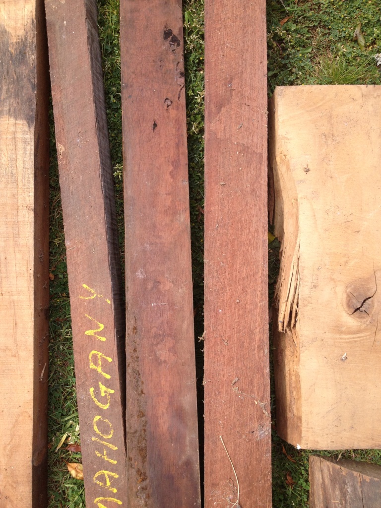

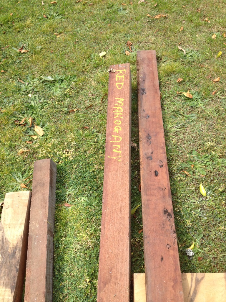

Post by Nick » Fri Sep 21, 2012 1:27 pm
geoffrod wrote:Hi all,
Just going thru some of the father inlaws wood, have come across some red mahogany posts
Some black heart sassafras slab, and some other stuff, any of this any good?
I will try uploading some pics later
Posts, if they are cut ok & don't show much sign of cracks (I imagine as your outlaw was a wood turner it would be nice stable stuff), could make some good neck material & the Black Heart (again depending on how it's cut) makes for good back & sides, depending on the size of the slab either for Guitar or Ukes. Not too sure about "other stuff" though Geoff, maybe cut into veneers & turned into other stuff rosettes? :lol: Pics will improve your choices :D

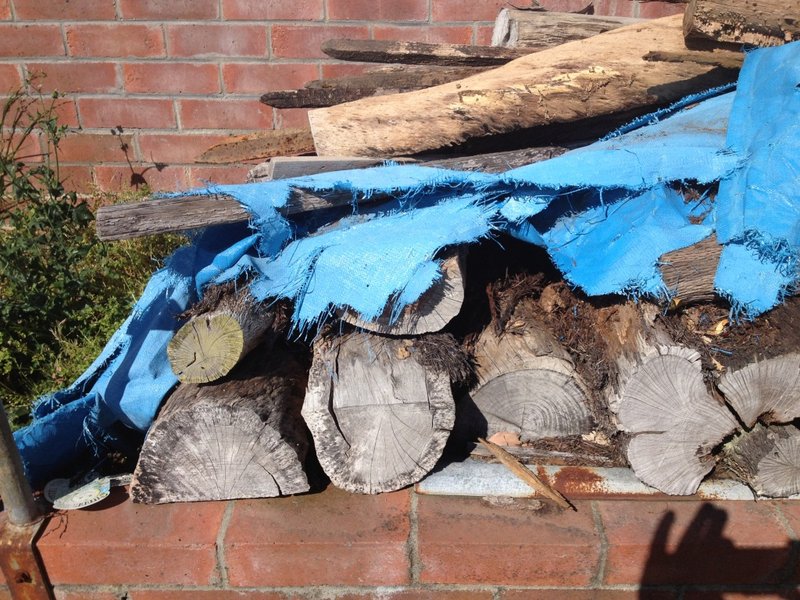

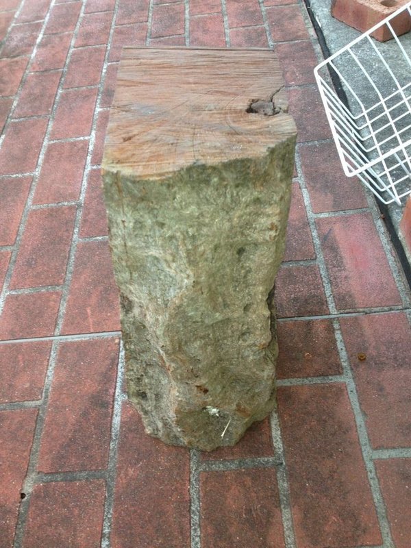

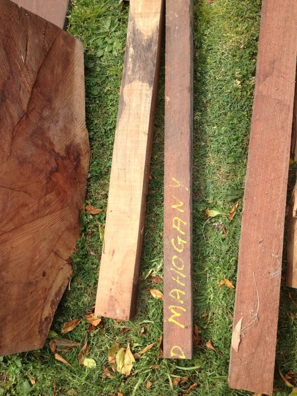

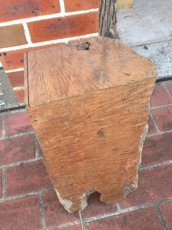

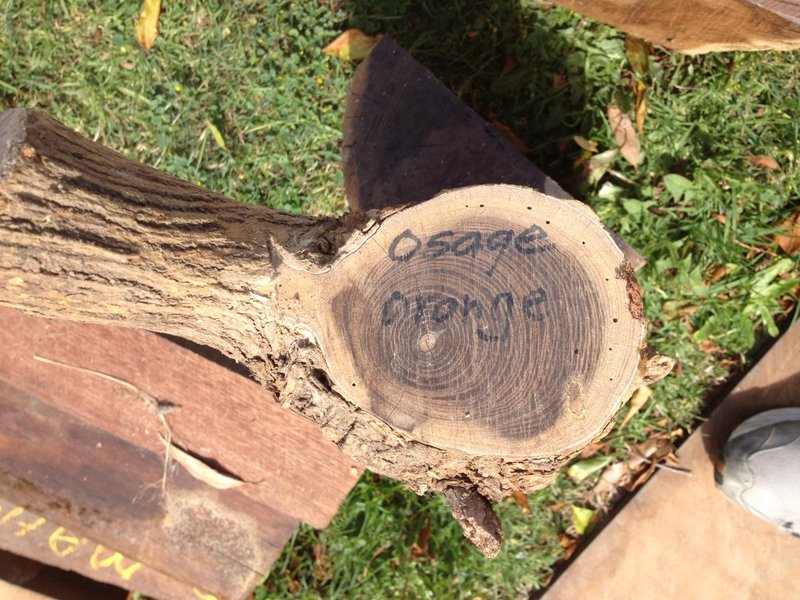

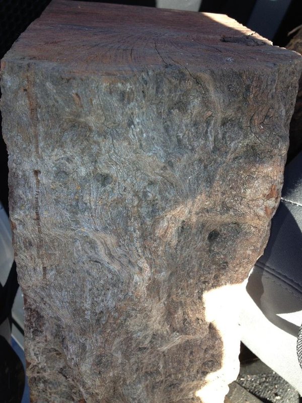

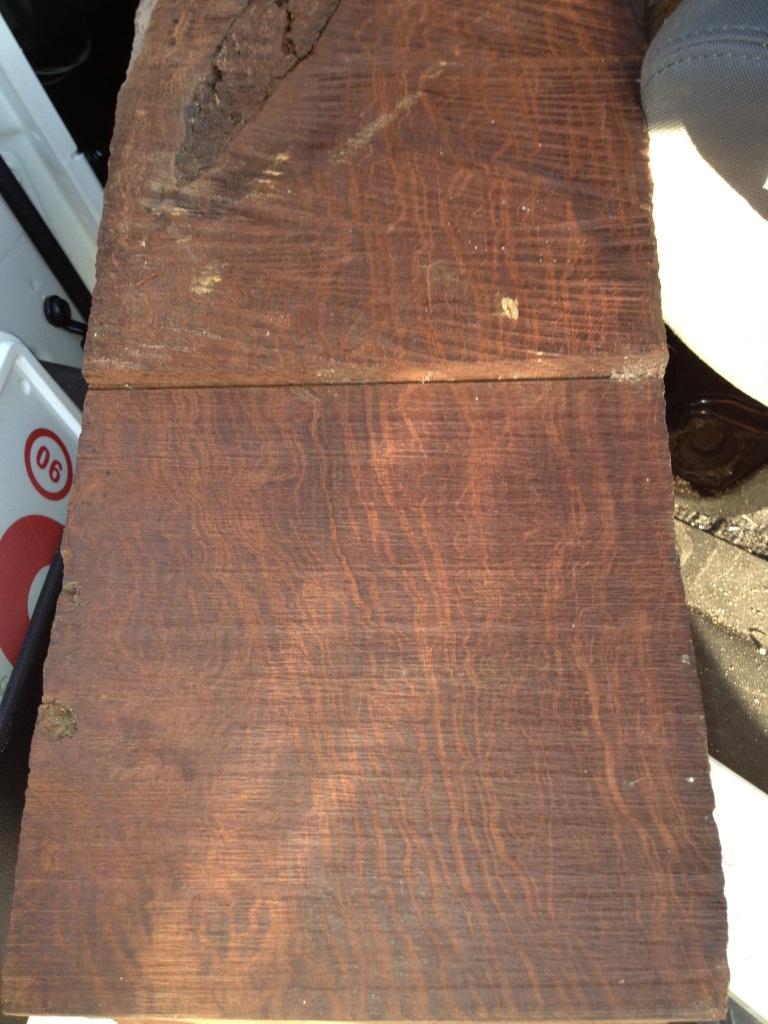

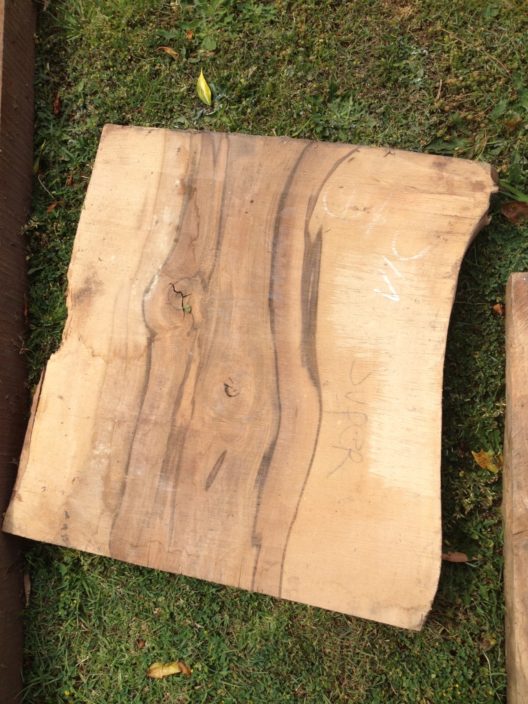

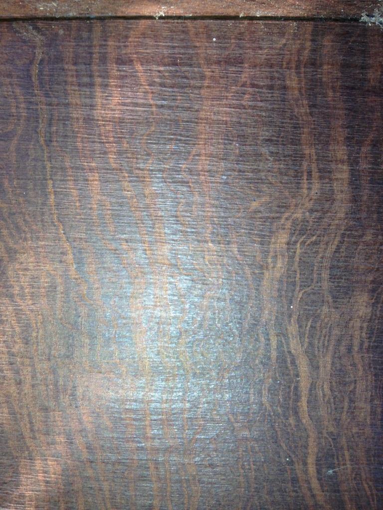

ok here are some pics
there is-
hairy oak
mexican pine
osage orange
silky oak
red mahogany
blackheart sassafras

Hi Geoff.
Most timber can find a use somewhere... Even as inlay or veneers.
Electric guitars are a lot less constrained than acoustic timber choices. Most of your mentioned species could be used with care, but that is going by species rather than by "piece in hand" which is what you would need to assess.
As mentioned already, Gidgee is a great fretboard material for any instrument. Camphor has been used for solid bodies as well as acoustic back and side material - you have the smell to consider there though. If the "light coloured cedar" is Western Red Cedar, than the right piece could be used for soundboards. Hairy oak is quite decorative and could certainly be used for electric body caps. Blackheart sass is used by many for solid and acoustic instruments - I think you get the idea.
Nice score and good luck with your building.

Post by Bob Connor » Fri Sep 21, 2012 9:57 pm
Geoff
The Osage Orange will make fantastic bridge plates. It's very similar to Brazilian Rosewood tonally.

Post by Kamusur » Sat Sep 22, 2012 5:24 am
Geoff, you have some nice wood there and Jeremy is right about finding a use for most of it. Been working with some Camphor L this week and found it was just so unstable, but my mate cut some Jacarandah for a guys lapsteel and it was a really nice piece of wood.

thanks for the info bob.
i wasn't sure if osage orange would be any good for fret board as well?

We have a lot of osage orange here in KansasCity , the us midwest, it makes great FB and bridges, wood is prone to tearing with planes.It can also be stained ,radially it can be used for rosette inlays, bridge patch, used by local indians to dye wool.

Post by TimS » Sat Dec 15, 2012 1:20 am

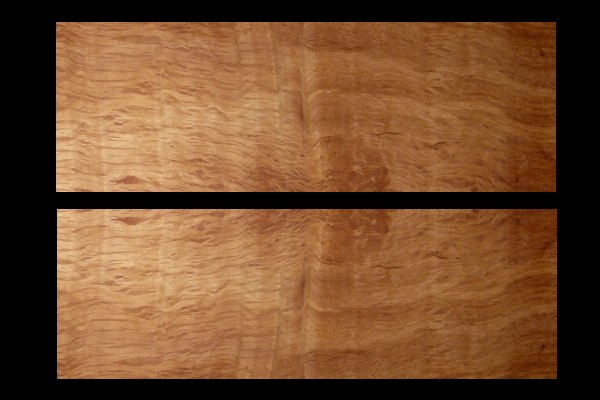

Hi Geoff,
I think you are looking at a sheoak (lace figure) allocasuarina. From the end you can see the typical dominant medullary rays.
regards
Tim
