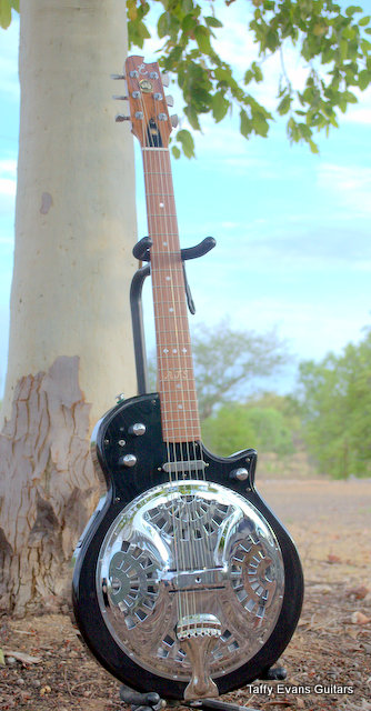

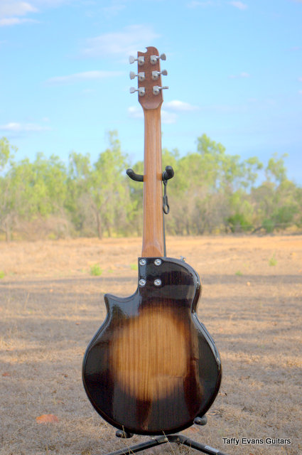

As can be seen it’s a Resonator guitar, electric/acoustic solid body. It is made of all New Guinea Rosewood except for the fingerboard which is an unknown [to me] hardwood. The customer wanted me to use timber that his late father had stored in his shed for many years, but on getting amongst it we found that somebody had beaten me to it and a lot of the good stuff was gone. But as it turned out the customer wanted a solid colour on the guitar any way so that did not really matter. I do not like solid colours as I like to see the timber/grain so a compromise was struck with a sunburst effect on the back complimented by the natural look of the neck.

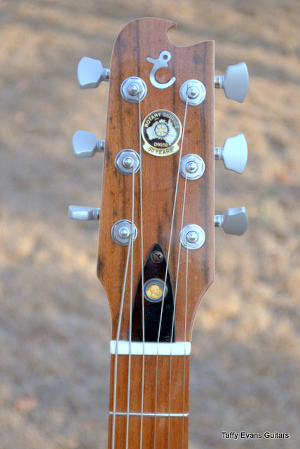

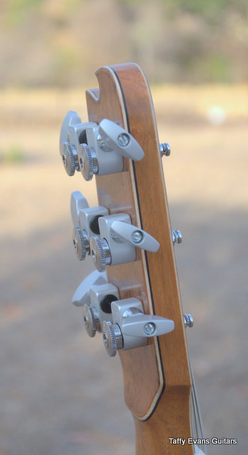

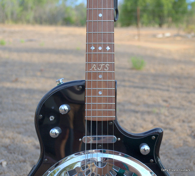

Instead of my usual pearl inlay on the headstock the customer [as the guitar is in memory of his father] wanted two of his dad’s service club badges used instead. Locking tuners were also used. The controls include a blend pot for the bringing together of the acoustic and magnetic pickups, also a master volume and tone pot and 3 way selector switch. The AJS inlay is his father’s initials and is in Maple instead of MOP, as the customer wished.

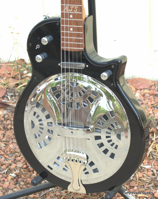

I thought the guitar sounded awesome both full magnetic, acoustic Reso and the mix of the two was a real pleasing sound with the brightness of the cone pickup blended with the P90 warm tones of the magnetic neck pickup.
