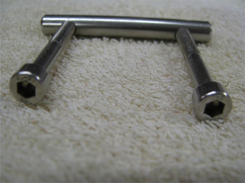

Here's what I use Rod.
Vastly superior to anything else I've tried. I get a mate to make up the shafts and the bolts are 5m stainless available from any good fastener shop. You should be able to a local fitter and turner to whip some up for you. I 've just got a few from my mate so if you want one for your perusal let me know and I'll send one through.

Bob Connor wrote:Here's what I use Rod.
This should be fairly easy to whip up on your own with a mild steel rod, drill press, tap and grinder (or steel cutting saw). I'd say a couple of hours of work should yield enough of these for a few year's worth of guitar builds. Anyone who's ever built a truss rod should be able to make those bits.
