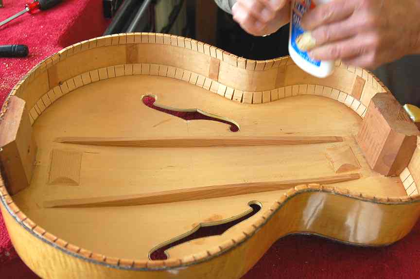

FWIW, John D'Angelico sometimes used cleats (.. so the D'Aquisto reference wouldn't surprise me). They show up periodically during restorations.

Far be it from me to criticise such accomplished builders but, in the example you've shown Dave i can't see the point of fitting a cleat so close to the neck and tail blocks and none along the rest of the seam and to me those " cleats" look more like blocks, I think that if supportive cleats were to be added to a soundboard they would be spaced at equal intervals along the seam, made as small as possible so not to hinder the performance of the plate but shaped in such a way that it is strong enough for the purpose it's being added for.

It would seem to me that the F holes would provide a free edge to avoid the plate being restrained laterally, so the centre seam should not be a troublesome area.
Most cracks seem to occur running into the f holes.
Agree on the location of those large cleats, they seem pointless.

I think Michael Lewis had the best explanation ...."my guess at the center seam reinforcements near the blocks is that those areas are most prone to separation due to plate deformation from constant string tension. When the strings push the bridge down on the top the top responds by pushing up somewhere else, like between the bridge and tail block. The cleats have fairly large surface area so they have a lot of shear strength holding the seams together."

It's an interesting topic. In his book, Benedetto mentions that he frequently saw cleated D'Angelico guitars when he was doing repairs. For a time, he followed suit with his own guitars. Then he came to believe that perfect joints, well dried wood and optimal building humidity eliminated the need for cleats. However, Benedetto sometimes does install a nearly full-width cross brace near the tail in the lower bout. From the photos I've seen of the D'Angelico shop, it is very doubtful that he was able to control the humidity in the space. It's possible that he cleated some instruments as a safety measure after having just a few joints fail. Obviously, he's not around to ask, but two of his cleats are right there in Dave's photo. I frankly don't know the correct answer to this question and I suspect there will be many differences of opinion. However, if it works for you, I see no reason why you shouldn't use it. I don't cleat. If I did, I'd probably do it near the ends of the f-holes.
