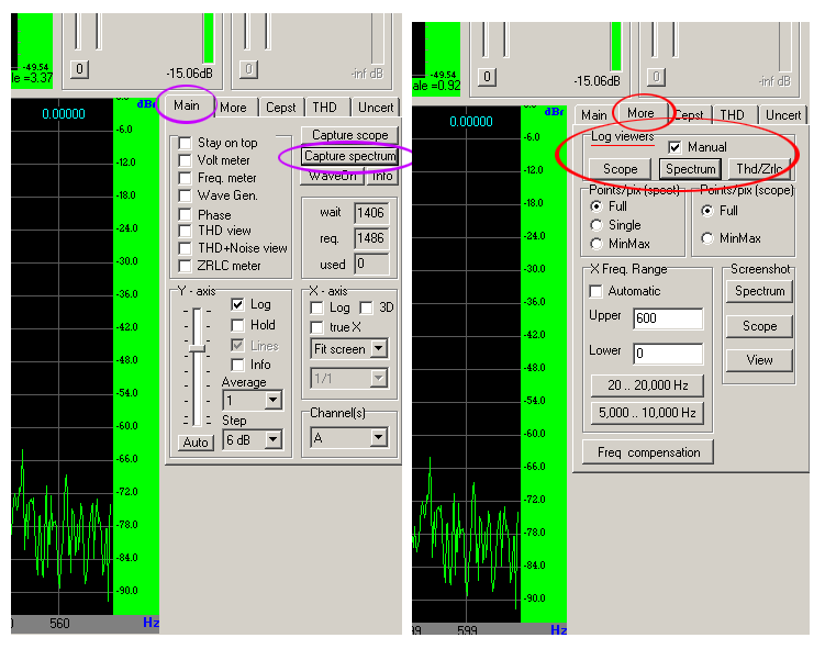

A few people have asked me how to set up Visual Analyser and then how to capture data. I am by no means an expert as I only worked out how to get good results a few days ago. So if you see anything wrong and there is a better way of doing it please us all know. But here is how I have done it to get decent consistent results.
First we need to set up VA. Click on ‘setting’ at top left.
Under the ‘main’ menu
1. set your FFT rate to 16384
2. set your frequency sampling to 11025
3. click confirm and the spectra line resolution should change to 0.67Hz
4. Next go to the 'capture' tab and set the capture spectrum - spectrum average buffer to 10. There is capture scope window on this page as well so make sure you set capture spectrum.
5. save your settings. Apparently you can save these setting as default but I have to redo them every time I open VA so check before you start a new session.
Next test your mic
6. turn VA on with the button at top left.
Now check you are getting decent sound levels. The lines on the charts should be jumping all over the place from you voice. If you make a noise into the mic you should see it spike on the charts. If so all is good but if not you need to go to your sound card settings in windows. Set your mic boost higher until you get a decent response on the main chart.
You are now ready to capture data but first do a dry run so you can practice your taps. Nice consistent force and nicely timed taps are best and avoid the centre line. There are spots that sound louder for a given tap force so I try to tap on those spots.
7. Get your guitar ready with your tapping stick and the mic pointing at the soundhole. Trevor mentioned sitting on a chair with the guitar or just the body on your knee and I found this the easiest. Don’t damp the back of the guitar with your beer guts. I held the body by the neck mortise.
8. When you are ready, with VA still on, click the capture spectrum button at the right centre of the screen and start tapping your 10 taps with about 1.6 seconds between. Don't do it faster or you will get weird results. Going slower seems to be OK.
9. Keep tapping and when VA has recorded 10 buffers of data it will pop up the spectrum window with your completed frequency spectrum. You can then select the range up to 500Hz and it will zoom in.
10. You can save this as a text file then copy and paste it from there into excel for further analysis if you want.
You are done.
As I said, please correct me if I am wrong anywhere but I am getting consistent results using this method.
Hope this helps all you budding scientists.

I think you are using a later version of VA than I normally use (I use v.9), but iirc, the .tee files open in VA as a "live" file, much like the live spectrum capture window.
If you click on "File" in the spectrum capture window you should have options to save as a .txt file, (just a list of numbers that can be imported to Excel etc.) and in v.9 at least, that also saves a .wmf file which is just a "dead" screen shot of whatever you have in the capture window.
The .wmf file will open in the default Windows picture viewer, or you can convert it to another format (e.g. .jpg) using an app such as IrfanView.
If this doesn't make sense, someone using one of the later versions will likely be along soon.

Trevor has already explained it. But if you don't yet have opened (from the capturing process) the "spectrum capture window" (which you need to have the file menu available) you can open the saved .tee files by selecting the "More" tab in the lower right area of the VA screen and hit the "Spectrum" button as per the attached screenshot, on the right:
I am using VA version 2011.

I'm using VA-11 and I don't see the option to save as a .wmf file, only .tee or .txt. , but maybe it is there somewhere. No big deal, I can use Alt+PrtScn to copy to clipboard, pasting into a graphic program and save as .jpg if and when I need that. For now .tee files and the ability to call them back up is what I need most of the time.
The opening of .tee files works just as you suggested Marcus, thanks for the instructions and screen shot.
- Posts: 1643
Re: Setting up Visual Analyser and capturing a frequency plo
Craig, in v.9, when you save as a .txt file, you automatically get the .wmf file (actually listed as .txt.wmf) so it's not an option, as such. v.11 might do the same. Just go looking for the .wmf file in the same place as the .txt file and see if it's there.
- Posts: 195
- Location: Drayden, MD, USA
Yes, it works that way in VA 11, thanks.

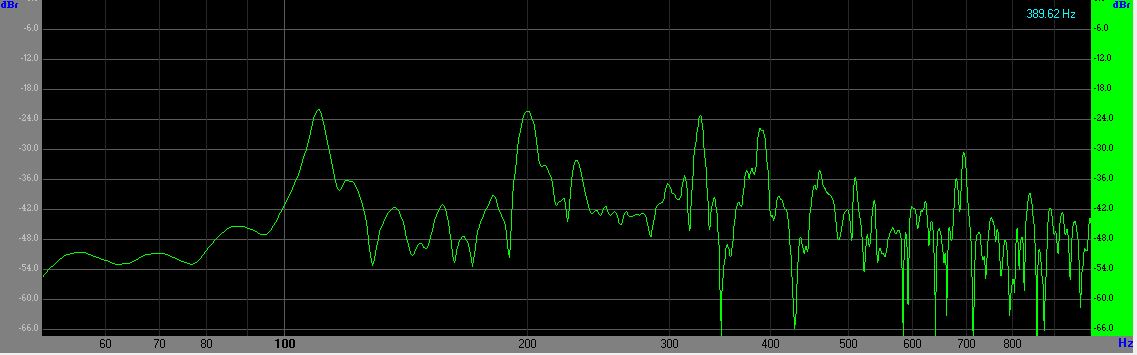

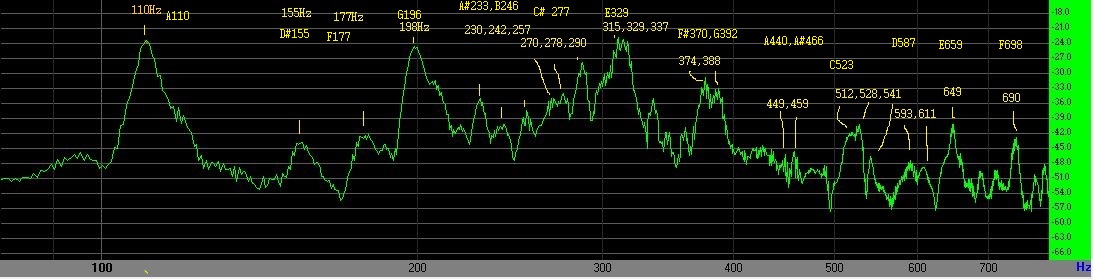

I would like to see a function in VA that allows the user to mark the frequency on each peak rather than just one at a time when you click the cursor over the peak.As an example, here is a snipping tool screenshot of a cheap Martin 0015 mahogany top with the peaks marked one at a time using "Paint". All comments welcome re the placement of the resonances in said Martin! Also, my old 1956 Maton Premier 45A archtop.

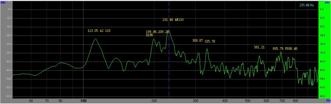

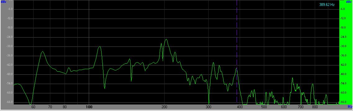

Re posting-a better version of a terrible tap!
Also, I held this guitar at the neck where it joins the headstock. I believe we have, on the lowest frequency, the neck mode? Obviously I am new to all of this!These frequencies on each VA sample, seem to move around a bit...I have done some tea leaf reading, and confirmed the main ones. But this guitar is a little difficult to get good results from, being factory built, but it still had a characteristic Martin sound. I have concluded that the guitar is just stiff and the braces roughly shaved in a factory, the tea leaf patterns are not very even...The reason I am doing this, is as a preliminary to bracing my first soundboard,shaving braces and closing the box!All comments, help,opinions,guidance etc welcomed!

Alex,
For tap testing I get best results are with the guitar held in playing position and the mic around 200mm from soundhole. I hang my mic from the ceiling and sit on a chair......distance from mic to guitar can be adjusted simply by moving sitting location.
For Chladni work I get best results with poppy seed.....
