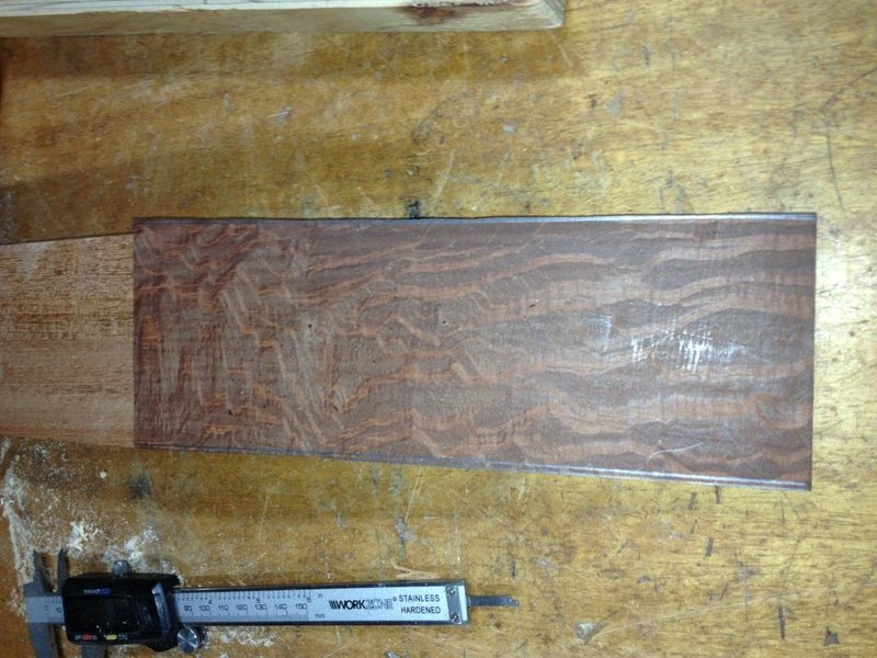

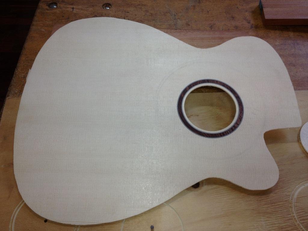

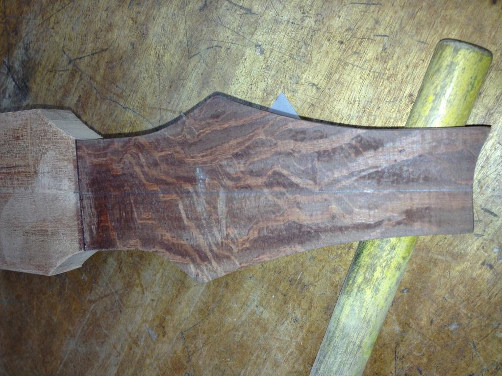

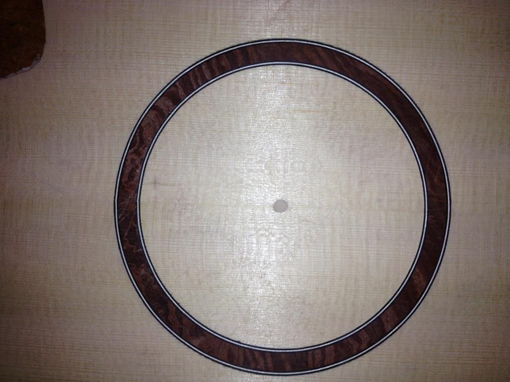

Just a little update,
going to post a couple of pics of the use of what could be sheoak.
im hopeful it will look good when finished.
regards
Geoff
rosette set.
rosette set and sound hole cut
neck blank with headstock face plate added
finished shape of headstock

The large block shown in the last couple of photos is near on certain a 'She Oak " , which is to say a Casuarina or Allocasuarina . The good news is the block is clearly quite figured , with a heavy lace type figure . It most resembles W.A. She Oak , Allocasuarina fraseriana but it's pretty hard to differentiate from photo's alone . Weighing the block , and determining the vloume would give you a kg per cubic metre calculation . There is a heap of variation in the weight of the she oaks . Buloke is another possibility , I've milled plenty with that type figure , the difference being it is much heavier than W.A. she oak . There are a whole heap of other she oaks in between .
