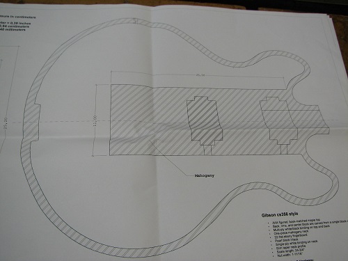

I got some plans some time ago from guitar granny which are perfectly adequate for building, they don't have every dimension or profile shape with regards to the body contouring but there's enough to 'fill in the gaps', you can't go wrong with them if you used them & they are 1:1 scale if you really got stuck & wanted to chance it.

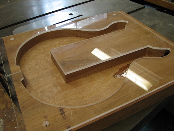

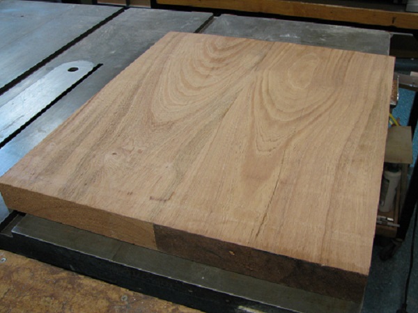

The back and sides are hollowed out from a solid piece, Gibson uses Mahogany but the 'proper' stuff isn't available over here so I've used Sapele, just as good! :D two bits of 200mmx50mm glued together & run through the thicknessor to 42mm

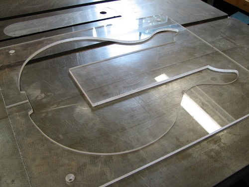

I then made an acrylic pattern for my pattern bit to follow when routing out the body chamber,
Had to fit a couple of 'outriggers' to my router's base so I could rough out in the lower bout area without the router falling in! Removed them for the final finishing of the walls.

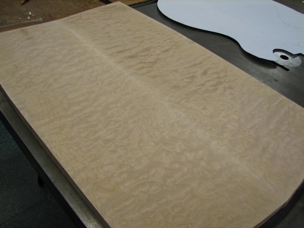

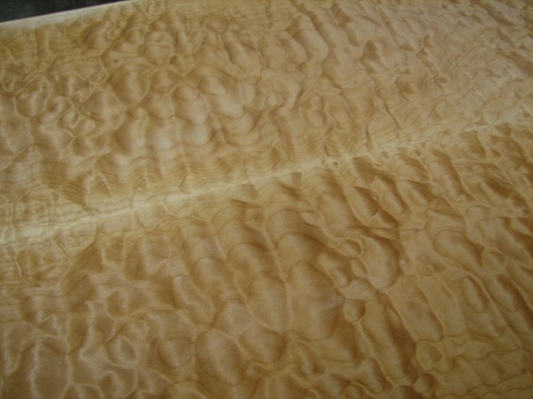

For the top I got a couple of fairly "plain" bits of bookmatched Maple from North Ridge Hardwoods.
Fairly ordinary Maple.jpg (69.89 KiB) Viewed 47125 times
This stuff was in their private bin and cost a fair few $ but boy was it worth it!
A spritz of Methanol and it pops
The top "laminate" finishes up at 17mm thick.

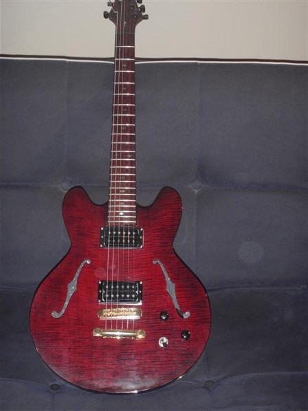

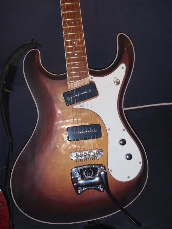

I am just finishing 2 of these. I'll get some pics up. I love the open sound. I've had one strung up for a month or so now, it has humbuckers. Sounds quite nice acoustic as well. The other one has HH S S pickups that I am winding myself. Just making face plates for the winder and off i go.
One problem with the design is the cutaway is a little tight to get my hand in there comfortably and fret chords. Its probably done so it looks very ES'y but it does not work well from a player point of view. I am going to change my templates and make the horns more open, perhaps narrower with wood removed from inside the horn. I just love carving stuff so these are easy to pop out.
Just finished a Ventures Mosrite copy with P-90s and an old style vibrato. Cool guitar and it has lots of carving, which I love btw.
CS 016 (Custom).JPG (69.71 KiB) Viewed 46848 times
Not as washed out in real life

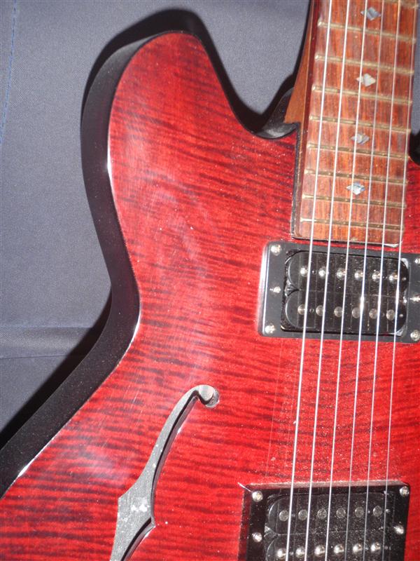

CS 012 (Custom).JPG (104.92 KiB) Viewed 46848 times

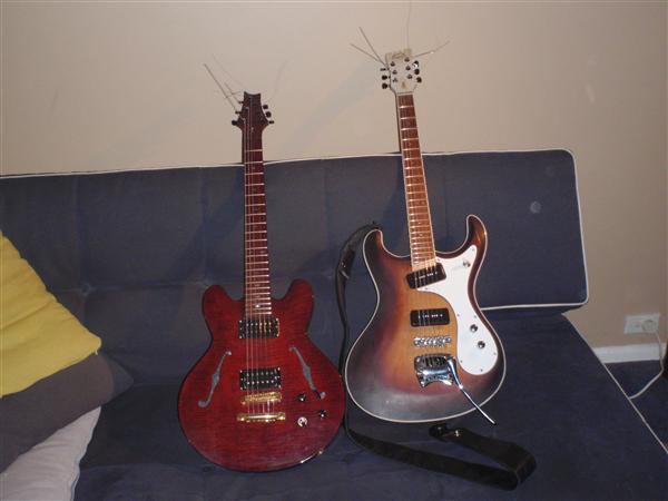

This is the first one, mahogany neck and cocobolo FB. Fun to play.
CS 011 (Custom).JPG (73.86 KiB) Viewed 46848 times
CS 013 (Custom).JPG (62.47 KiB) Viewed 46848 times
Mosrite copy. Its put together so I can play it and check the final fit before it gets final coats of nitro and then buffed. Real nice to play, both sitting and standing. And its such a funky shape.

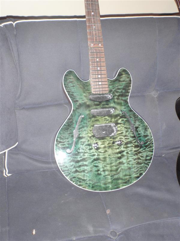

The Green top isn't too shabby in the figure department.

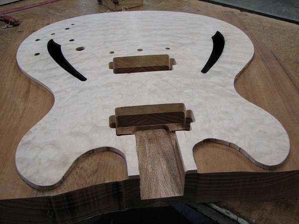

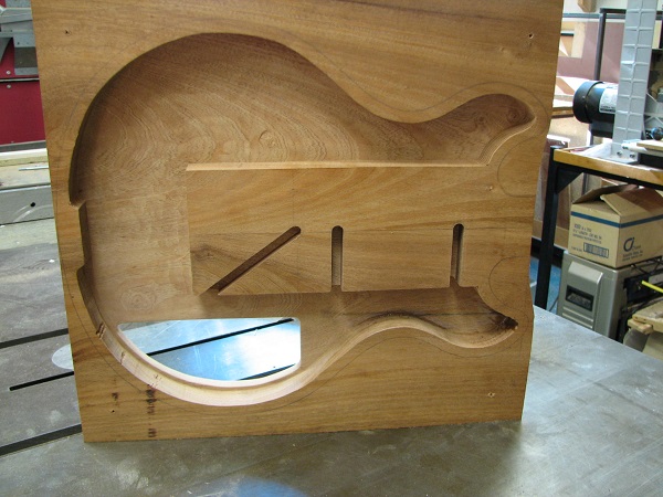

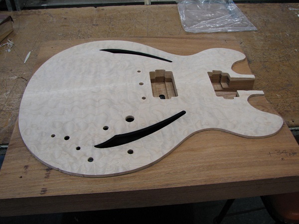

I mapped out where the pickup cavities will fall on the central block and machined slots for the wiring, much easier to do now before the top's glued on. As with most Gibson hollow bodies the CS's, the pots e.t.c were originally wired outside of the guitar and the whole,completed assembly fed in through the F hole but because I've got a few extra goodies under the hood it was going to be a bit of a nightmare so I decided to make an access cover from the back so wiring & maintainence would be much easier.
Body cavities.jpg (108.58 KiB) Viewed 46699 times
The rear angled slot is for a T Bridge, I've decided to include an 'acoustic' option. I've never heard one of these before so it'll be interesting to hear how close to acoustic it does actually sound.

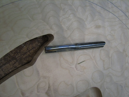

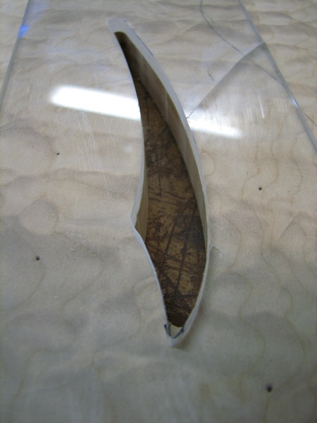

On the top I machined the 'F' holes, decided to go with the nike swoosh style rather than the traditional F style. I made an acrylic pattern and drilled out most of the excess before going in with a 1/4" Straight fluted router bit, I used the shank of the bit as a pattern follower, as I found with the rosette patterns I did on the Maccaferri, as long as you keep the router moving and don't let it rest to build up heat against the Acrylic, it seems to work quite well.
F hole.jpg (80.78 KiB) Viewed 46699 times
Straight bit.jpg (58.93 KiB) Viewed 46699 times

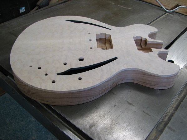

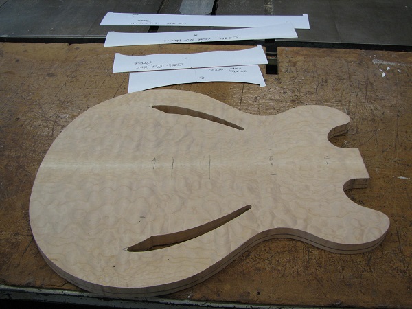

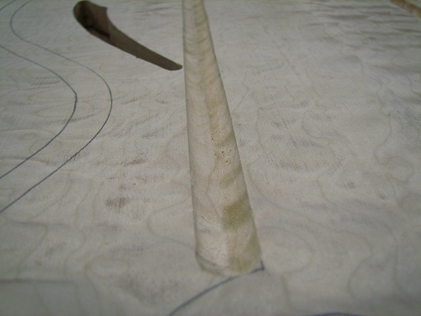

Flipping it, the top over I machined a tapering groove to outline the central solid block. It was tapered in depth, to match the final shape of the top
I then bandsawed out the top close to it's finished size.
The cardboard are profile patterns for the top, which I actually ended up only using one of :roll:, the longitudinal one, because once I had that shape in and the final 7mm thickness marked around the rim, the rest of the shape just seemed to fall into place. Outside profile done(I tried to take some photos of this profile but it's so thin and subtle that it didn't really show up in the pics so I haven't posted these).
Then using a pin for the top to rest on and drill set to drill to depth (7mm final top thickness), I set about drilling away most of the excess on what will be the inside. Then attacking the 'extra bits' with a curved palm plane I've managed to get the outside profile reproduced on the inside. Here, I'm part way there on one half, I was running out of time on Friday so the other half is still waiting to be done.
So that's where I'm at at the moment, I'll post more pics up as I proceed. :)

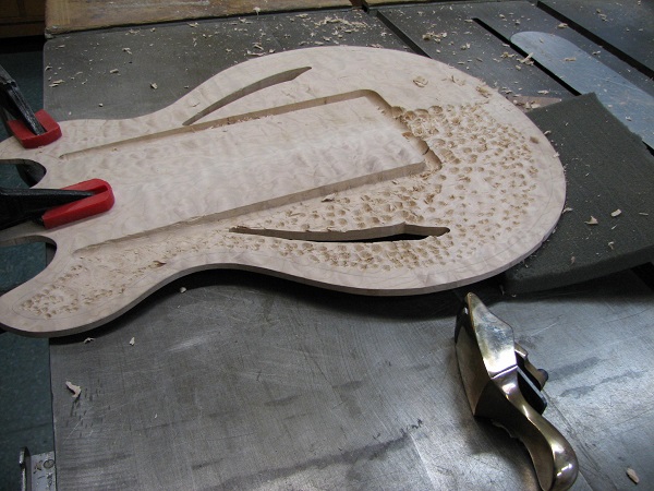

Your palm plane looks like a beauty. What kind?
Re: Gibson CS356 build
Post by Nick » Mon Mar 18, 2013 8:45 pm
P Bill wrote:Your palm plane looks like a beauty. What kind?
It's a D'Angelico Bill (LMI sell them) a little hard on the ball of your hand when working on Maple (I usually end up with a decent blister after shaping an archtop back) but you could probably add some padding or something. The thing I like about it is that by setting the blade ( a Hock brand) out by a reasonable amount you can take varying depths of cut just by adjusting the angle you hold the plane, hold it at a low angle and you can really hog out the wood but lift it slightly and let the front of the plane run on the wood first and you can just take a fine shaving.
Post by rocket » Mon Mar 18, 2013 9:31 pm
Nick i wear a leather riggers glove when bulking out an arched plate, helps reduce the blister factor.

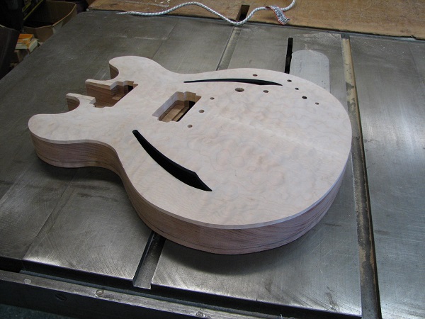

Ok a little more progress has been made! Looking more like a twanger now. I finished scooping out the excess in the top and tidied up the 'points' on the f holes.Drilled all the necessary holes for the various pots & switches. Once this was done everything that was going to be on the inside received a coat of sheilding paint to stop any excess hum/interference, so all that "nasty water staining" has disappeared on the inside at least Marcus! :wink:.
Once the paint had dried the top was glued permanently to it's new Sapele partner and all the Pockets were machined into it as well as the holes for the bridge bushings, the 8mm hole was drilled centrally for the T Bridge wires to run through and into the slot previously machined into the Sapele centre block. I cheated here and used a milling machine as the neck pocket has a 4 degree angle on the bottom so that the neck is pitched correctly. It was easier & quicker to do it in the mill rather than make routing templates but it could have been done this way if I'd made half an effort :oops: :roll:

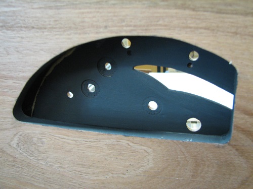

A quick shot showing the sheilding
The sheilding paint is a great way of sheilding internal cavities but it's a shit of a stuff for rubbing off on your fingers/hands and for turning anything black that you subsequently touch, also it smudges if water comes anywhere close and seeing as I'm going with a water based stain for my burst & the f hole faces have a coating of the stuff on them I'm going to shoot a quick coat of lacquer over the areas I can get to with my airbrush just to stop the chance of turning my top black when I come to the staining stage or just working on the electronics :shock: .
Outside shape has been bandsawn and tidied up on my favourite shop tool...the belt sander 8)
