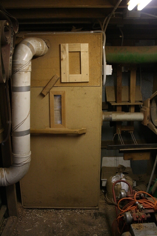

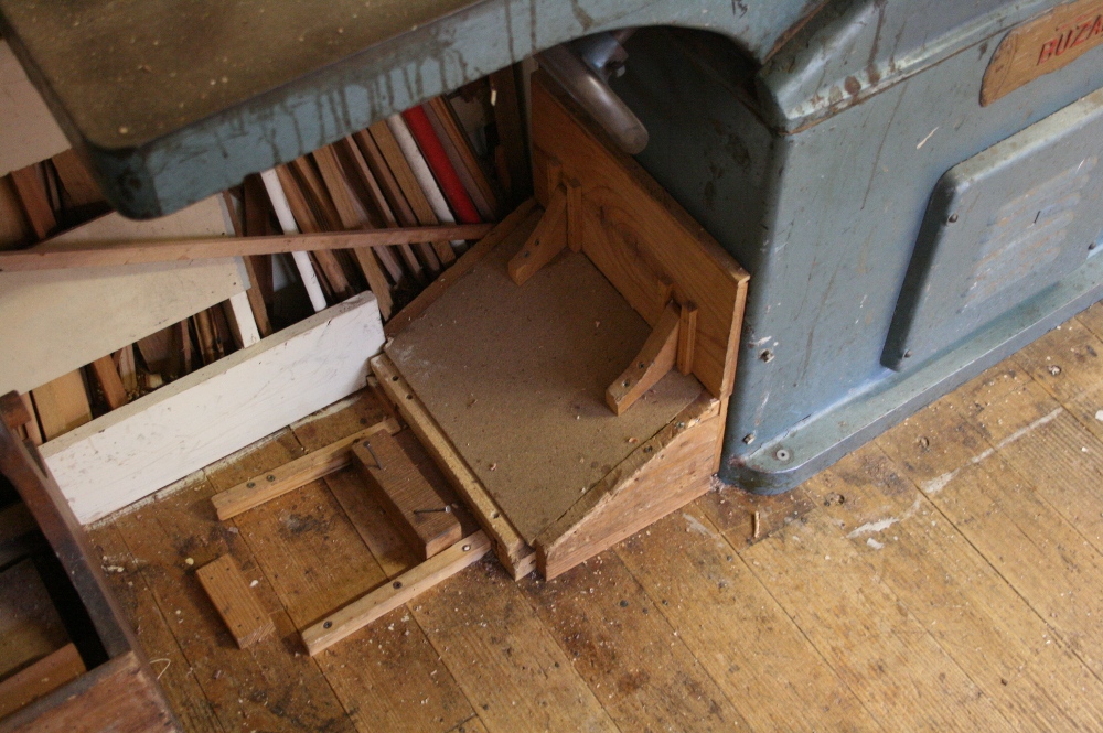

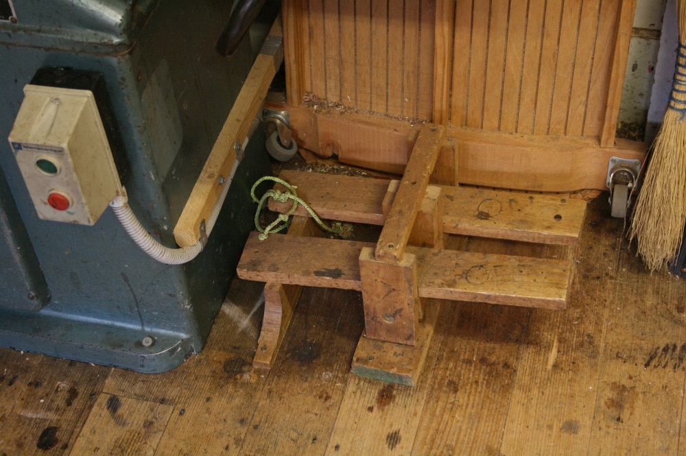

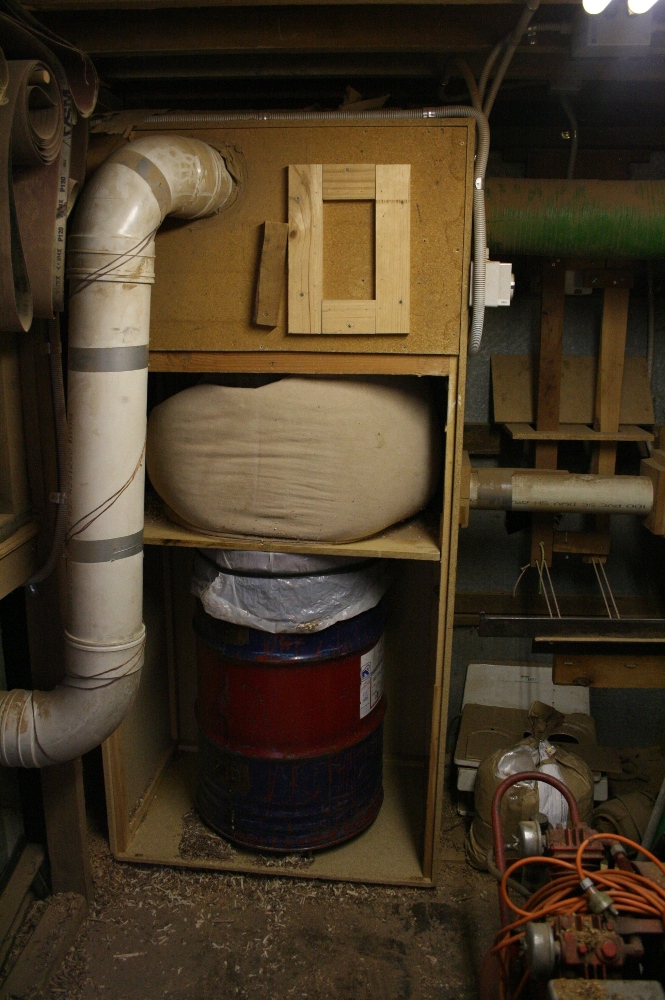

I took some pictures Steve, I have been using this system since about 1997 , my ducts go from 100mm up to a main of 150 mm that runs to the drop box, not 10 or 12 inches like I thought they were.
Some of the gates for the Thicknesser , Buzzer and Bandsaw and the switch to turn it on and off are foot operated, they wear out and need a rebuild every few years, that one at the foot of the buzzer has been remade probably five times, the foot operated switch that goes to the three phase motor has only been rebuilt once?? strange ? I must have fluked the design, it gets the most use.

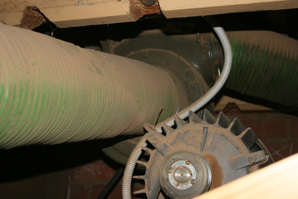

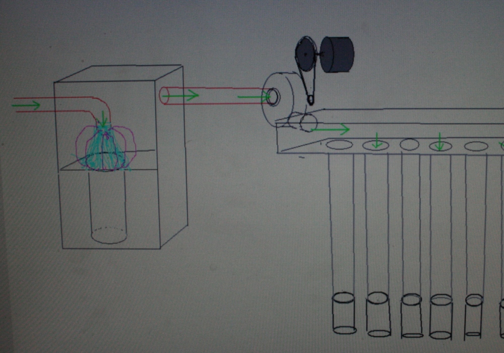

The ducting goes under the floor to a separate room , in that room it goes into the drop box in the left corner ,the fan is in the right corner and the plenum box with the filters is on the other wall to the right. That's pretty much why I chose to do it this way ,It could be fitted into the odd spaces I had, and I couldn't put it outside the building.
The motor is a 3 HP 3phase [not sure ?], the fan is a cast iron 12inch , I think ?
I had an engineer look at it and asked him to give me some pulleys to make it go as fast as it safely could.
It works but if I had the space I would like a bigger cyclone system, I work in a shopping strip though and the locals would have a go at me. Actually it only just works , I extended it to take dust from a few other machines out the back and ever since it has been a little bit to much for it.
