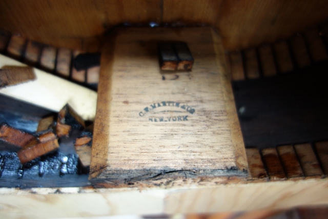

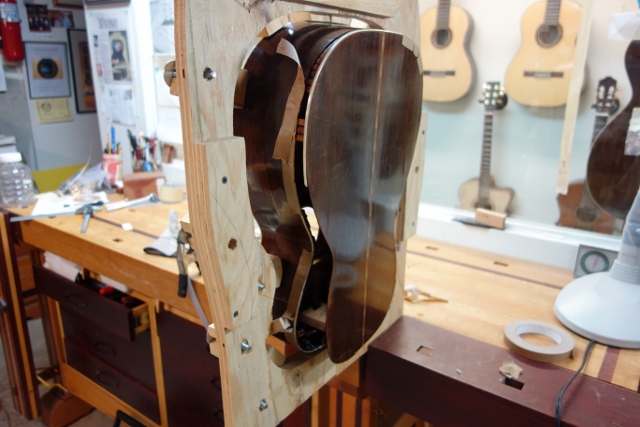

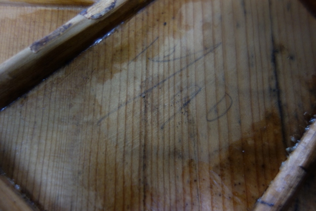

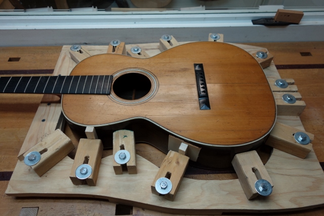

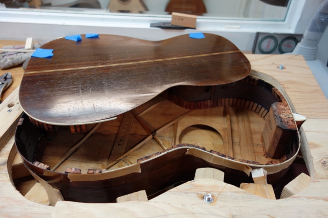

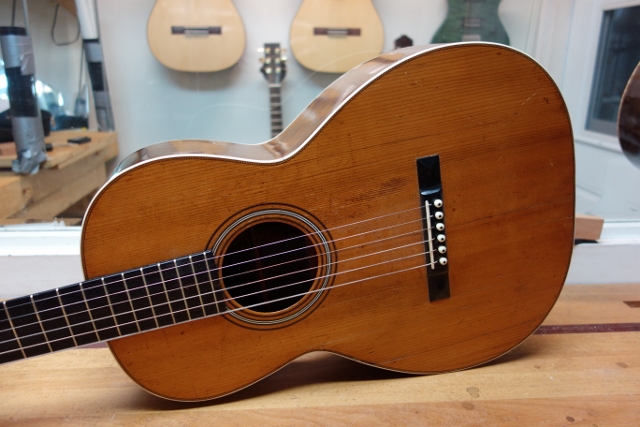

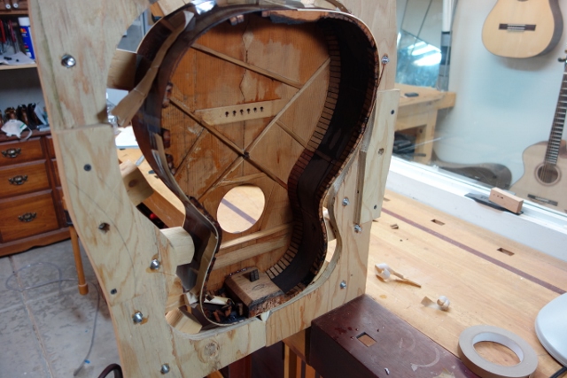

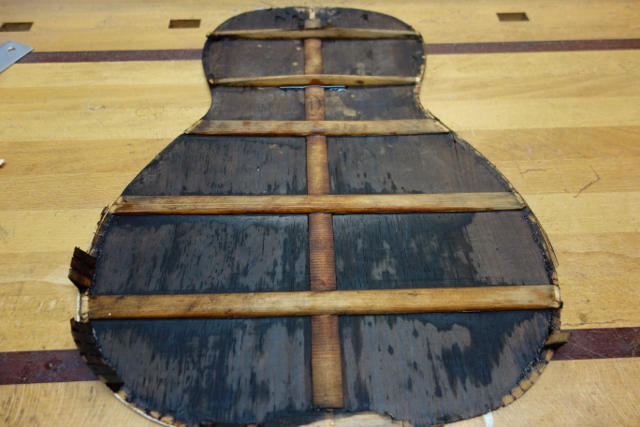

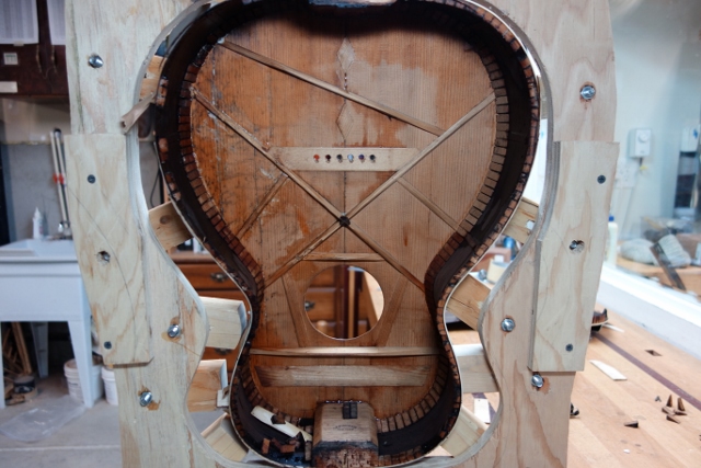

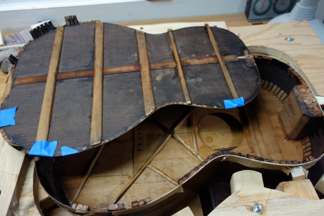

I recently had an old Martin guitar come into the shop for some work. With John Hall's help we were able to determine that this is a model 2 from 1890. It was strung with steel strings which is way too much tension for this little guy. Maybe that is why the left part of the x brace was completely broken in half. Someone has tried to repair it but improperly. With John's help we determined that to do it right the back needed to be removed so that we could get inside the guitar. The bindings, tuner knobs, heel and end caps and rosette rings are ivory. The bridge pins appear to be plastic, , not original. The back and sides are Brazilian rosewood and the top spruce. On a scale of 1 to 10 the pucker factor was a good solid 12 as I removed the back. It took me at least 2 hours to remove it. Care was taken to keep the ivory bindings and the dark/light back purfling veneers intact. Now that the back is off I can get into the restoration of the braces.
