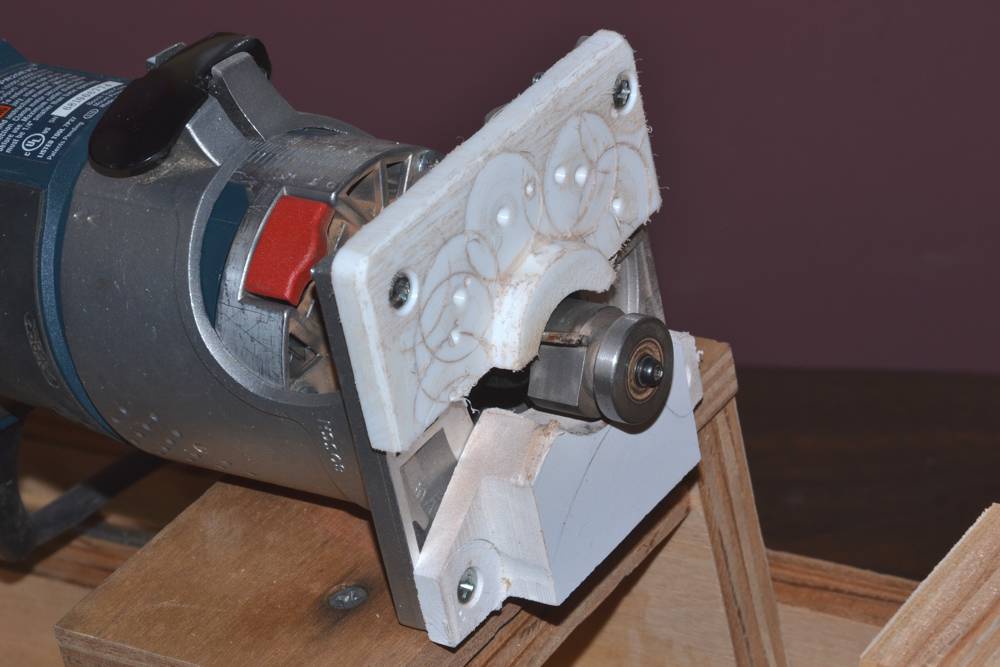

Post by Craig Bumgarner » Tue May 07, 2013 7:19 am
Here is a picture of my setup. Actually the router is a Bosch Colt, but I should think the Makita base is just screwed on too. I use the same holes as the original base. My guitars have a lot of arch, so I want the minimum of contact area, the small curved part. The larger part underneath is more of guard in case I should, in an evil moment, reach under with the router on. This arrangement has worked well through a number of guitars.

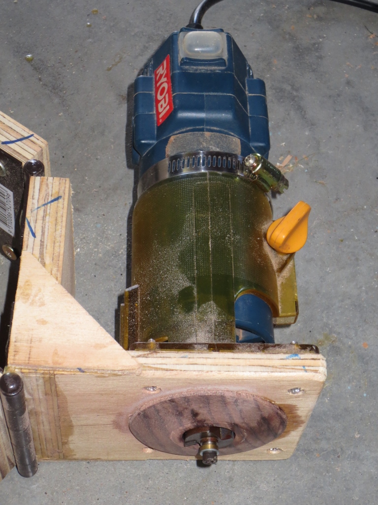

Here's my jig with a cheap Ryobi trimmer
Used longer machine screws though the support into the top part of the plastic base
Note the hose clamp above the plastic trimmer base. This acts as a stop to prevent the Laminate trimmer vibrating down.

jeffhigh wrote: Note the hose clamp above the plastic trimmer base. This acts as a stop to prevent the Laminate trimmer vibrating down.
A good mod. On the Makitas there's a plastic clamp with a screw that can work loose.....not a good thing halfway through a cut.
