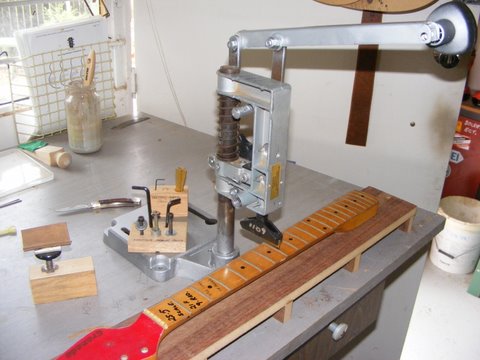

It depends how and when you want to do your fretting. For example, if you want to fret a finished neck like this, off the body, you won't have enough room under the suggested press for the heel. But you will if you have a decent sized drill press and use that. You can get more than enough load with a good drill press and the SM cauls if your frets/slots are the correct fit.

Buy a half decent 2nd hand floor stand drillpress and you will never regret it Alan.
One of the most versatile of all machines you will never run out of things you can find to do with it IMO. Press frets? Easy! Buff out a finished guitar with foam pad? Piece of cake! Use a Wagner Safe-t-Planer to hog off the worst down to near finish thickness of the most greasy abrasive clogging soap like Bocote, or easily burnt woods such as sheoak etc. etc.. As a bonus you can also drill a completely vertical and accurate hole even through the most oddly shaped objects and while that may not sound such a big deal, I reckon that single function is worth every cent you spend because it can ensure that many jigs and fixtures one can make to make seeking to make their instruments better, end up being worth all the time, effort, and materials they've invested in that process.

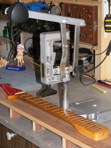

In an earlier post on this subject when responses suggested using a drill press, someone raised concern about possible damage to seals if often applying a lot of pressure, especially in cheaper units. I found a small drill press on a nature strip and use it instead of my good unit for pressing frets. I also throw it under the house between fret jobs because of my workshop space constraints. Frank
