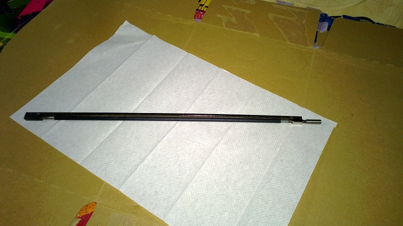

The truss rod I have is from a group buy about 2-3 yrs ago, 385mm in length.

The above link is a video of me routing two truss rod slots for a truss rod that looks very much the same as what you have pictured.

It depends on where you have your scarf joint. under the fret board, or in the peg head. I always have mine in the peg head and they are reinforced with both a head plate and a back graft. Uke necks get a CF truss rod right through into the head stock (overkill for sure) and guitars get 2 CF truss rods run up either side of the Allied truss rod (that's what you have pictured) with 6mm of neck material on other side of the adjustable truss rod.
