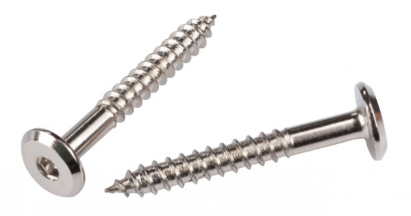

Ok, so I've got 2 short scale basses (32") close to neck on, but I'm caught in a bind. I'd like to just use countersunk screws to bolt them without a neck plate. My dilemma is, the body timber is Kauri Pine. Now sure, it's not a hard wood strictly, but this timber has been stable for over 50 years now and for pine, it's quite hard. What making me think twice about a plate is two things...
1. It's whole lot of fluffing around with steel, shaping, painting, etc.
2. I reckon it's total engineering overkill.
3. I just tested a piece of pine with said screw and countersunk hole and I got the screw so tight my drill and my screwdriver couldn't do it up any tighter.
4. I could easily make it a 6 bolt (or more neck joint) taking the stress off each screw hole.
I know people are gonna suggest metal countersunk inserts instead, but for the trouble I'd go to to get them in OZ, I may as well make a plate.
So I am an idiot to leave the plate out, or will the wood be fine if the test worked?

Hi Pete, if you are worried about the countersunk screw wedging the wood apart you could look for screws like this.

DarwinStrings wrote:Hi Pete, if you are worried about the countersunk screw wedging the wood apart you could look for screws like this.
Where would I find such elusive creatures?
Pete
Re: To neck plate or not to neck plate?
Post by DarwinStrings » Sat May 18, 2013 10:23 am
You would find them HERE You also might be able to get them in S.S. or gold or copper as they are a furniture type screw.

Between this and some other advise, really I think I should just pull my finger out and make some plates. Dang, I'm lazy some times... :roll:
