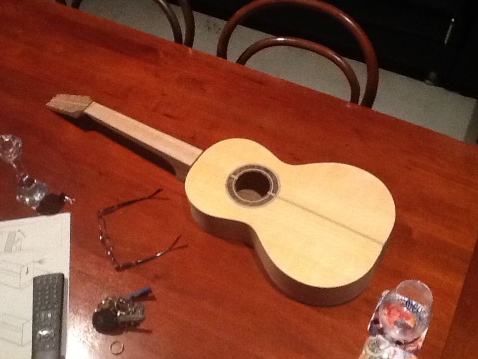

Looking for a bit of advice. I'm making a "copy" of a Regal Tenor as drawn by Antes. I've already reduced the bracing, to a pitch that fits my ear, as all I've read is that the antes plans are over-braced, and I'm happy so far.
Question 1. Does a guitar like this need a truss rod? or could I use a piece of "L" shaped aluminium inset into the neck. I have a mandola truss rod, but I think it'll be a pretty heavy bit and make the neck too heavy....
Question 2. the soundhole is too small to reach thru, so can I use a dowel neck joint on this? or should I re-jig the dovetail jig to fit this little guitar.....Was thinking about a flush cut dowelled joint, as it ought to have much less stress than a bigger guitar.....
As always, I appreciate any input. I guess that one isn't too far offa uke in terms of string tension, and I've seen full-sized guitars with dowelled butt joints.....
Probably should have planned this one better.....

The tension will depend on the strings and the tuning you use, 6 strings Tenors are tuned a minor third up compared to a guitar which increases the tension for the short scale (G-C-F-A#-D-G) I have no idea what you would use for a 4 string tenor. Dowel joints if well done can be very strong.

Thanks Jim. I'm actually contemplating it more because I want to try something new on each guitar I build for myself in order to expand my knowledge base. This Tenor will be a 4 string, 20.88" scale, and I've got tenor strings waiting...I read the most common tuning for a 4-string is CGBE.
I've got a mate, Jeff Martin, who reckons he knows how to play these things, so I've asked him to have a go when it's finished and let me make a little sound clip of it.....
It's really just abit of fun, and a way to try out a Huon Pine top I got that was small.....I just can't bring myself to actually want a Ukulele, no matter how popular they are these days....
......so I used a uke set of Qld Maple from Tim for the balance of this one, and it looks great.....

Another thought Nick. If you were following the Michael Thames thread on CF in the neck then I think it would be a safe bet to assume a aluminium bar up the centre of the neck won't do much if anything at all.
Re: Tenor questions
Ah, I had forgotten about Mr. Thames, or I was drunk, I don't remember which.....
Seriously, I guess that's true, but I've seen older guitars with square steel rods, bars, etc, and thought a T may add some strength, with less weight.
All moot at the moment, tho. I weighed all the accumulated body parts at 620gm and all the neck parts at 400gm...including the truss rod and the neck un-shaped, so I think it won't be neck heavy after all......

Nick, I used the small pultruded rod from LMI on my box tenor. I had to shave the neck to get some relief. It's a 17 fret
body join. I used D'Addario Irish Banjo strings, GDAE. I've yet to put on proper tenor guitar strings on yet, I'll probably
have too much relief. Nothing like a 2 way rod.

2-way rod going in Bill, so to speak......
