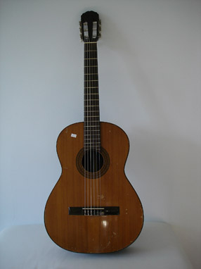

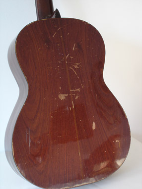

Thank you for the responses. Attached are some photos of the $30 special
just in case someone might think that I have really dropped a router onto the
top of my current build!!! :lol: :lol: :lol:

Bruce is the wood solid or ply? The back is obviously flat sawn.
Bruce McC
Posts: 399
Re: Soundboard removal
Post by Bruce McC » Tue Jun 04, 2013 7:59 pm
Hi Martin
No plywood all solid timber. The top appears to be western red cedar,
I am uncertain as to what the timber is in the back , sides or neck.
Bruce Mc.
