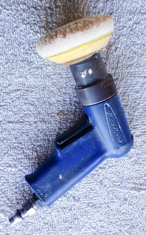

The mini buff I used is called a pistol buff in the automotive trade. I have the Snap-On brand one that will set you back a bit more than the cheap outlet store one, but I use it every single day, sometimes for hours at a time in the day job, and it just goes and goes and goes.
The pads are the hard white ones by Farecla for the buff out, and I'm using the 3M Perfect-it buffing compound. A very little goes a long way. Much less than you see in my tutorial.
I changed from the Autoglym compound because this new 3M one works far better, and the Autoglym seemed to separate and go bad well before I got though a 1/4 of the bottle.
If you get the combination of compound, speed of buff, and pressure on the pad right, the finish will come up like glass in seconds. No need for finer compounds or glazes. Slower speed works better than high speed.

Here is the picture of my buff.

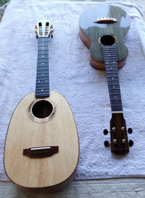

And a couple of ukes that I buffed in under 15 minutes Sunday morning. Crappy photo as it was late this afternoon when I got back out in the shed.
