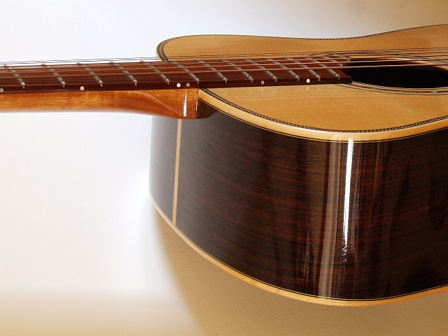

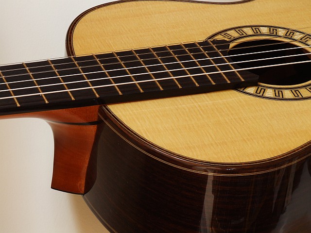

Here's the second version of the neck joint, with the vestigial heel. It's a small guitar too, but I gave her 20 frets on a 650mm scale length. Currently running as a 100/190Hz guitar, but I'm still messing with that.

Nice and who would know the heel is a fraud. Not sure if you caught the other thread but this one is a none live back with tornavoz at 89/191hz so far. I'm very impressed with the sound and I have never played a guitar that tunes so well, can't wait for the next with a live back but am waiting till I check bridge rotation on this one before I brace the top on the next. Just from a guess so far I have not got much bridge rotation which looks good for the next as I will be able to drop brace size. By the way Trevor I grabbed some Silver ash for the secondaries (have bent enough spruce for 4 sets of mains), my mate had both coloured Silver Ash and I grabbed the lighter coloured one. It dynamically tested at 1.89E +10 at 660kg per cube M so I figured it was the right species. It still didn't smell real nice through the saw though.

I should have mentioned, for those wondering what the point is, of a heelless guitar with a heel, it's that the neck shaft on this one is continuous, full width and full depth, up past the 18th fret, so there is zero possibility of fret board hump and all the other palarva you get with with fret boards over the upper bout. Plus you can get the neck off in a fraction of a minute longer than it takes to drop the string tension. So just a variation on Leo's design which has stood the test of time so well.trevtheshed wrote:Here's the second version of the neck joint, with the vestigial heel.

Ok, after Trevor's post I will havwe to withdraw my comment. The reason I thought it was likely to fail is that there is no leverage for the forces on the neck, but if you add leverage some other way then it should be fine.

peter.coombe wrote:I would avoid. Looks designed to fail to me.
Peter
Thanks Peter, thanks because your comments illustrate why it is so difficult to make changes. People make judgment calls without being informed and if someone like you who is very experienced in the game makes those judgments what could I hope to expect from the average punter.peter.coombe wrote:Ok, after Trevor's post I will havwe to withdraw my comment. The reason I thought it was likely to fail is that there is no leverage for the forces on the neck, but if you add leverage some other way then it should be fine.
Peter
Maybe if I can't convince people then I will have to take them through Trevor and Gerard's book then point out the section where he points out the benefits and the prejudices of this type of neck but then you know Trevor and trust his reputation Peter, others won't know him from a bar of soap.
Still a uphill road is always the most satisfying as you get to see the view from the top once you arrive.

Fender electrics can still get a bit of a hump, I have seen them do a little bend at the 15th but I guess that that has a bit to do with the compressive nature of their truss rods as well as maybe the use of Maple and that full length dual action rods will help that issue.trevtheshed wrote: so there is zero possibility of fret board hump
Re: Feedback please.
I like the whole concept, Jim. The original, without the vestigal heel reminds me of an old EKO I had for a while. Played really well, actually.
Now, from a more practical perspective, I tend to agree with most of the others, that it would be a tough sell to the average Joe, simply because it looks different. Keep in mind that there are two very distinct camps in the electric world. Those that accept that a bolt-on neck can sound fine, and those that swear that without a set-neck it's nor really a guitar. I also believe that most guitar shop customers and salesman have n o idea if the acoustic they're looking at is bolton or dove3tail, and won't find out til it needs a neck re-set...
So, you are left with the option of having to educate the buyer(s), assuming they will allow that(not a given), or assuming that the buyers are forward-thinking(also unlikely)...
Next onto the vestigal heel. Personally, I'd forego it. Practically, it may be a more marketable concept. It looks good, and will probably "fool" the casual observer into missing the neck joint completely. At that point, the entire purpose of the neck construction is moot.
In the event that I had any likelihood of selling more than one or two guitars annually, I'd put it up as an option, but be willing to back off the idea were the buyer hesitant......Kind of...."got this great new technique for the neck joint---been approved by NASA for the singing astronaut---oh not interested? dovetail or bolton????
Personally, I like it and now I have even more to think about....Thanks heaps(dripping with sarcasm

G'day Jim ,
Looks like I'm going against the flow of most here , but I like the design a lot. Reminds me of the precision engineering of a gunsmith . .I'm guessing the yaw alignment wouldn't be any more time consuming than a conventional heeled neck.
I remember the old Eko Guitars too Nick (no neck heel ) and agree that their necks always played well . Shame they had a very thick soundboard finish.
I've always liked the playability of an acoustic without a heel . they just feel good and of course, give easier access to the upper frets . To hell with the traditionalists Jim , forget the heel . I reckon you're on to a good design here. I could see it being a real winner for a travel guitar with a detachable neck . I can also see this design easily adapted for a tilt neck. Very handy for consistent string action regardless of humidity and just the thing for drop tunings etc.
If the neck joint design doesn't require a heel, why include it ? That Vestigial neck has me a little puzzled.
Great work Jim .I'm encouraging you to "stick to your guns " with this design ( pun intended ! )

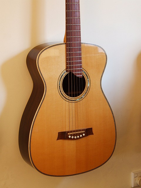

...and here's the Mk 1 version of the heelless neck. Sounds great, plays great, but the fact that I still have it at half my normal prices makes the point, I think.
It's my neo body shape (about 00 size), Engelmann/EIR, maple binding, herringbone purfling, figured QLD maple neck, SEA rosewood fretboard. Offers, anyone?!! (The other one was a classical BTW, which may not have been clear).Fine classical and steel string guitars

Dunno Trevor, guess I'd take it off your hands for postage. More of a charity thing really, must be tough having such an ugly duckling taking up room.
For what it's worth in this discussion Jim. I'd say, if you like it, keep at it. Structurally it sounds like it'd work - after that its down to you if instant appeal is what is driving this. I have to admit, the first time I saw a square neck slide guitar it looked so wrong given the instant pattern recognition I mentally associate with a guitar shape. Now I like 'em almost as much as because they don't fit the standard profile and personally I think this would have the same appeal to me. ...... not so sure that's the best recommendation for pushing forward though
