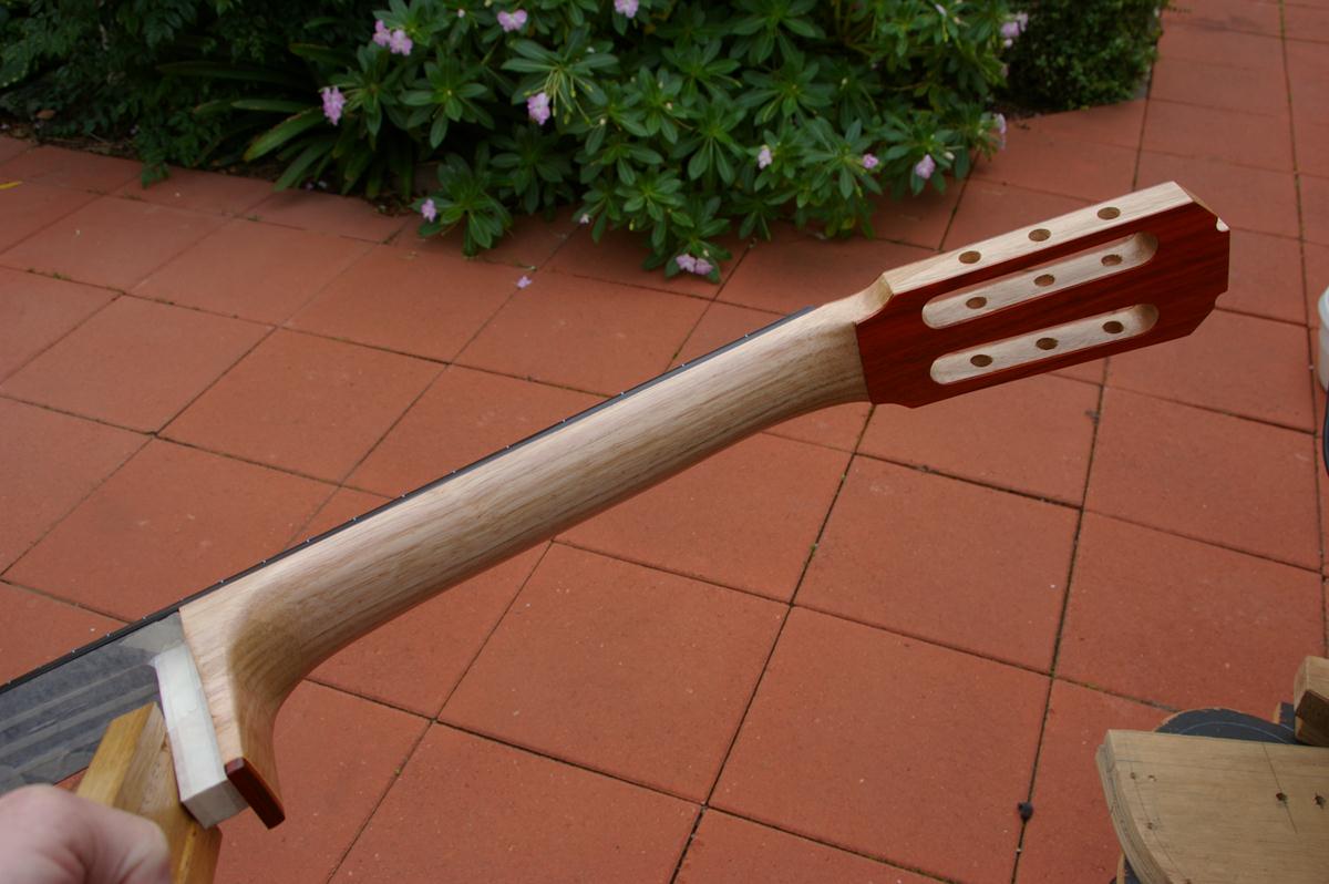

has anyone used aussie oak for necks
I found some quarter sawn stuff just the right size for necks at my local carbatec so bought it and have just laminated a couple of neck pieces
one with jarrah and the other with sheoak but havent had any experience with it but its light(both in weight and colour) and looks like it should be ok ?
