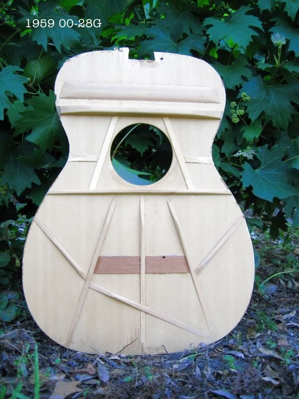

This is sort of interesting. Happened to see this while Trevor's design book was open to figure 1.7-1. Looks like the whoever designed it had observed cross dipole, long dipole, and cross tripole Chladni figures and roughly stuck braces over the nodes (respectively: the fan down the middle, finger braces making a smiley face with the bridge, and then the two outer fans). Interesting.
Of course it could have zero to do with that and he had arrived at the design with the thinking, "idk what if three fan braces instead of seven and maybe hmm some finger braces?", for reasons I'm not going to try to guess.
