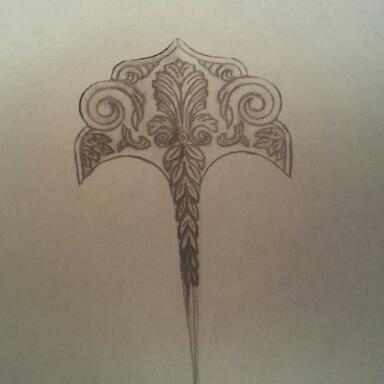

Well here's the first concept design drawing. The slots will also have the modified thumbnail pattern like the back.
Chris

Bet its as good as the back Chris, someone will be pleased that's for sure.

Geez Chris, they are such works of beauty that I would be wanting to put my signature in the bottom right hand corner every time.

Played around with it a little. Probably let it sit for the week and make a finale tracing and working drawing and start work on it this weekend.
But nothing finale until the gouge hits the wood... :)

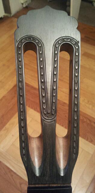

Post by chris paulick » Tue Jun 18, 2013 10:55 am
That's what I use the 1st. fret for.. :)
2013-07-05 18.27.40-1.jpg (28.84 KiB) Viewed 29070 times
2013-07-05 18.25.42.jpg (19.54 KiB) Viewed 29071 times
Chris

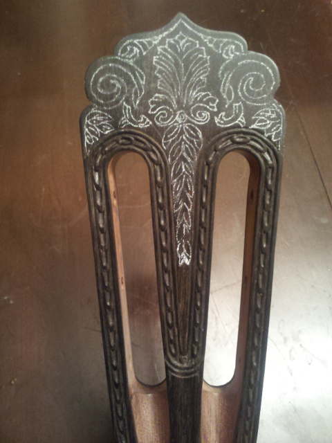

Post by chris paulick » Sun Jul 07, 2013 12:02 pm

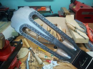

Well i got some design and layout work done today. Use a white transfer paper from the fabric store to transfer the design this time. It will need to be cleaned up while carving but it's in the ball park.

Post by Kim » Sun Jul 07, 2013 2:12 pm
You have a good eye for design Chris, that looks very nice.

Post by chris paulick » Wed Jul 10, 2013 10:15 am
Did some more ruffing in. I canned the white line transfer paper( lines not sharp enough and I kept smugging the off. Went back to gluing on the paper drawing and scoring in the lines with a knife and chisels.

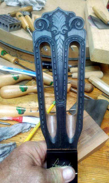

Post by chris paulick » Sun Jul 14, 2013 5:27 am
Update. This takes me time and I usually don't get much done until the weekends. Sometimes a little durning the week if I'm not too burnt out after work.

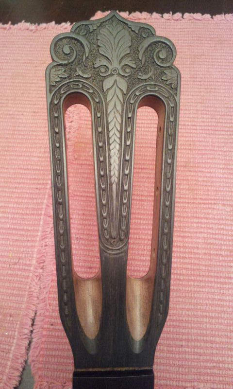

Post by chris paulick » Tue Jul 16, 2013 9:17 am
OK, call it ruffed in. Time now to refine it, a little under cut here and there and some shaping and accent lines. I think it's coming along alright .

Post by Nick » Tue Jul 16, 2013 1:39 pm
chris paulick wrote: I think it's coming along alright .
:shock: :shock:
Only alright Chris?? I'd say bloody brilliantly! That looks great, I'd be extremely proud of myself if I'd done half that good. :cl :cl
