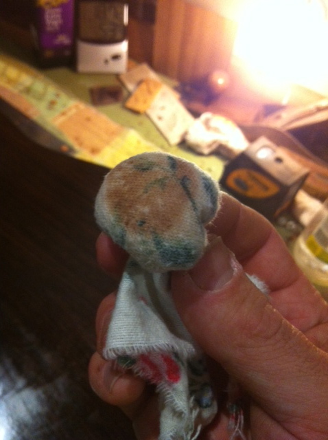

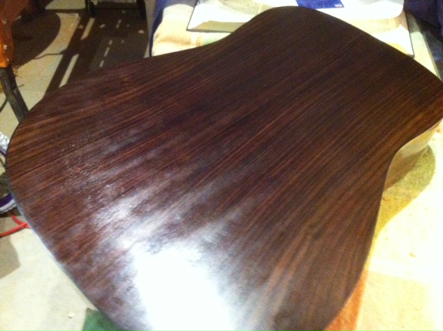

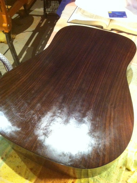

Hi all,
I am french polishing No.1 it's going ok - but I do have a couple of issues that I need help with:
I'm using Ubeaut Hard Shellac.
Sealing coat 30% shellac/70% meth
I filled grain with Timbermate.
Have done 5 coats of 50/50 shellac/meth.
In between have been wiping off oil with meth - and here's the first question......after wiping off I get real streaks. I'm using as little meth, and going as lightly as I can, but i'm still getting them, and they remain even after the next session of shellac...... assume I'm taking off the finish here? I'm still getting a really patchy finish. With swirls. I thought that after 5 or so coats i'd be building up by now? i'm also still getting colour on the rubber after doing the sides/back.........
I'm guessing the answer to both is that I haven't built up enough body yet? I'm really trying to keep the finish as light as possible......too light!!?
I have some rottenstone for polishing, when I get there - what oil is best to use with it?

If you're getting colour off the rosewood on your pad then that does suggest to me that youre taking off alot of shellac when you spirit off the oil. It sounds like the pad is in contact with bare wood to be picking up the colour.
Hard to see exactly whats going on with your efforts but you may be applying too much shellac to the pad. After loading the pad it should leave a dotty imprint when you pad it on some paper. If you get a single blotch then the pad is too wet.
You're cutting the Hard Shellac 50% which means you're using roughly a 2lb cut for bodying....that's abut what I use.
What sort of oil are you using? How long are you waiting after each bodying session before spiriting off?
If you're down to bare wood then there's the risk of oil from bodying sessions getting into the wood. Once that happens you're going to have some real issues.
I use walnut oil which tends to blend with the shellac more than other oils. I find I don't need to do much in the way of spiriting off of residual oil. Ill do up to 5 bodying sessions and then do a quick spiriting off session. The finish lies for 2-3 days and then I cut back with wet and dry lubricated with walnut oil. After wiping off the oil I find I don't need much oil on the pad for subsequent bodying sessions.

Martin - you are certainly right amount one thing - I'm using too much shellac - way too much, and have been relying on that amount to slide the rubber around as opposed to the oil. In fact - i'm using such a small amount of oil that there is probably hardly any to wipe off.
My only thought on that is that surely that would lead to heavier coats as opposed to lighter ones?
I've been using olive oil up till now. But thanks Jeff - I'll pick up mineral (paraffin?) oil today.
I don't think I'm getting down to bare wood during the sessions -but then again I can't explain the colour on the pad. I'm leaving it at least 8 - 10 hours before wiping off.

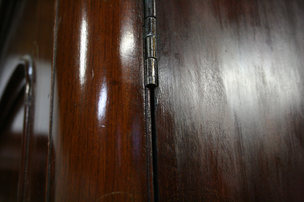

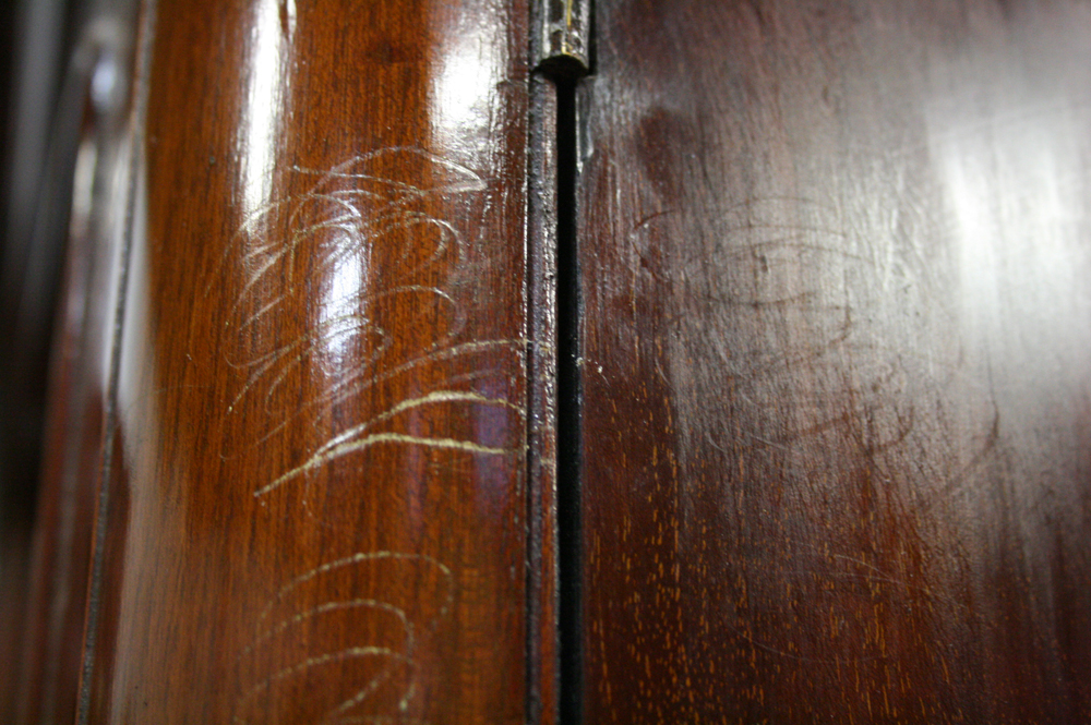

To my knowledge nobody has answered the question as to how hard shellac copes with repairs further down the track. Any comments from anyone?

I don't see a huge problem with repairs. You just need to accept that hard shellac is no longer going to act like shellac when it crosslinks. However, getting shellac to stick to it shouldn't be a problem ... shellac sticks to just about anything except silicone. Shellac based varnishes are routinely used in the violin world as the touch-up varnish of choice, even if the original finish is an oil based finish.
More of an unknown is how hard shellac stands up in the long, long term, whether the crosslinking affects its durability and transparency over a long time period. We just don't know this. But we do know that shellac does, over a long period, tend to crosslink naturally anyway under certain conditions. So hard shellac might just be accelerating the natural process.

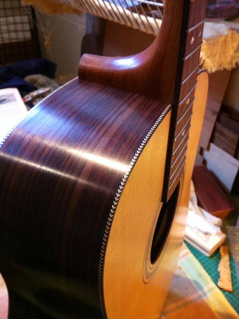

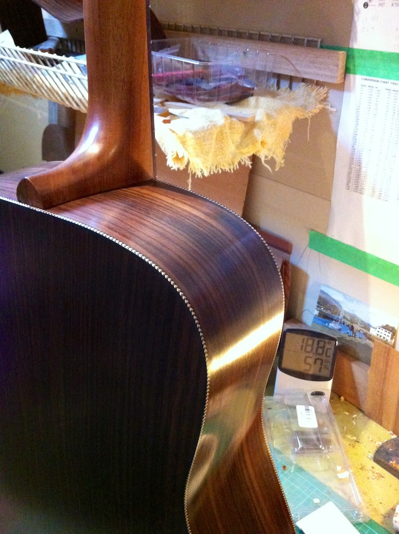

I have now got a finish that I'm really happy with. I rubbed back (and in some areas there was a lot to rub back!) with wire wool, buffed with rottenstone, and put a smidge of ubeaut wax on the neck, sides and back. It's not the finish I thought I was going to get - but I'm pleased. I save the full gloss polish till the next one! - which is on its way now too.
So.......
I was definitely putting on too much shellac.
The colour on the rubber was the timbermate filler. The only saving grace on this was that I put a really good sealing coat on before the porefilling - so thankfully I was not close to going back to bare wood.
I haven't used the hard shellac before. On furniture I use flakes - and I have to say I think they are a little more forgiving.
Thanks again everyone............. oh, and I realise that the herringbone binding is "the wrong way round" - but I really liked it that way so I went for it!
Martin - I'll PM you next week and pop up to see you - I need to bend someones ear about the Gore books too!............
So.......

Great result Steve. This thread turned out to be very informative thanks to all for the input.

Here is some furniture examples , no strings attached
This Australian Red Cedar wardrobe was made about 1870 to 80 and grain filled and polished with shellac , for what ever reason it was restored possibly in the 1950s and the front was repolished with a spirit varnish while the sides were left with the original FP
There is a before and after pic of where I have done a swirl with the corner of my blunt thumbnail ,the brittle spirit varnish on the front is chalky brittle and lifts and marks , it's crap, the side which I think would have a small amount of the spirit varnish over the mainly original FP handles the same treatment much better
The Sofa table in front of the wardrobe is a job I have been working on ,made about 1815 to 20 its similar to the wardrobe in that it had been restored by repolishing the top and leaving the base with its original FP job untouched. The client was not happy with someones restoration of the colour of the re done top so I washed it of and re polished it. Its just 3 body jobs , no oil , with blonde and then one finishing go over with a little oil , it has been cut back for another go and will probably be waxed.
The good old Traditional FP job with just shellac stands up well and I think the only reason why polishers went with other methods was for the time they saved in polishing .
