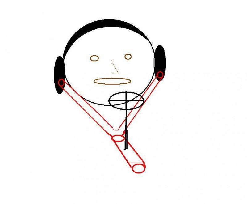

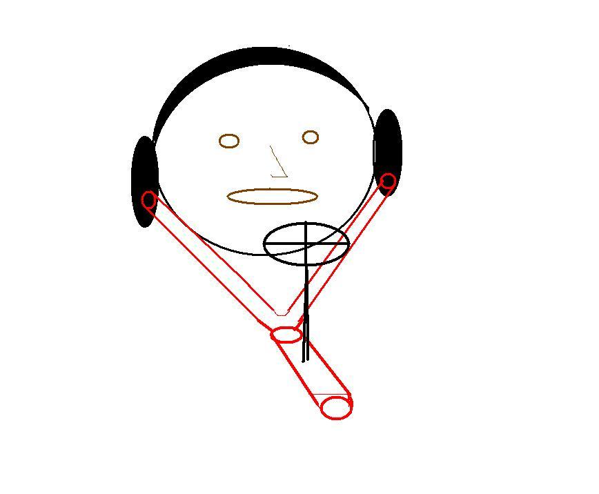

One thing I want to try out next time I get a buzz is a Noise direction finder.
Have you ever stuck a cardboard tube to your ear and waved it around in the suspected direction of the sound ? when it hits the right direction you will know about it.
I used to do it in a HQ ute I was fixing up, while I was driving with my left hand forming a short tube I was amazed how well it could show up noises on the left side of the car.
Imagine sticking a tube or two that goes into one direction, into an old set of ear muffs ,
Or just hold an empty toilet paper roll to the ear.
