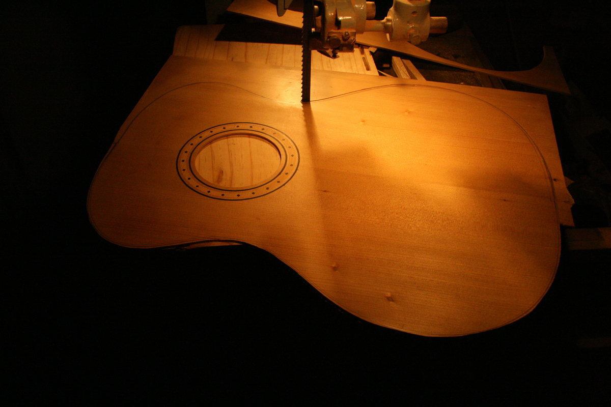

I just made two "fundabird" basses from it. here's the body from one of them before finishing...
I've found it soft, but firmer than radiator pine.
Pete
