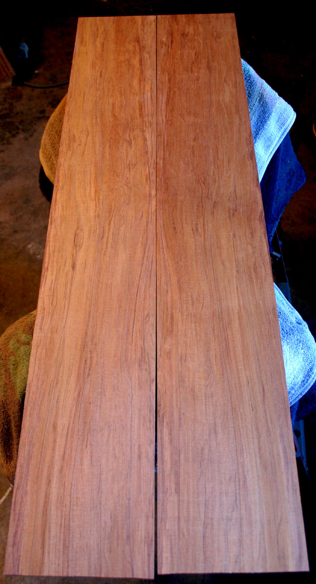

Hi Guys,
There seemed to be bit of interest from the good folk on here regarding a build thread I had posted on another forum
so I thought I would share it on here. It's nothing spectacular just a clean looking build utilising my beloved New Zealand natives. It features Kahikatea for the top which in my eyes is the Adirondack spruce of NZ.
Heart Rimu which is again botanically a softwood, but the heartwood is very dense and has a beautiful grain.
The soundhole design is a Koru which is used frequently in maori art, it symbolises a unfurling fern tree frond.

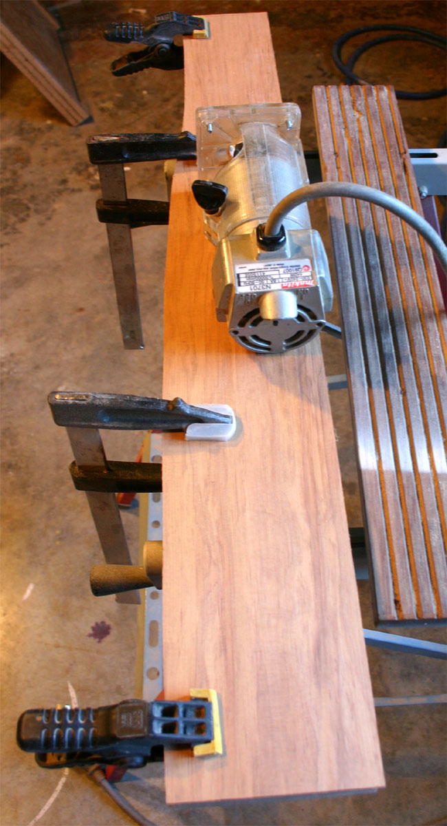

Is that a 45 degree chamfer bit is the trimmer Christian?
Col
christian
Posts: 338
Location: Bay of Islands NZ
Re: Build Thread: 000 Koru kahikatea/Heart Rimu.
Post by christian » Tue Jul 30, 2013 3:01 pm
yes a 45deg bit.

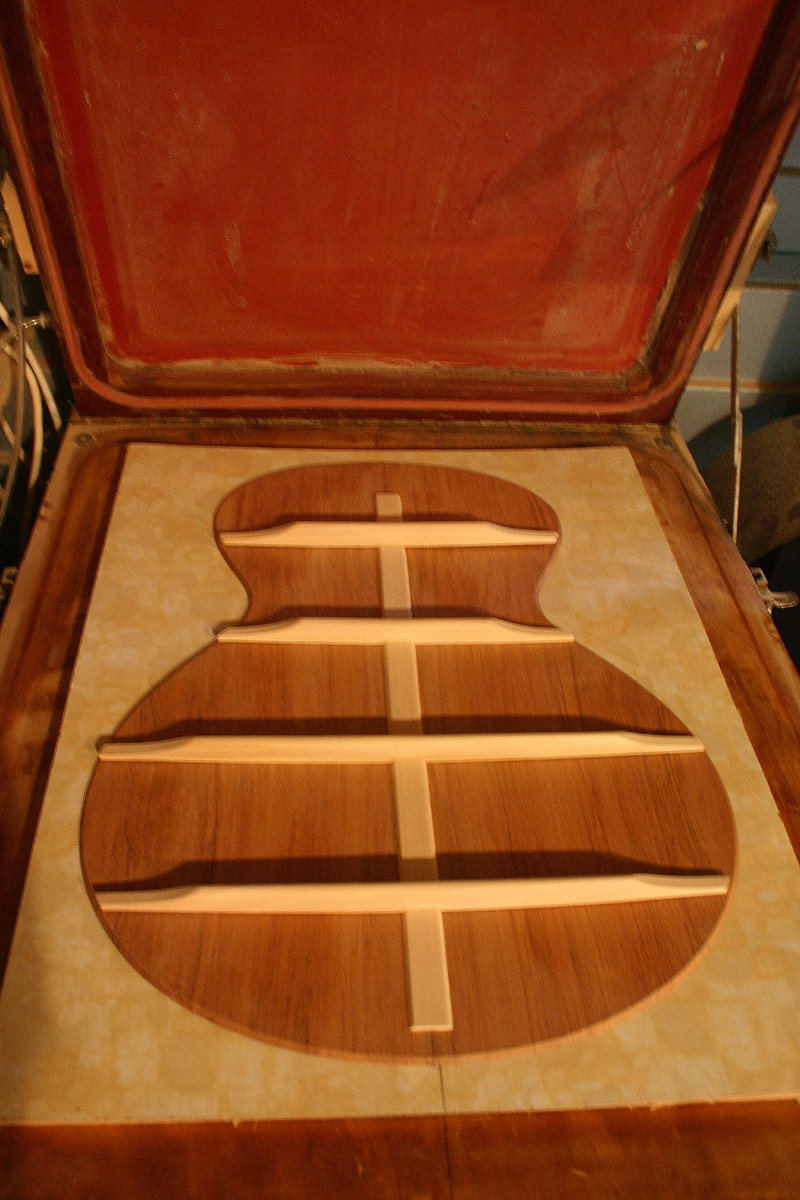

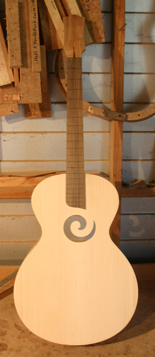

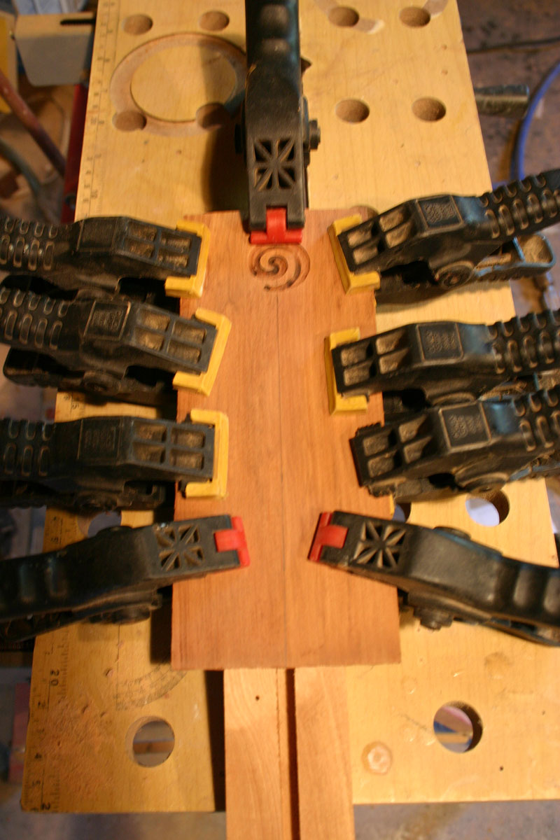

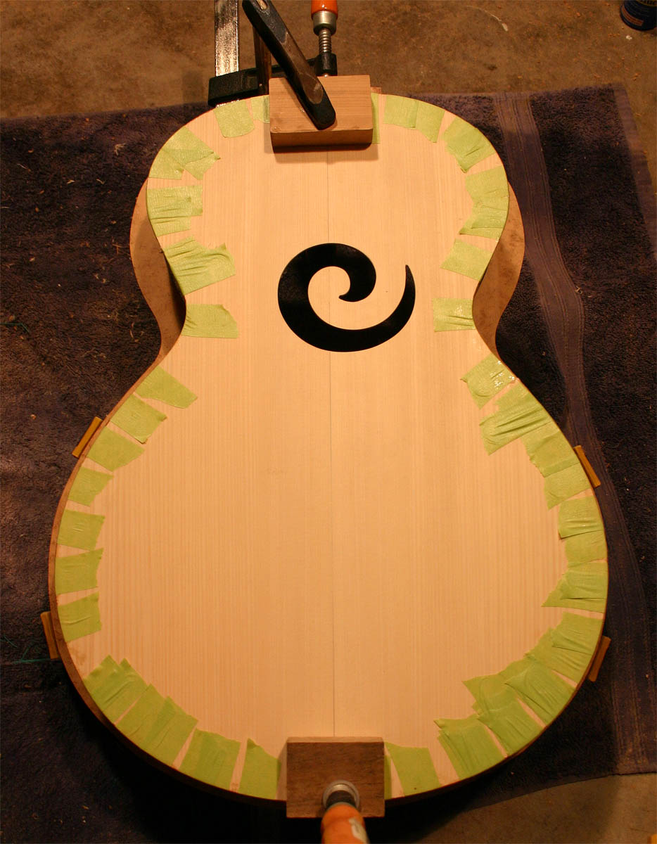

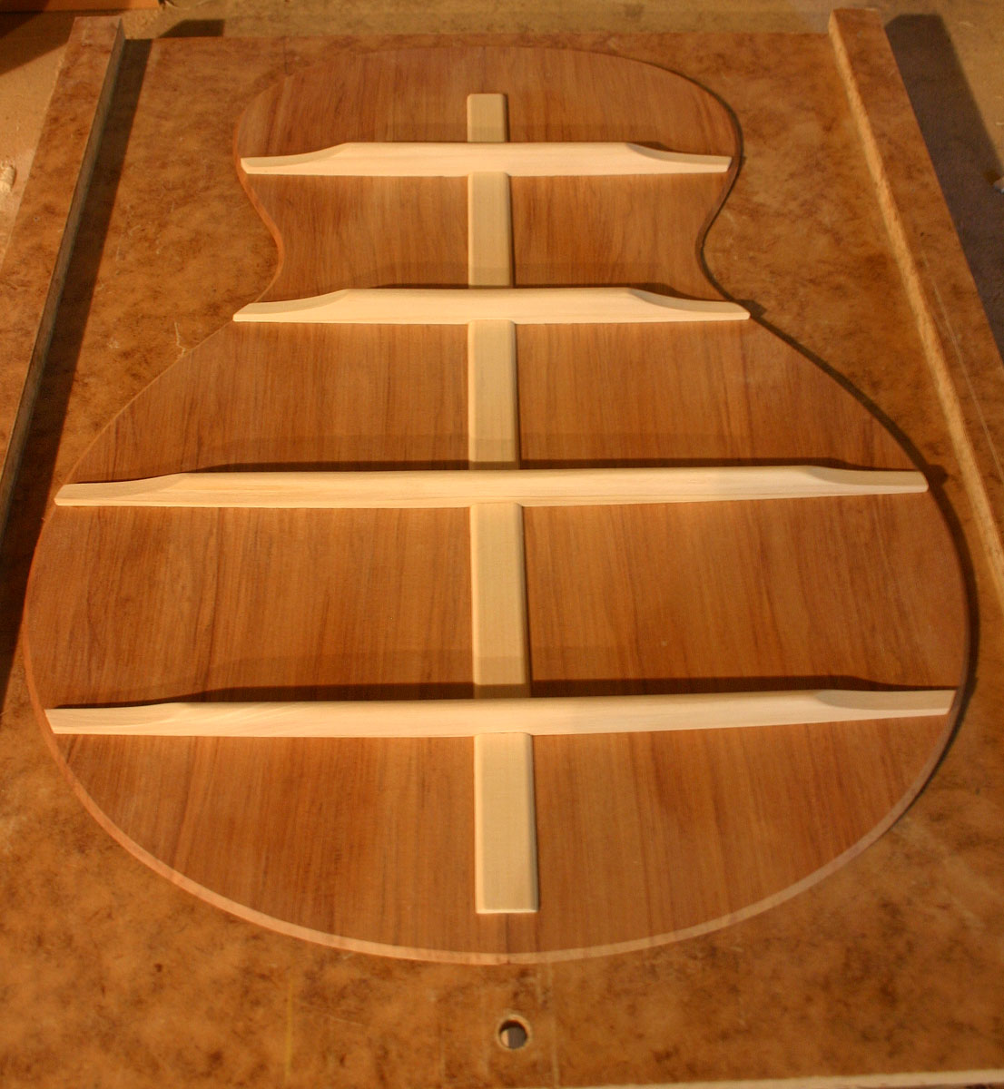

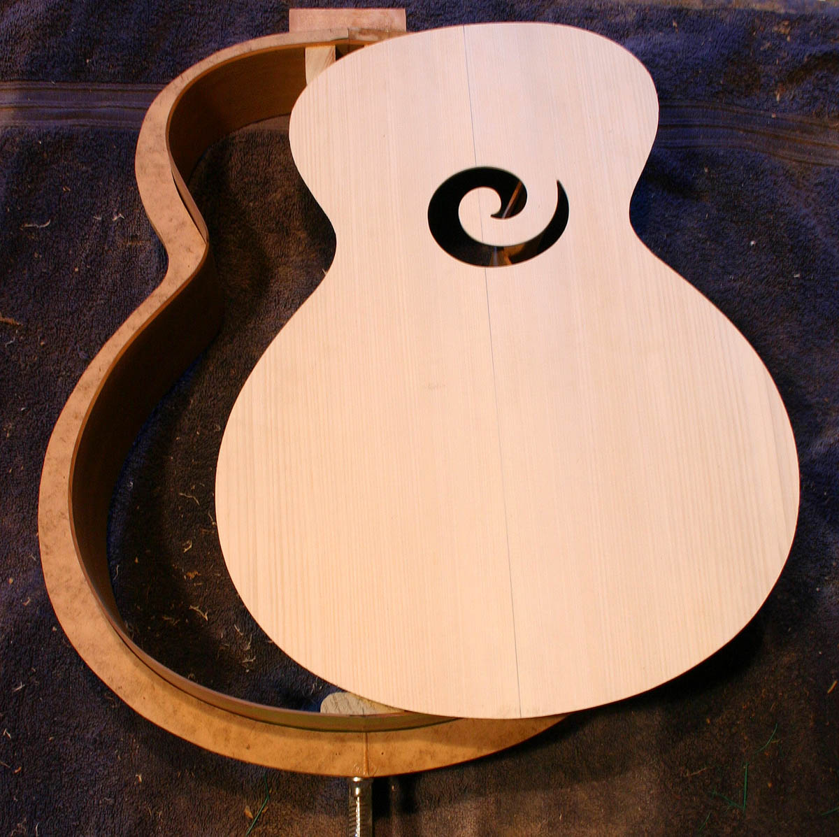

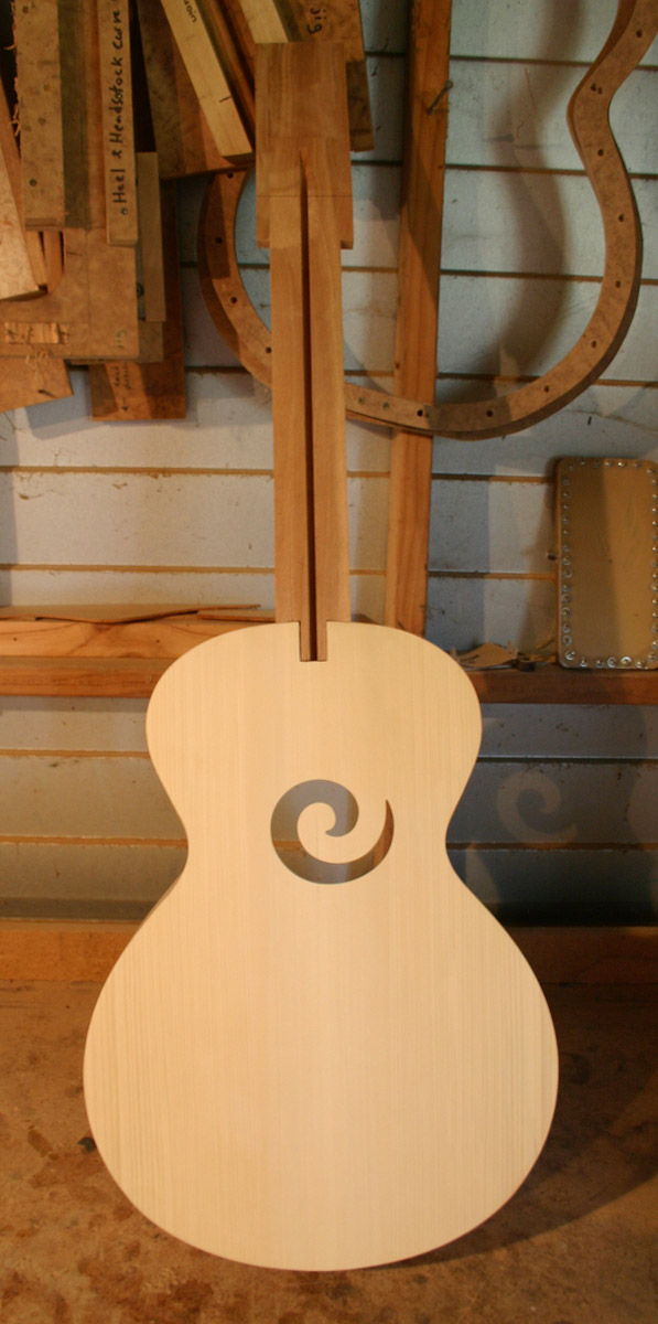

The next 10 pics are the sequence to cut out the koru soundhole and top bracing.
Christian
Leonardo da Vinci
www.christiandruery.com
christian
Posts: 338
Post by christian » Wed Aug 07, 2013 7:23 am
After seeing Steve's build this guitar is looking positively ordinary.
Still we all have our own aesthetic and mine at the moment is this clean look.

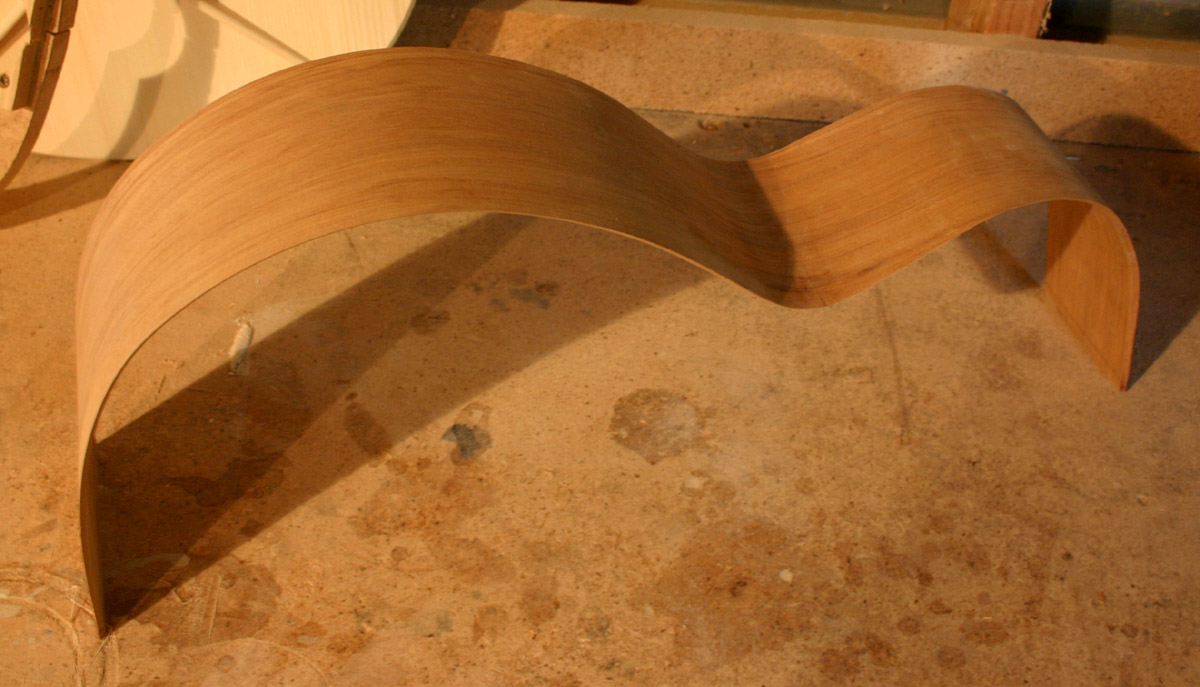

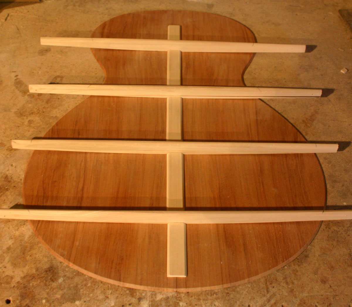

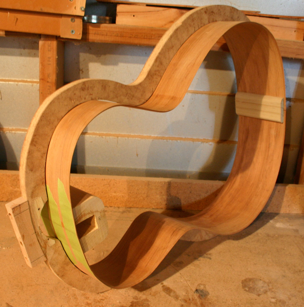

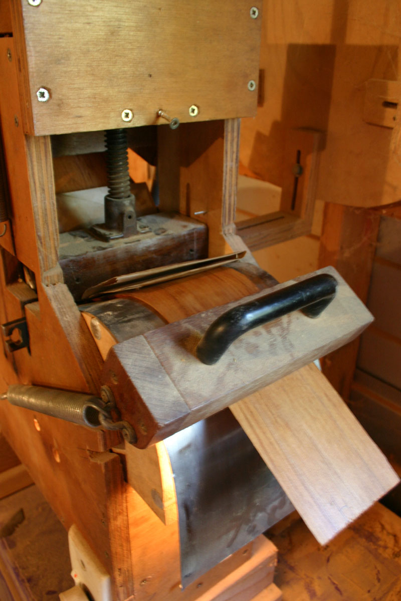

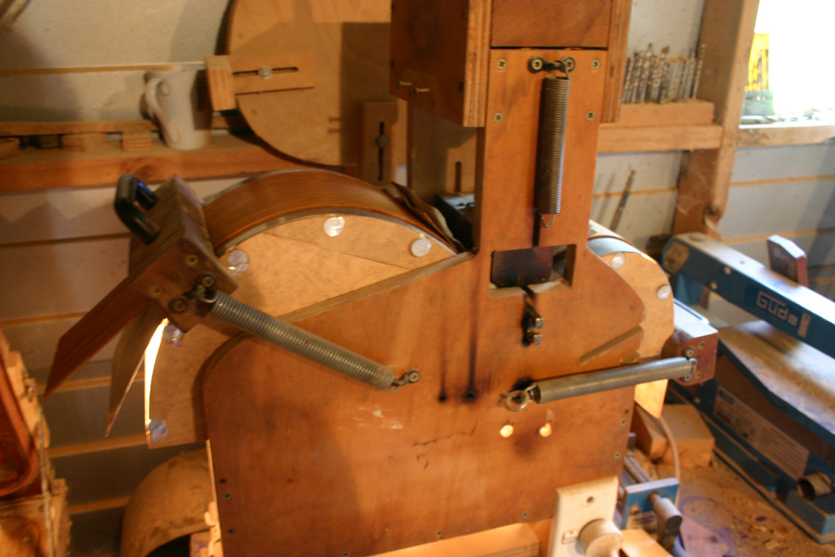

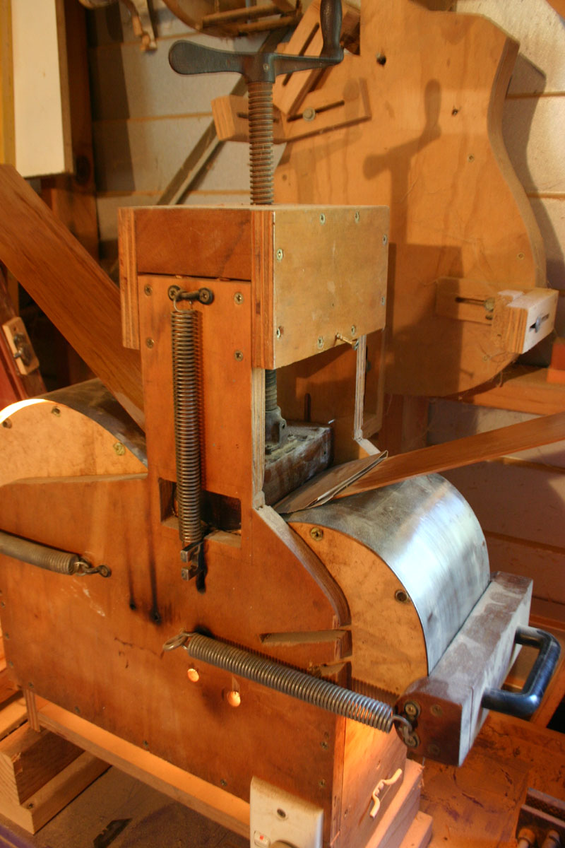

The next set of photos are of the back being braced, and the sides machined and bent on the trusty side bender.
Christian.

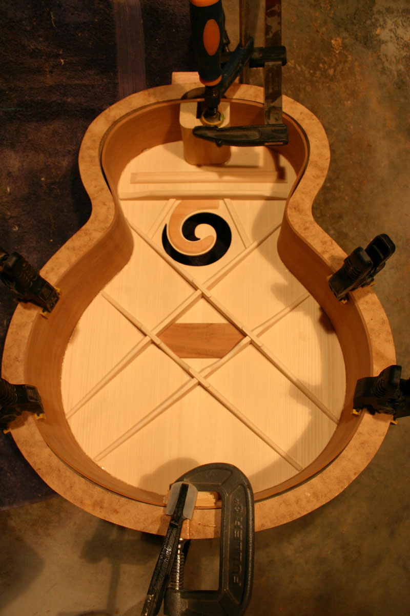

christian wrote:
Now that is the most interesting soundhole I've ever seen.
How creative! How will you trim that...if indeed you do?

Post by christian » Wed Aug 07, 2013 12:10 pm
Hi Steve,
Thanks, for the comments.
Indeed no trim on this one, pure form.
Christian.

Looks great Christian. How much difference is there in the size of your top and back profiles? Would have been a pain to sort that all out, I'd guess.
I'd be keen to try the technique, but don't know if I can pull it off.

Not really. I was thinking more that the top has flat sides to land on, while the back, assuming it's got a taper, would result in an incrementally, but noticeably, different outline.
Maybe I used the wrong word. Do you get what I mean now? Ie: my OM back goes from 100mm at the tail to 105-110 at the centre of the lower bout and tapers down to 95+/- at the neck.
This ought to give a difference of a few mm's at the least, and would also require that the sides are all perfect(not there yet, myself) and square, etc.....
I don't use a radius dish, as I have seen too many guitars with a bulge at the tail. I want mine to be straight across, so I make a top and bottom dish for each style guitar I want to make, ala' Kinkade.....
Does any of this make sense to you? Christian. I'm sure that I'm not using the proper terminology.....too new to the game....
christian
Posts: 338
Post by christian » Fri Aug 09, 2013 3:38 pm
I think you are talking about the side profile. I took a finished guitar and traced the side profile on some thin card, noting the the waist curve as a reference point. Then copied that to a piece of MDF and accurately made a template for it. So once the side is bent it should line up with the back and top profile.
I hope that helps.

Post by nnickusa » Mon Aug 12, 2013 6:52 pm
Two questions, Christian.
1. Do you add linings to the top and back? seems a really small glue area to hold a vibrating top....
2. Is your side bender using light bulbs? And, if so, how many. I've got 4 outdoor spots at 150watts, that get hot as blazes, and I'm not using for anything. I'd have a go at a side bender if you thought that much would do the trick, tho I do love bending on a hot pipe......that may have sounded wrong. I meant a bending pipe.....

nnickusa wrote:Two questions, Christian.
Christian, it is interesting having no kerfed linings - It looks like it would go together easily but I suspect it isn't the case. Nick, I just made a small LB bender for Ukuleles and I used 540 watts, it gets damn hot and worked well to my surprise, so I think 600w will do the trick.
Col
christian
Posts: 338
Post by christian » Tue Aug 13, 2013 8:08 am
Hey Nick and Col,
I do add pre bent linings they are very thin only 2.5mmx 10mm
you will find you don't really need much in the way of a lining if you don't have binding or purfling to worry about.
yip my bender has light bulbs three 150W. I found by lining the area with tin foil it heats up my steel slat super hot really quick. I only use the bender because I'm lazy, if you are competent on a hot pipe just stick with that.

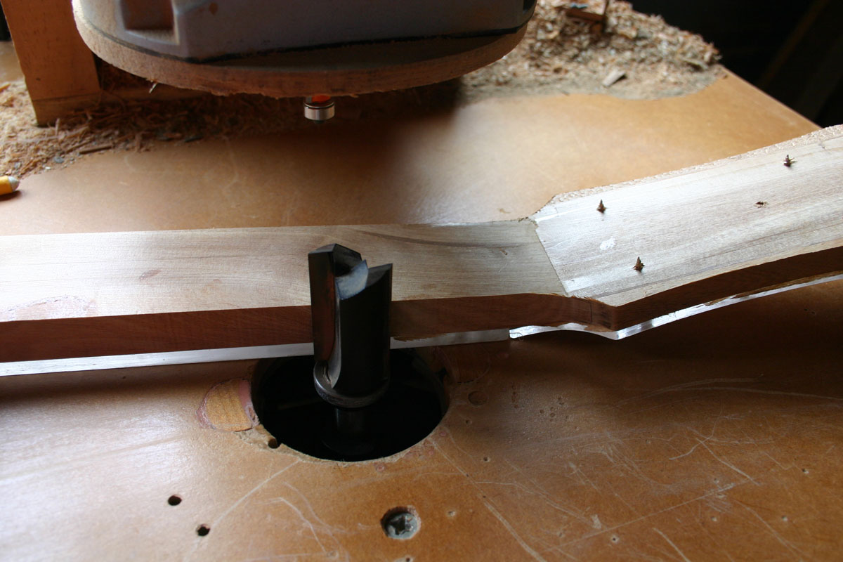

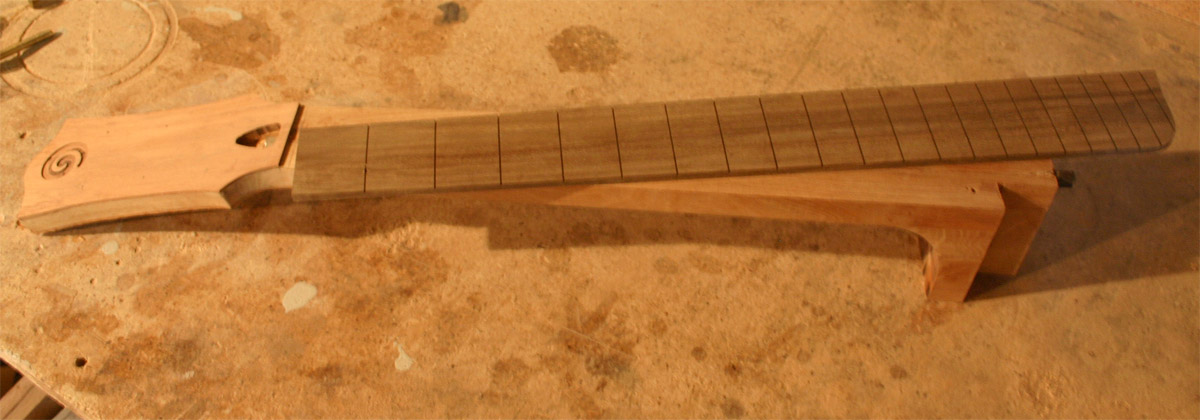

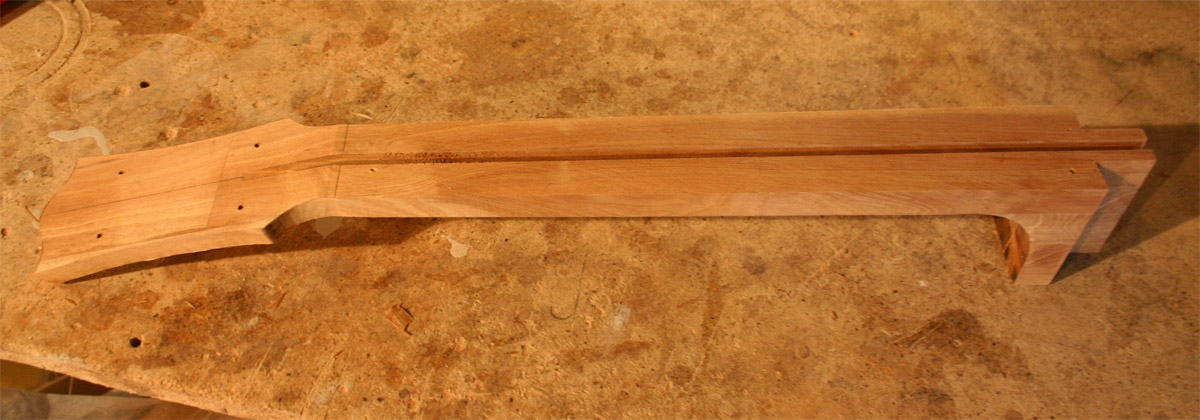

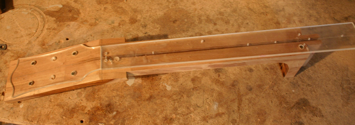

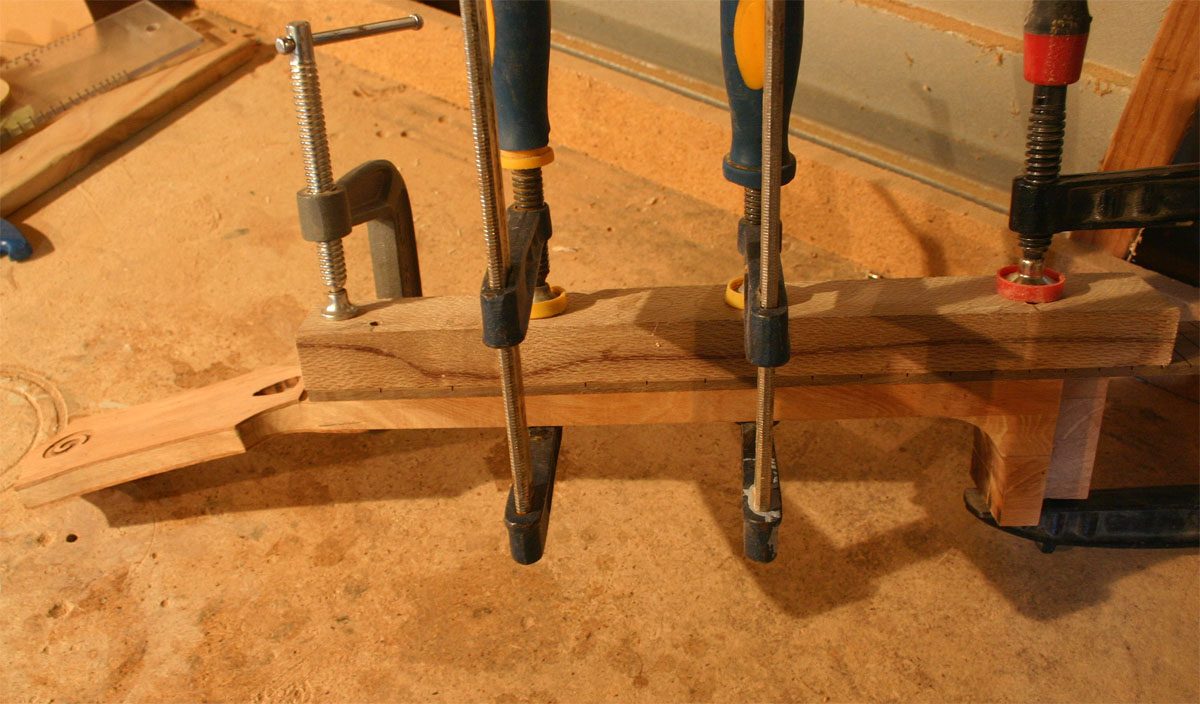

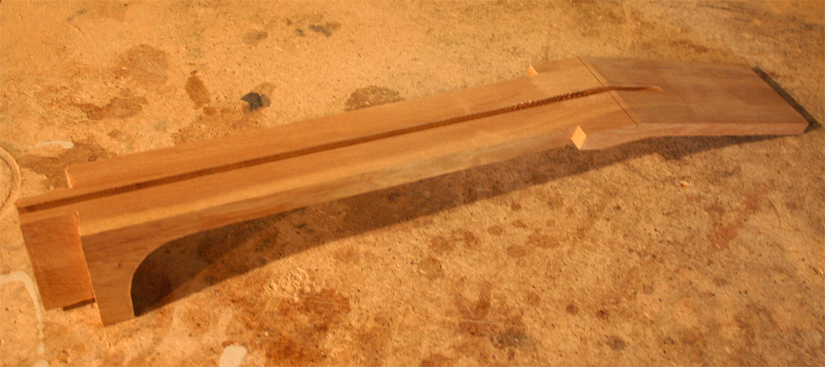

The next few pics are the shortened sequence of the Rimu neck construction and fitting.
Christian.
