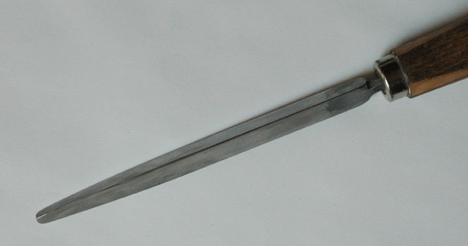

I also have one of those, but I never managed to like it.Nick wrote:Starting to sound like a scratched record here but a few (quite a few actually) years back I bought the StewMac version http://www.stewmac.com/shop/Tools/Scrap ... isher.html and am still using it,
Now I use this one:
When I bought this burnisher it looked like this...
...because when ordering it I naively had thought that it had not passed through the teeth cutting stage and that I only had to polish it to make it work. But it turned out to be just an ordinary triangular file with its teeth ground off - well, some of them were still present and it took me a fair amount of elbow grease to get rid of them and then polish the rounded edges. But now it works like a charm, the tight radius of the edges require much less effort to apply the necessary pressure on the scraper edge, normally it takes me one or two rather light strokes for each operation on each burr I make. It is now one of the best and most useful tools I have.

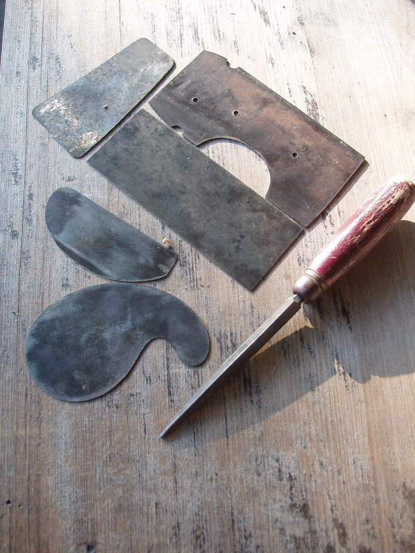

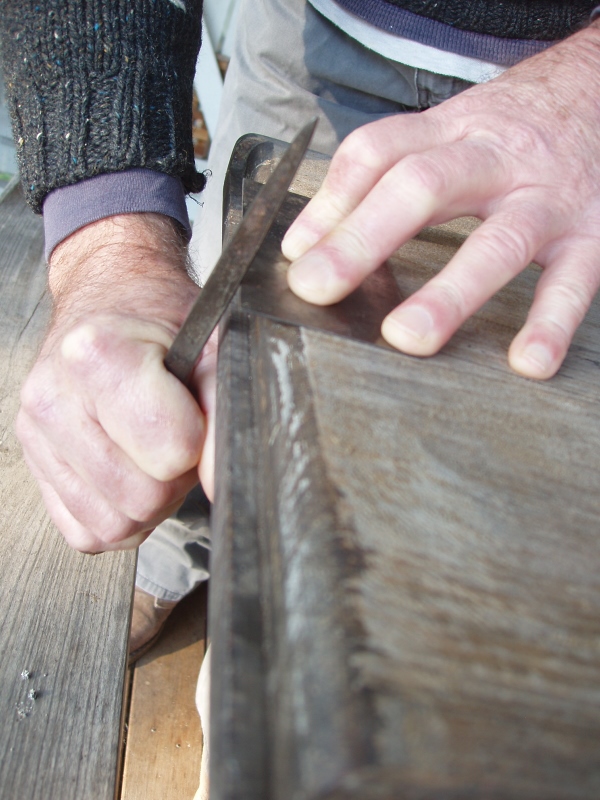

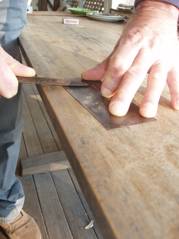

I use a tri- corner burnisher as well. For rough work I form a hook right off the file or sanding block. For fine work the scraper is honed square with no lingering dags. I don't hold the scraper in a vise. It's faster and easier for me to just hold scraper flat on a thin top, this allows my knuckles to get under the scraper. I try and avoid over burnishing to reduce metal fatigue. I can flatten the hook and reburnish 4-5 times before dressing again. The photos don't show it but my angle is 5-7 o.
The non vise allows for very fast re- forming of the hook as I work.
