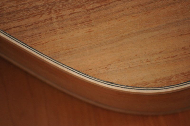

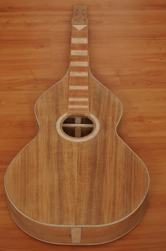

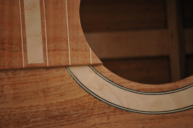

Here's a few pics :

To fix the gap in the bindings just borrow you missus's iron (she won't mind), heat the affected area and clamp (if possible) or re- tape it with LMI paper tape or similar or wrap it with rubber bands (I use the rubber binding strap from LMI and wrap the entire instrument after I have taped it)
Not too much you can do with the rosettes once they're in. In your situation the least noticeable solution may be to fill it with black seeing as though the purflings are black/white/black. You may however be better off leaving it and filling the gap with CA after you've sprayed the first few coats of laquer.

Mate. Drop fill them and forget them. No one besides you will ever even notice them.....

They certainly aren't too bad for your second effort. Don't be so hard on yourself.
Bob's advice is spot on. Then just move on trying to improve on the next. But don't think that you will ever get it spot on. You will start to be even more critical of your work. But thankfully, it's only you in most cases that ever see's the little blemishes that let's people know that a person built the instrument. And not extruded from some CNC machine.

Yes! Fold up a paper towel, wet it, apply to gappy area, apply the hot iron, and you will soften both the wood and the glue. You'll likely have to clamp it rather than tape it, depends how thick your bindings are. Work around until you've closed all the gaps.
As Bob said, there's not much you can do about the rosette.
