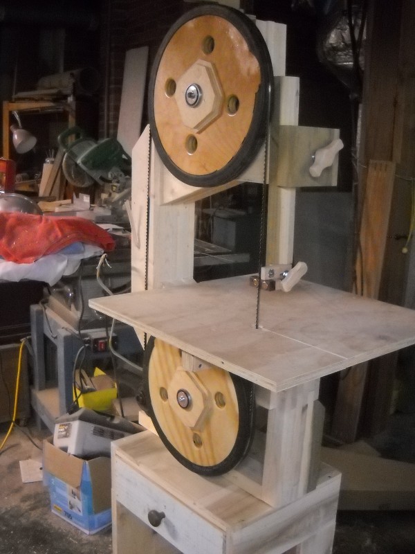

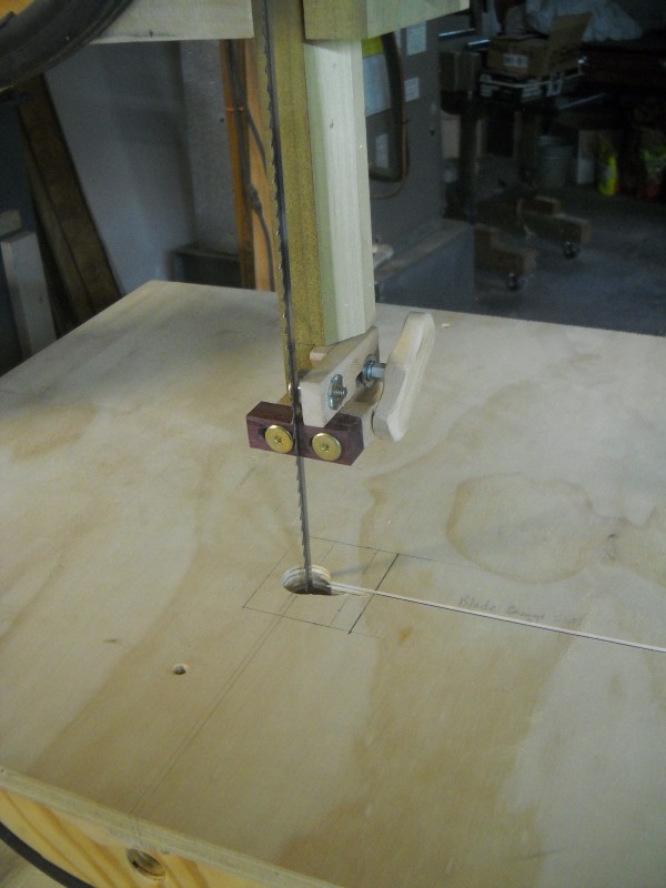

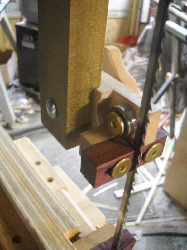

The best solution I've come up with is to make my own. I will try to add photos. I bought the plans from Matthias Wandel http://woodgears.ca/bandsaw/homemade.html
I altered mine to be set up primarily for re-sawing. I can re-saw up to 11.5" and it has a 15.5" throat. I am still working out the bugs. I have added blade guards since these photos were taken. Right now it has a 3/4 HP motor which isn't powerful enough. I am looking for an affordable 1 to 1.5 HP motor to replace it.

Impressive work, & welcome, Rusty.
Looks like we've got another 'charangohabsburg' in our mob.
