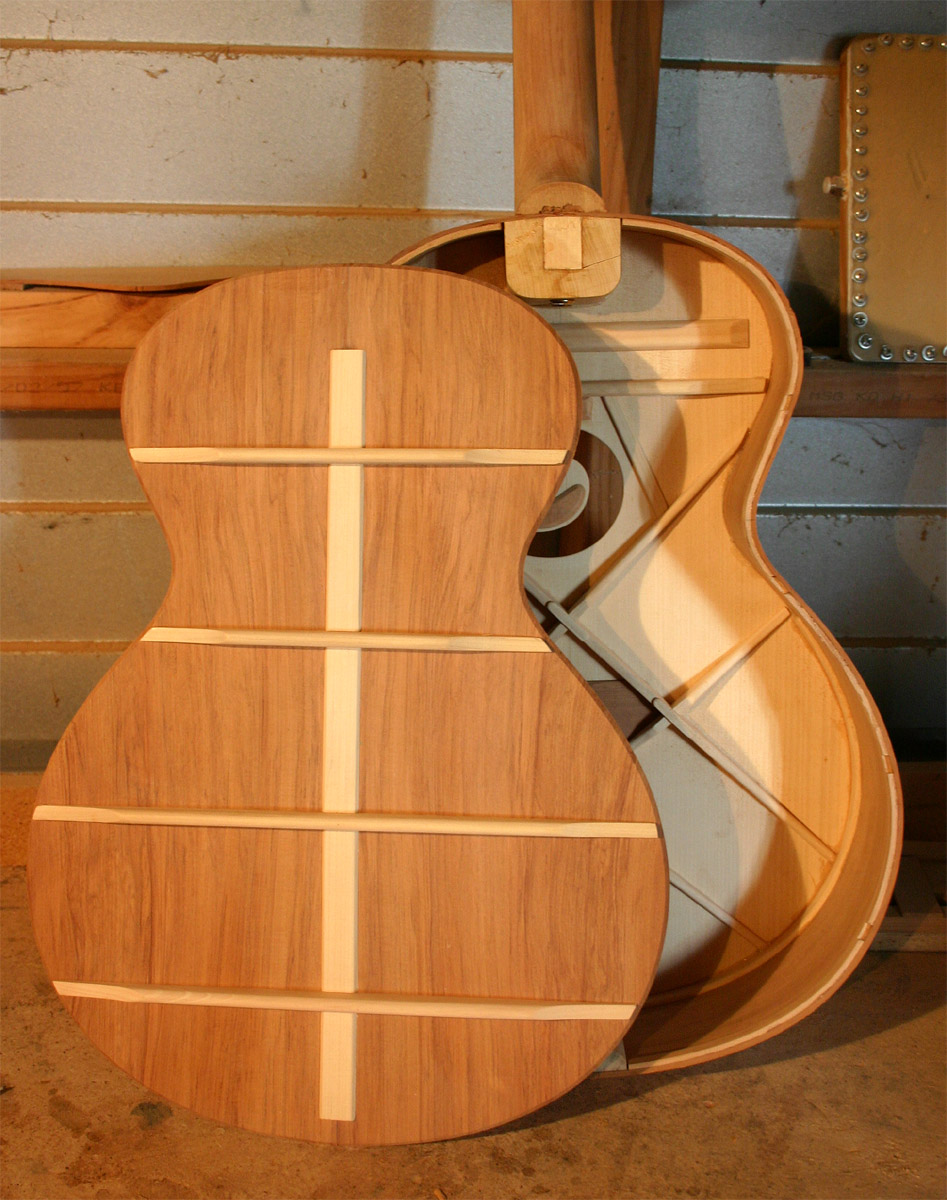

However, I have a question (and as I am only on acoustic build No. 1 myself, possibly a naive question) - your top braces look quite 'heavy' compared to those I have seen elsewhere. Is that a particular design feature, or am I noticing something that isnt there?

Thanks for your comments,the braces start off pre shaped for the vacuum gluing, but they do get shaved down a little once I glue the top to the sides.

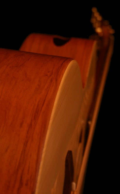

Hi Christian,

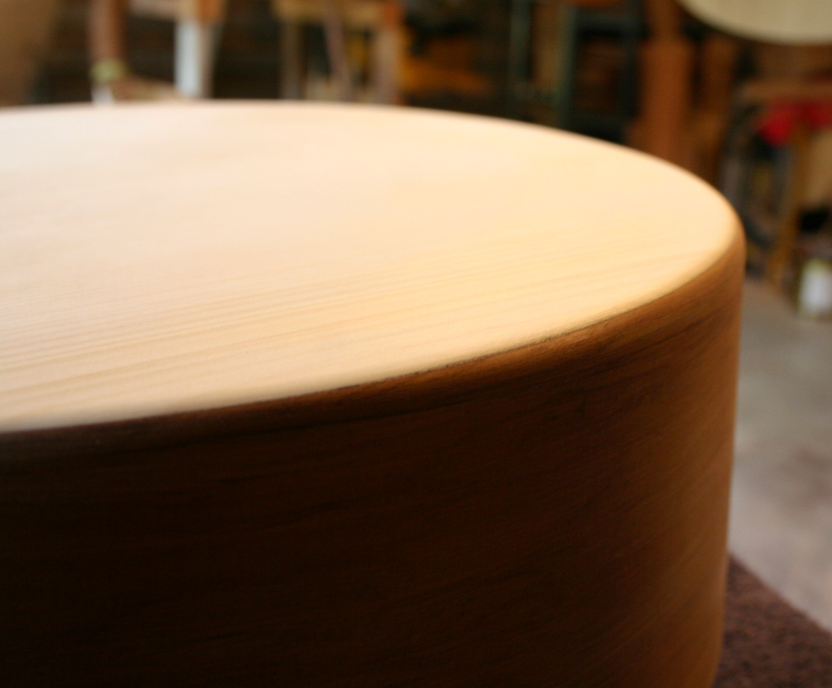

Really enjoying watching this build come together. Like you work very much and have wondered how the heck you manage the clean look of the mitred edges. You'd need everything to come together spot on in terms of symmetry etc. Now having seen the build images to date - I'm still gobsmacked you pull it off
There can't be much leeway for error in cutting the mitre before bending then getting it all to line up.
Keep it coming, it's like trying to work out a magic trick
Kevin
Kevin
- christian
- Posts: 338
- Location: Bay of Islands NZ
Re: Build Thread: 000 Koru kahikatea/Heart Rimu.

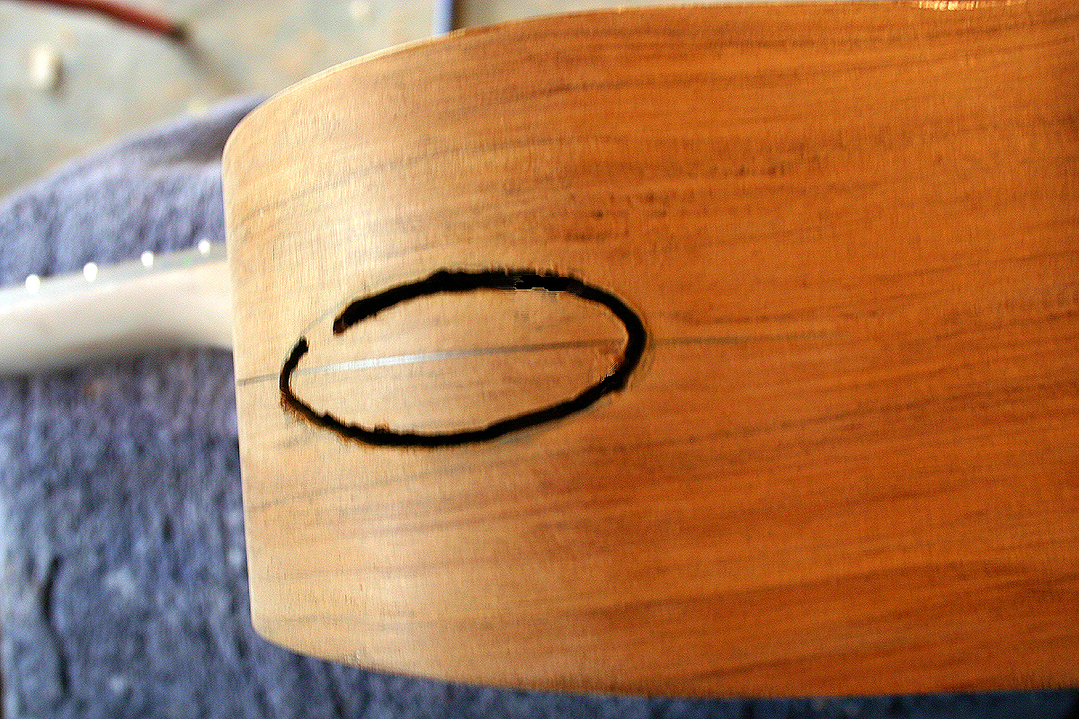

Hi Kevin,
Thanks for the praise!!
I can assure you there are no smoke and mirrors here.
Perfect templates make it reasonably straight forward, the mitre bit simply follows it.
Making sure that waist curve is marked and bent it in the right place is kinda crucial, but it is for a normal build anyway.
let me know if there is something obvious I have left out.

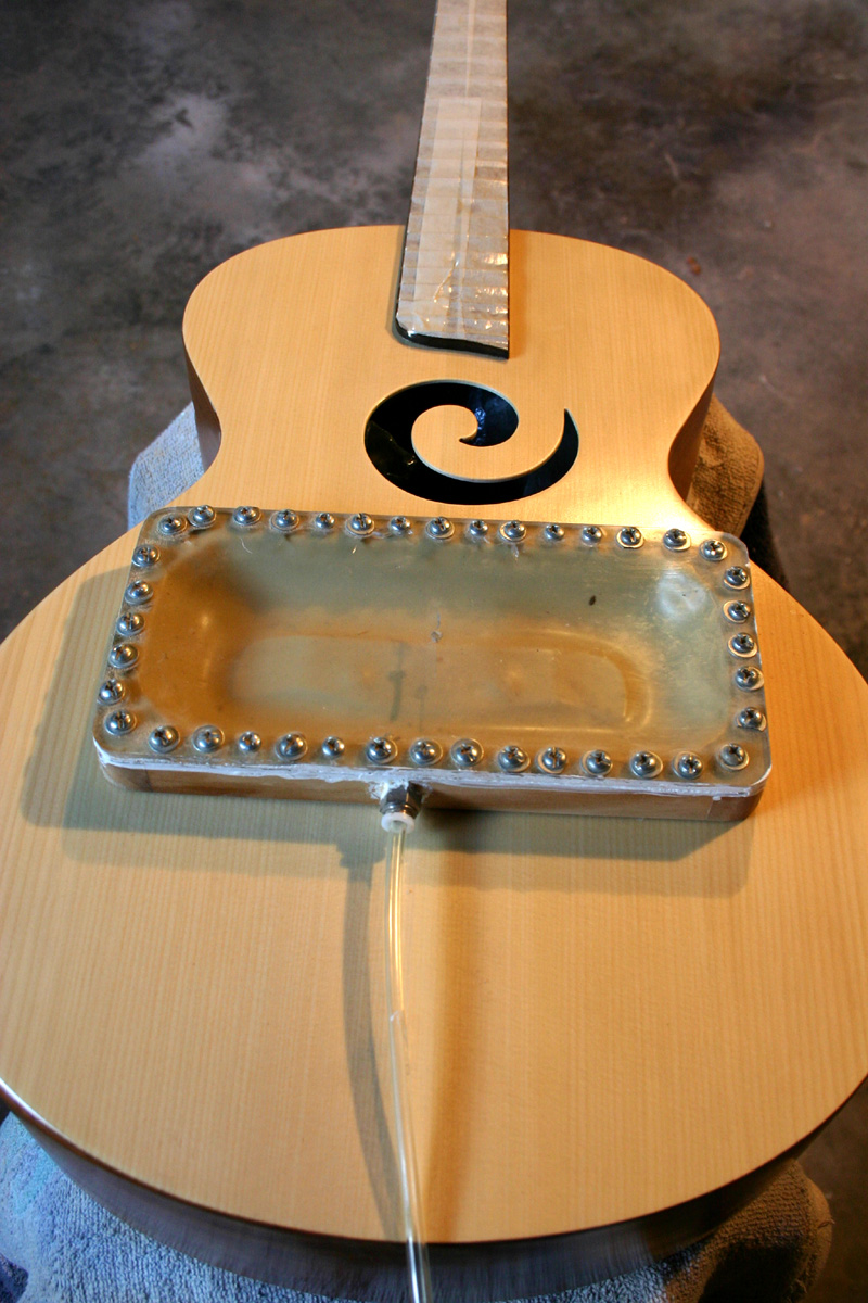

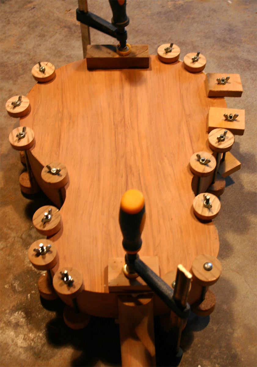

more pics below.
Christian.
more pics below.
Christian.

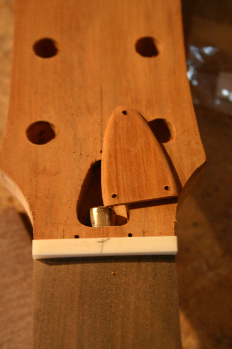

Hey Christian, looking good, and thanks for posting.

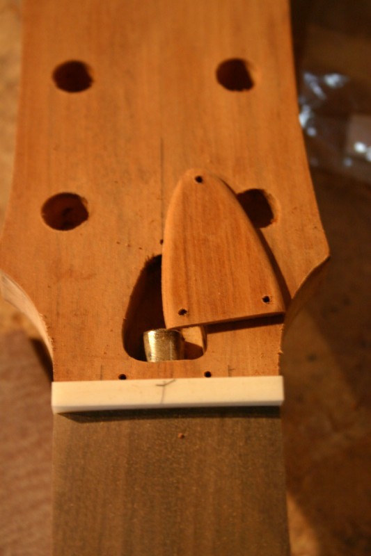

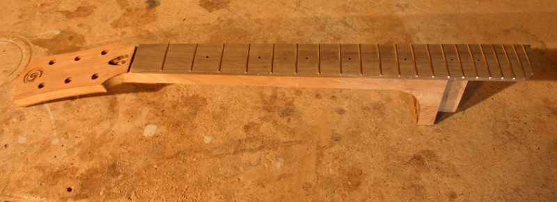

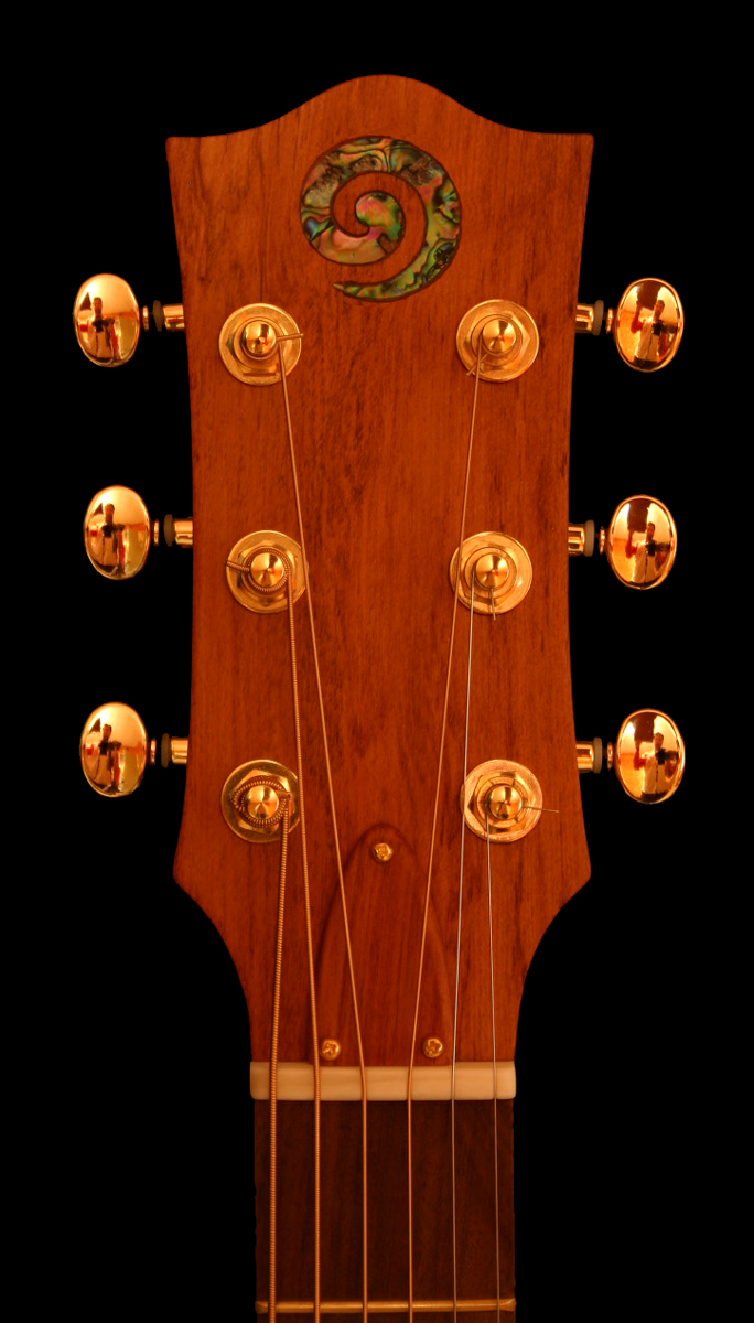

Especially interested in your neck process. Notice you shape the head before gluing the overlay.
Not clear how you kept that in register while the glue set. Pins from the back side?
Thanks,
Thanks,
- christian
- Posts: 338
Hi Steve
Yip the head veneer is aligned by the 4 holes(tuner placement) made when I routed the head shape, it's just tacked enough to stop it slipping around.
Christian.
Christian.

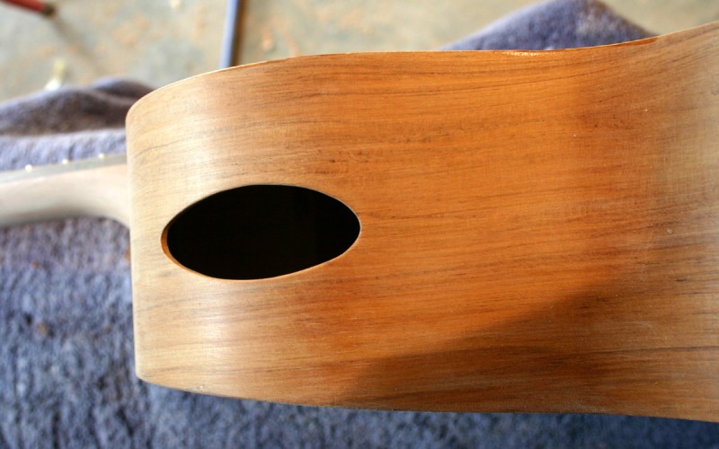

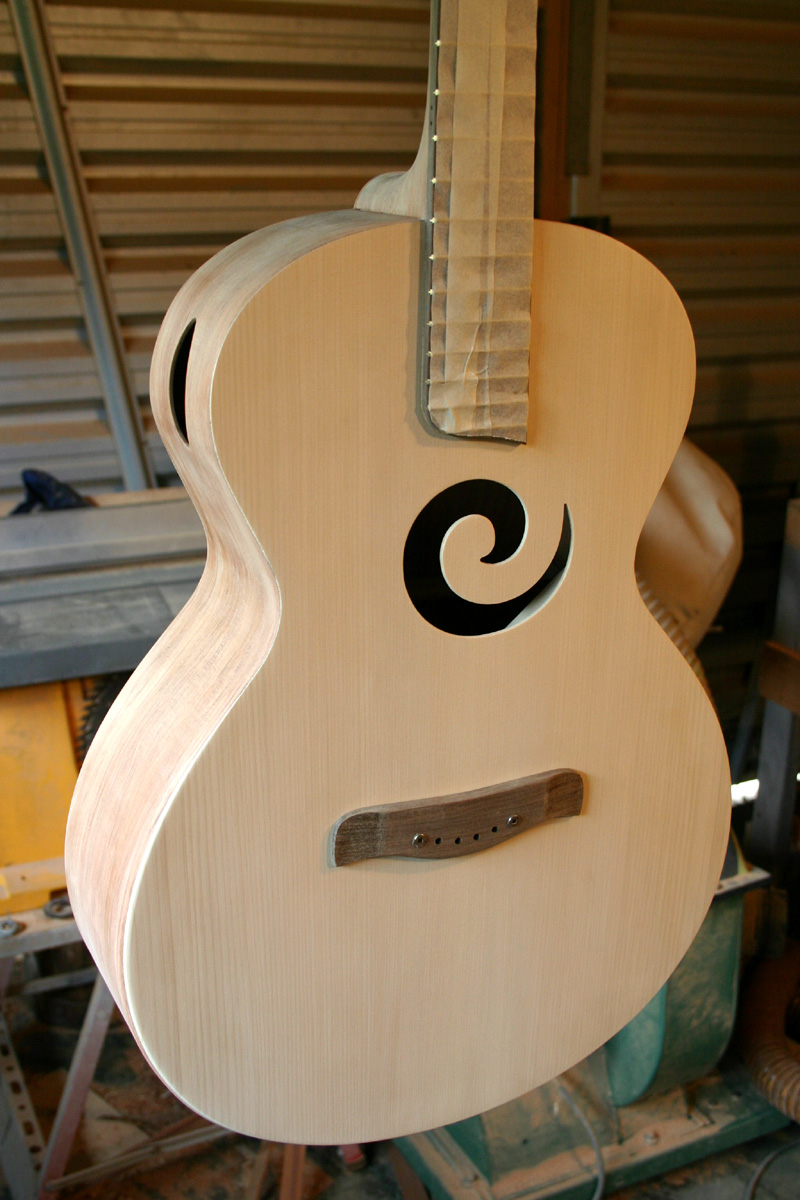

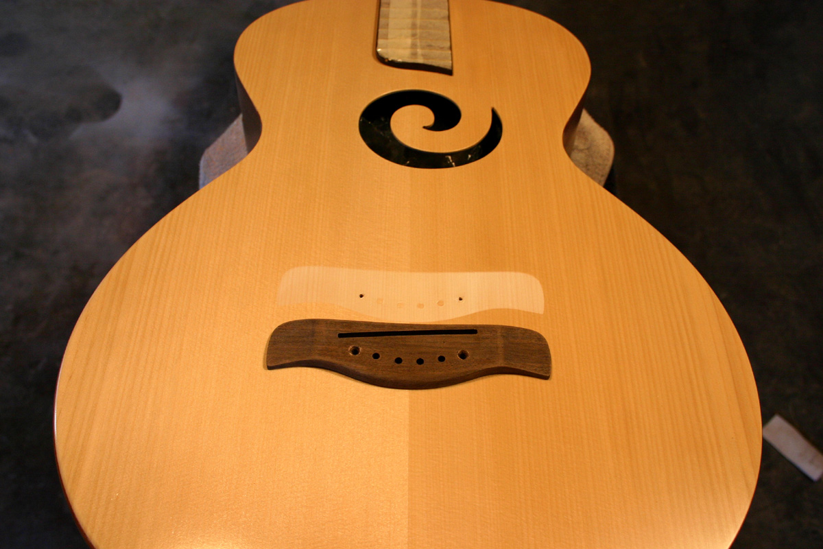

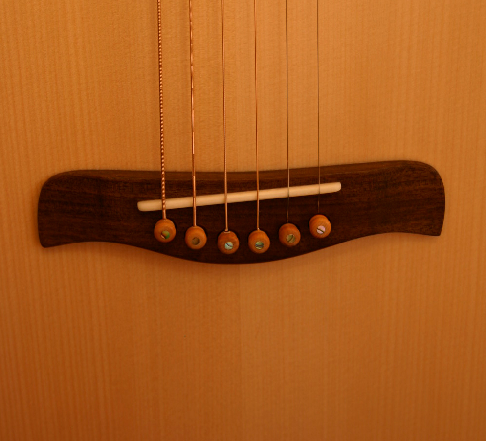

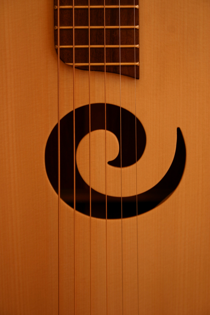

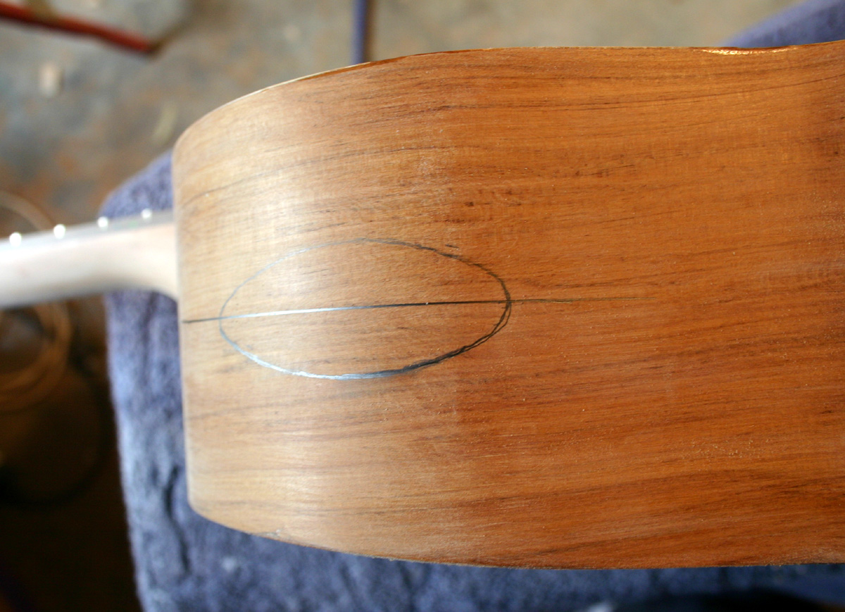

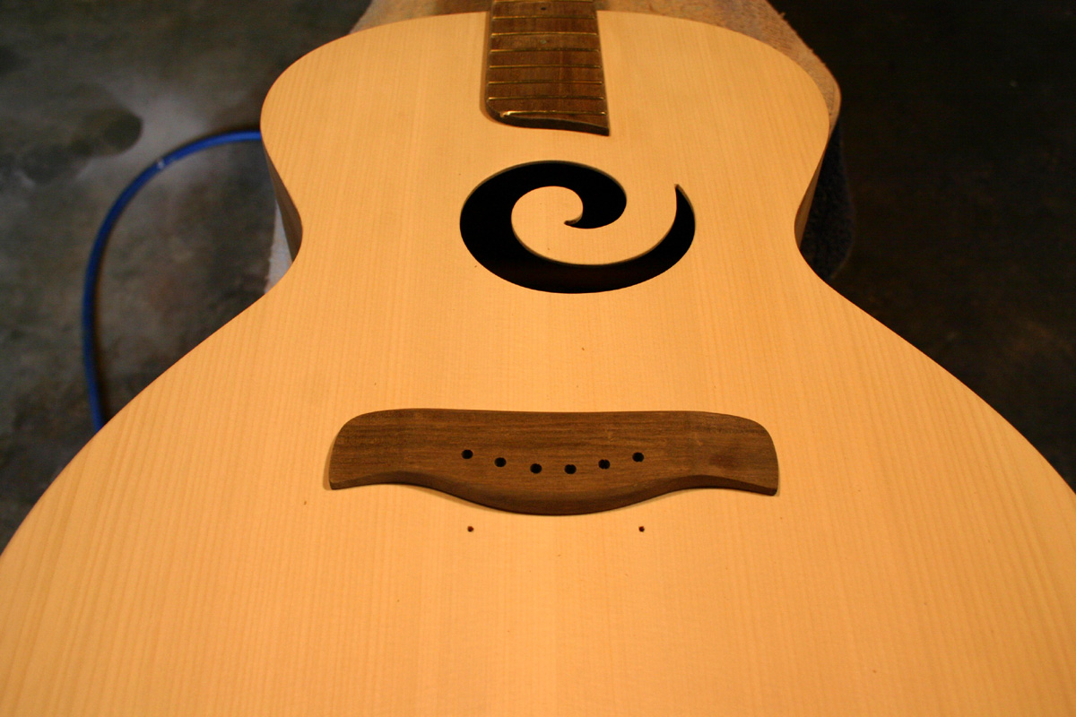

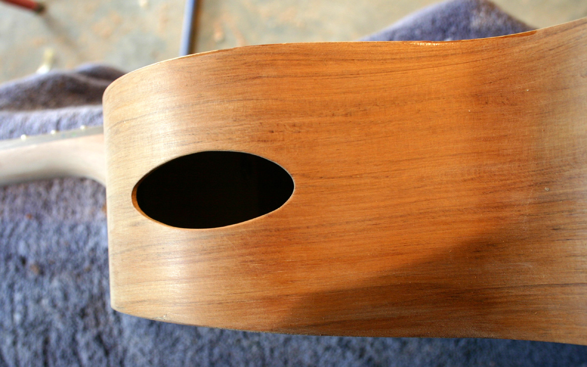

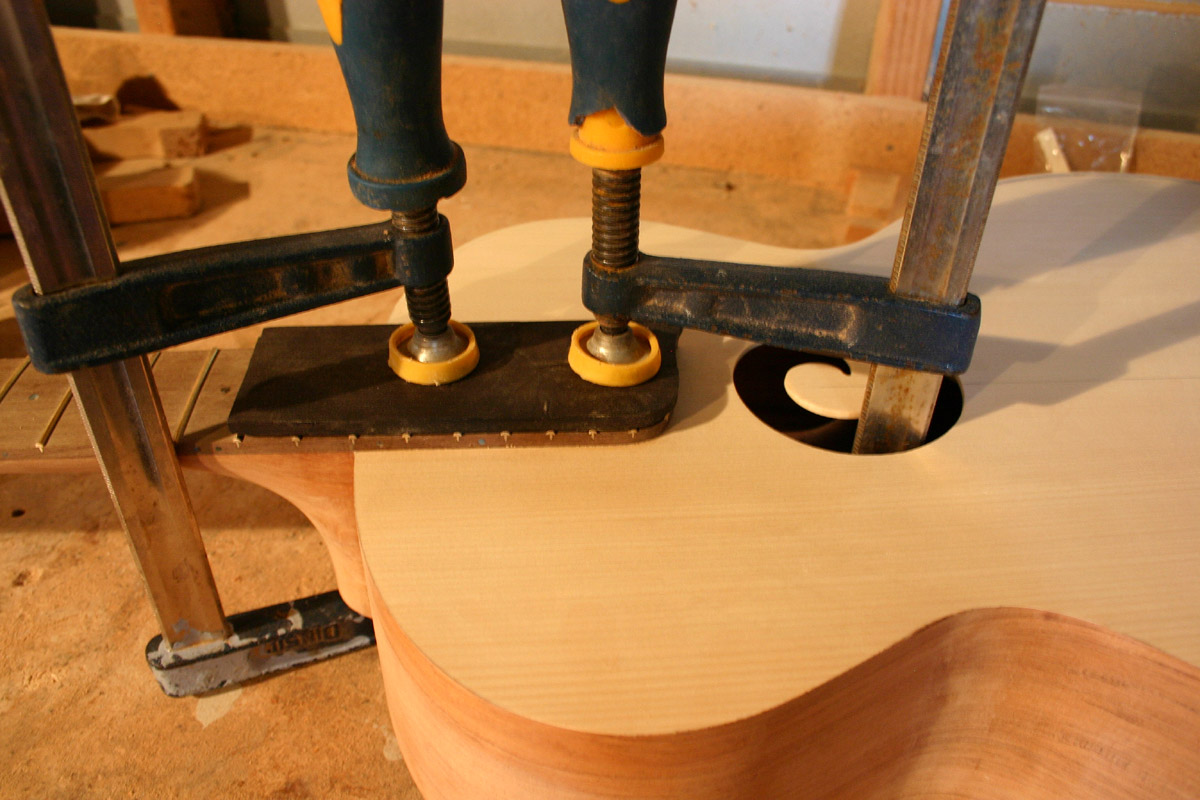

And the last few steps cutting the soundport, sanding in the armrest and aligning the bridge
Finally at the the fun part finishing!!
Christian.
Christian.

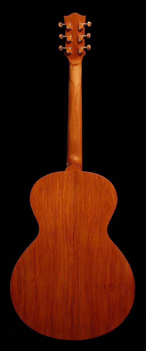

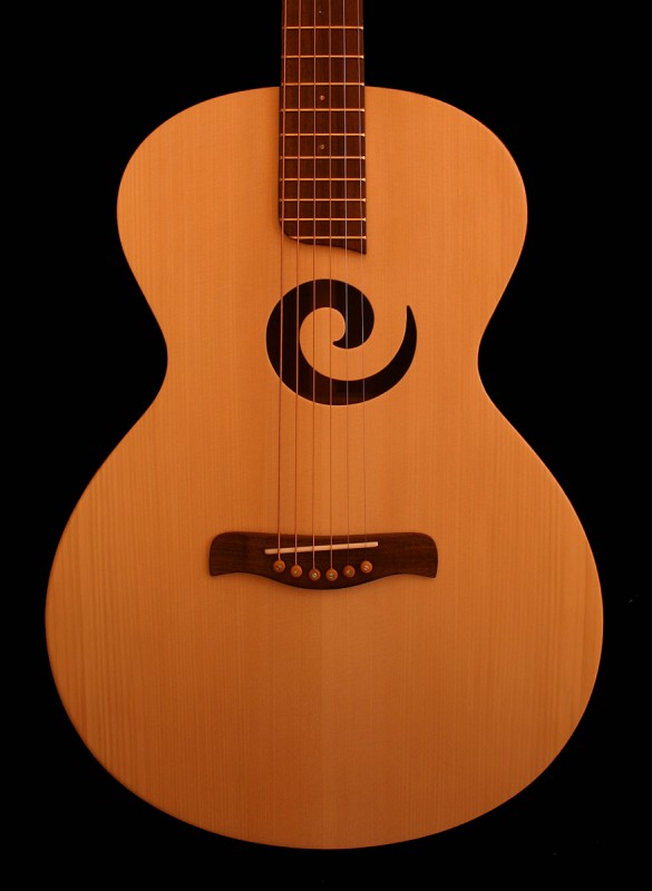

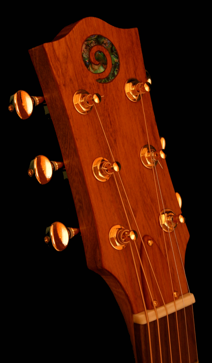

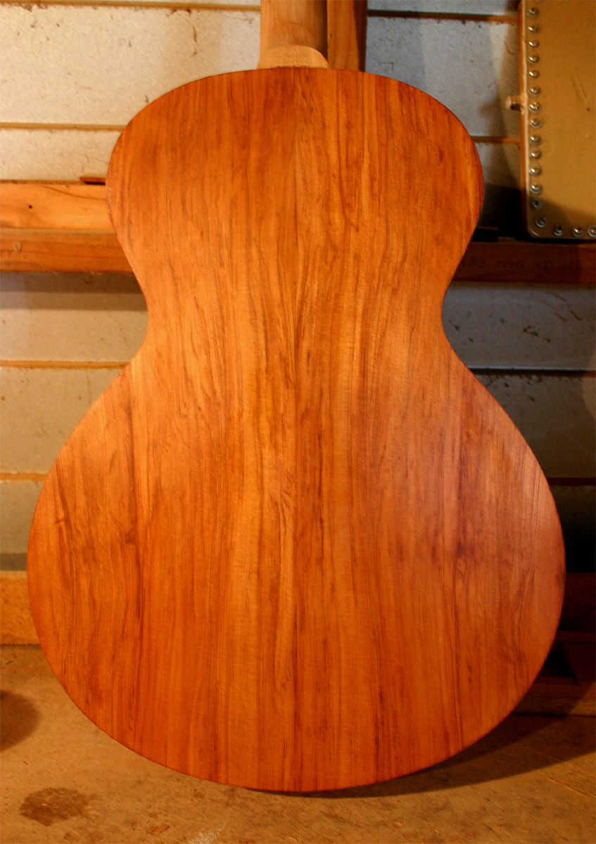

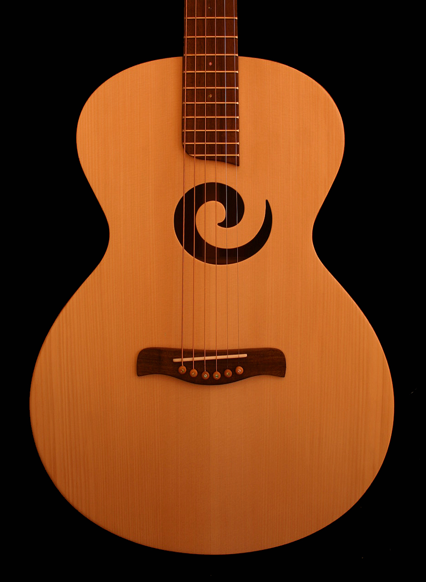

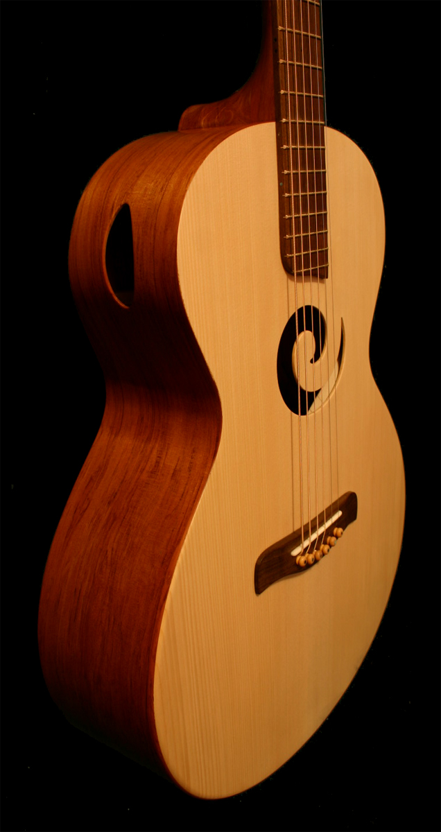

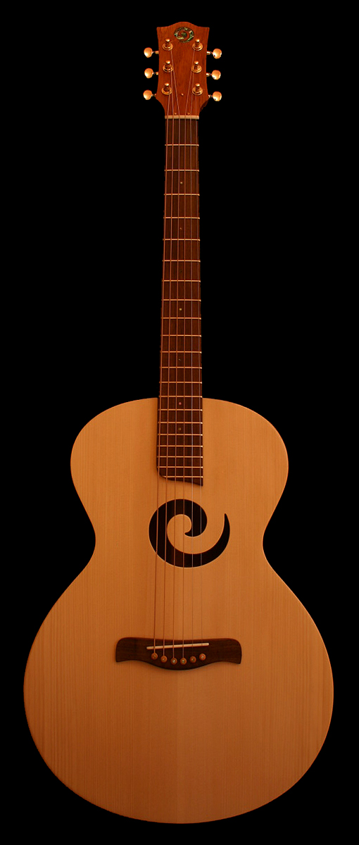

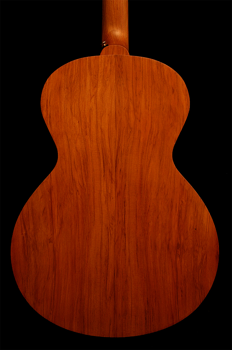

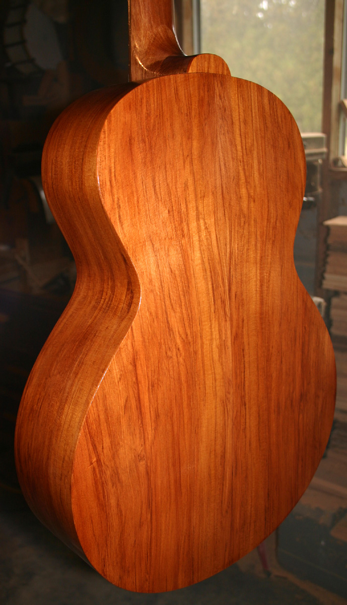

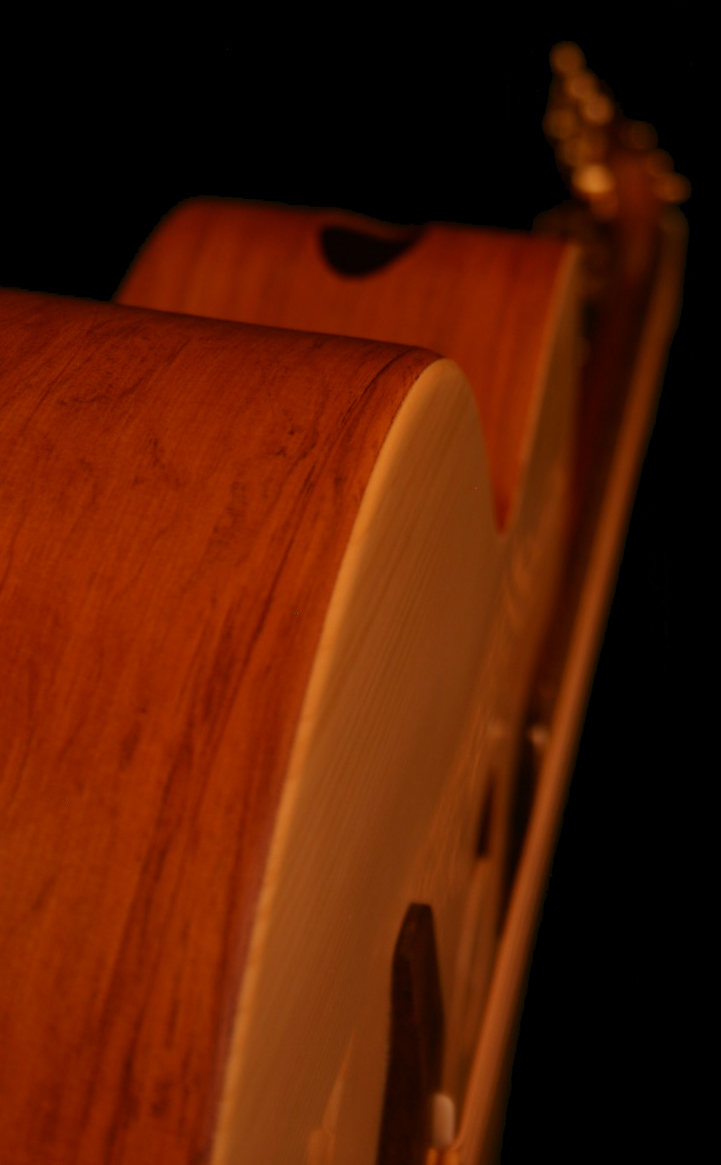

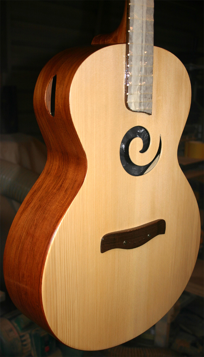

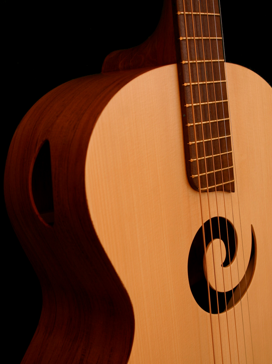

It's finished!!!!
I've uploaded quite a few photos to finish the build. The Koru has a really bright punchy and loud tone.
Christian.
Christian.
